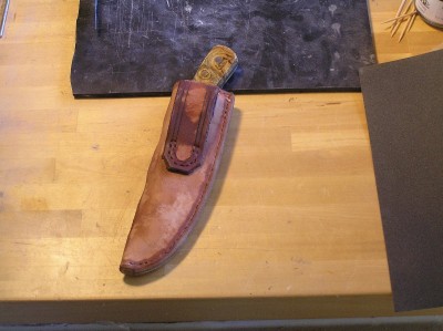

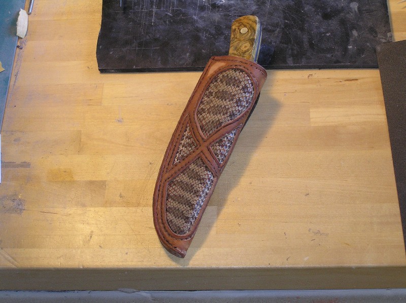

Here is a leather sheath I made for a skinner I made, I bought the blade and made everything else. Sheath is 100% hand made and hand stitched.
Man, I gotta get a machine if I keep this up. ::doh::
But this one is hand stitched with 5 strand flax except the inlay which is hand stitched with 3 strand. The snake inlay is prairie rattler and uses 2 layers of 4-5 oz leather and a 7-8 oz welt and belt strap. All flax thread has been treated with 40% pine picth and 60% beeswax. The pine pitch acts as an anti-fungal and the beeswax will help as it acts as a lube when stitching. This is 100% harness stitched.
This is one of my own designs and only the second inlay I have done. I can see where I need to improve.
The handle is of stabilized Buckeye Burl by WSSI. Buckeye can't be used for handles unless it's been stabilized.
This sheath has been just been cased/deglazed and is still drying out. The knife is wrapped in plastic to protect the knife. This is so the sheath will dry out and form fit to the knife.
I will post another picture when I dye and finish it tommorow.
