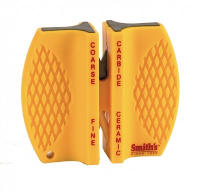

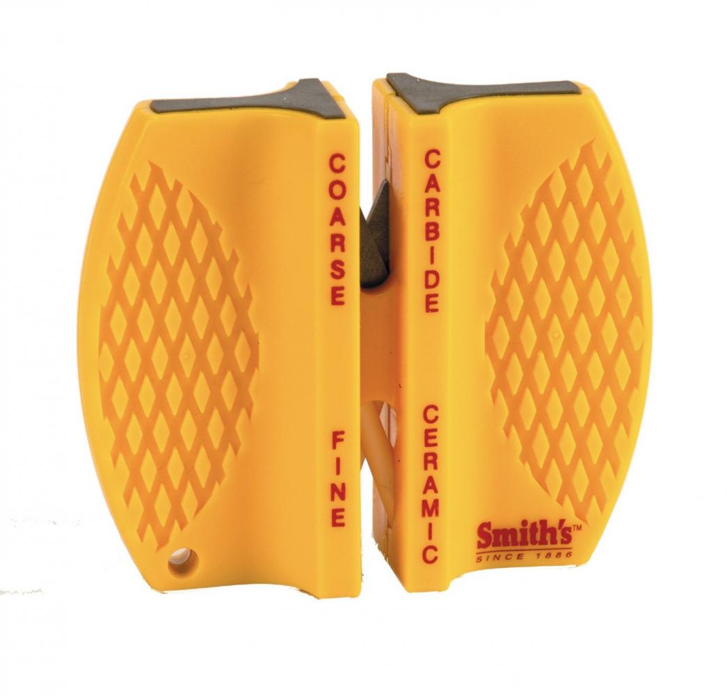

I'm not exactly sure what type of sharpener you're asking about. If it's one of the electric knife sharpeners, never, never, ever use one on a good knife. I've seen countless knife blades that have been ruined by them.
If, on the other hand you're talking about one of these sharpeners shown below, they're pretty harmless and actually do a pretty fair job of touching up a blade if it's not too dull.
Phil

philco wrote:I'm not exactly sure what type of sharpener you're asking about. If it's one of the electric knife sharpeners, never, never, ever use one on a good knife. I've seen countless knife blades that have been ruined by them.

I use a Smith's like Phil posted the picture of, sometimes on an already fairly sharp knife. I ONLY USE the Ceramic side.
I only use it on kitchen knives etc. I would never drag a good folder or fixed blade through the thing

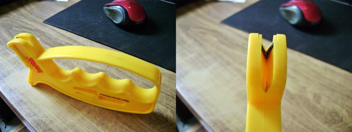

I have a couple of the Lansky pull-throughs. I bought the blade medic because of the diamond tapered rod for serrated blades.
You'll be glad to hear that I don't use the pull-throughs to sharpen good knives. I basically only use them for knives with a bad edge, kind of for reprofiling the edge. Once I get a good working edge on the blade, I switch to ceramic rods. So I do think the pull-throughs can serve a purpose in rare cases. I definitely wouldn't recommend using them for regular sharpening purposes.
But if it's a cheap knife that you bought at Walmart, go nuts! You can always buy another one.

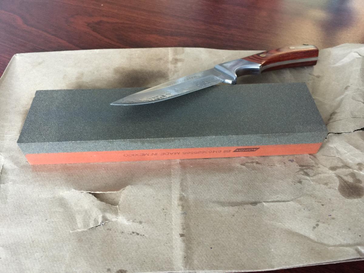

You know what, I think I'd like to change my opinion. My buddy brought me a cheap knife from his tackle box. It was in pretty good shape, except for the nicks in the blade's edge. I have an India stone that I've been meaning to start using. So I put the stone to work. I'm not an expert by any means. I have very little experience sharpening "freehand." But the stone did such a good job on this knife! I'm really impressed. Now I'm thinking pull-through sharpeners are completely useless.

I use the Smith one's like Phil showed for some touch up.
