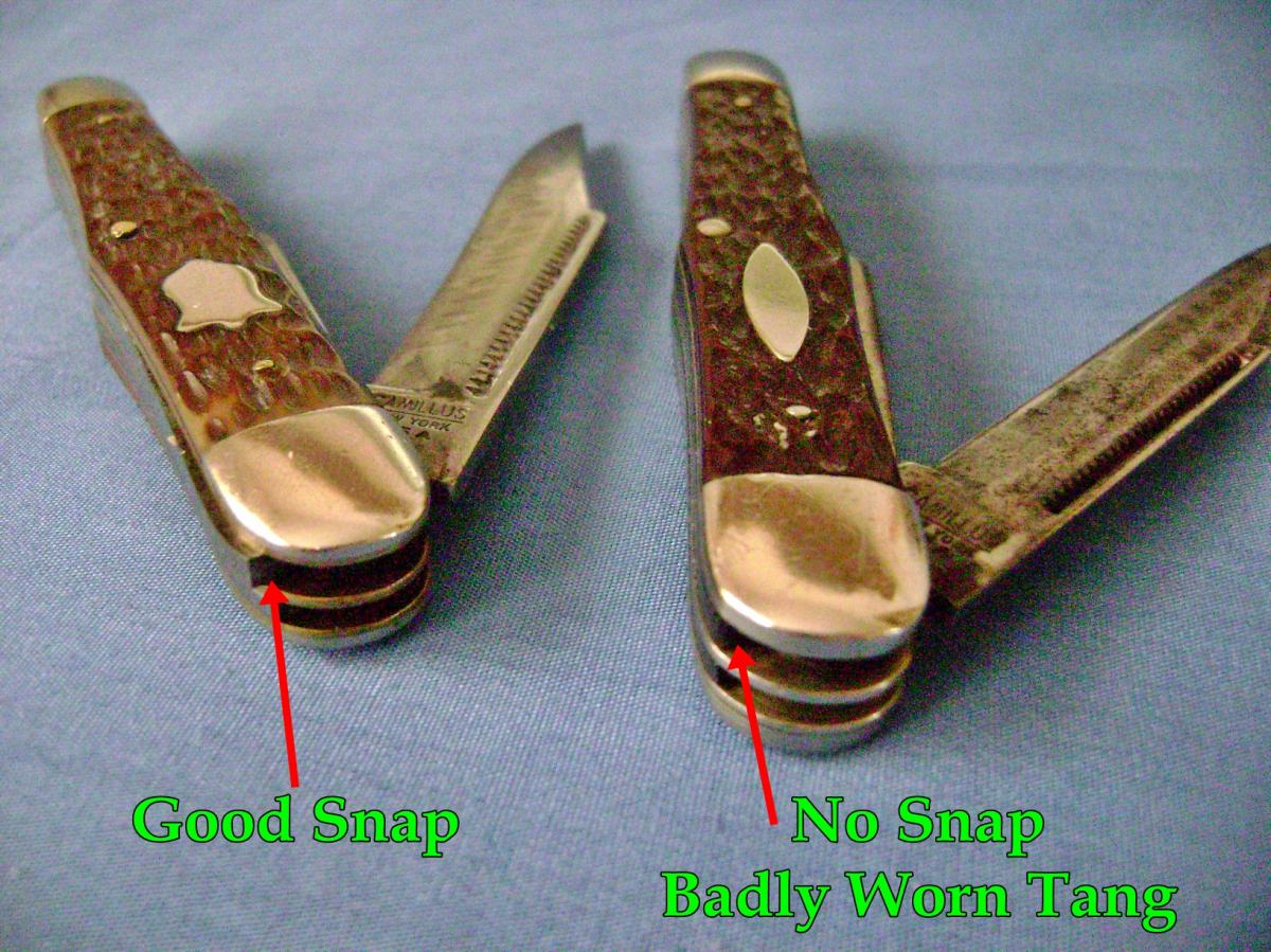

I'm sure I have a picture around here someplace showing a worn tang but I can't seem to find it. I did however find the comparison of the rise of the back spring on a knife with good snap and the lack of backspring rise on a knife with no snap. (see below - click on picture twice for full size)
Keep an eye out when cruisin' eBay. Occasionally the sellers picture will be taken with the blades half open and at an angle where you can see how much rise the back spring has. A knife with good rise but poor snap is usually easily fixed with a little cleaning and a few drops of oil.
If the backspring has plenty of rise, Scotts method should work.
If there is NO or very small rise on the backspring then what Josh (junebug) said, applies.

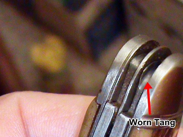

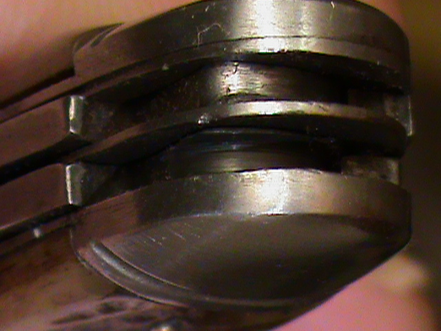

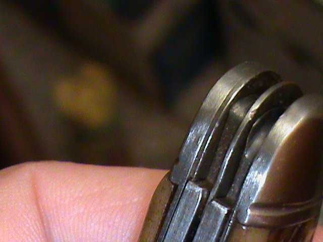

Here's a worn tang. Easy to see that the spring steel is a LOT harder than the tang steel. Jerry, if you want to add your little arrows to highlight the area, please feel free ::tu::

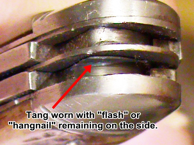

On TJ's knife, not only is the worn tang a problem, but the hangnail left behind really fouls things up. Welding is an option, but usually not very cost effective.

T.J. those two pictures do a splendid job of showing a worn tang.

It would also appear that the thickness of the spring is less than the thickness of the tang.

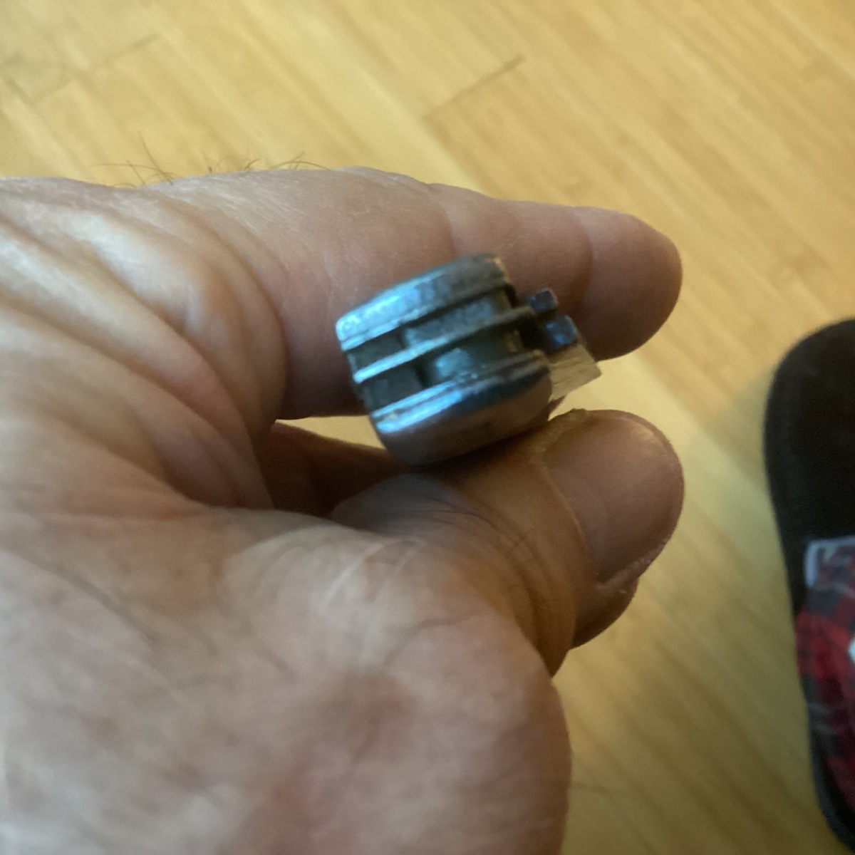

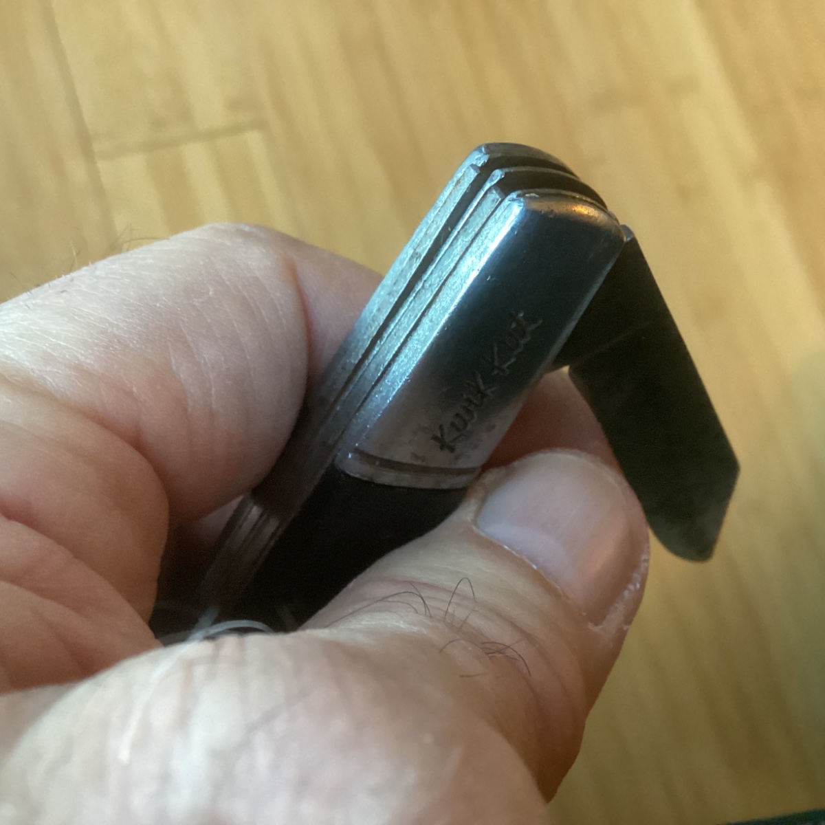

This is one of the reasons I love AAPK. I was searching the Internet to see if there was any “fix” to a Kwik Kut Barlow I got. Small blade has a little snap. The main blade has exactly “zero” snap. I found this 10 year old thread, and now I’ve learned something new - the fine people here have described my problem perfectly. Notice the difference in the tangs in the top photo? One is pretty squared off as it should be. The one on the bottom is rounded off and totally different than the tang on top. Also,look at the two springs in the other photo. Both blades are in the same position, yet the spring on the right hasn’t been pushed out at all - just like jerry and tjmurphy described above! Now it’s very clear why all my cleaning and oiling didn’t help.
Tim

Thanks, Reverand. Really don’t believe this knife would have enough value to warrant that kind of time, effort and investment.
Tim
