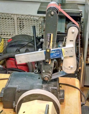

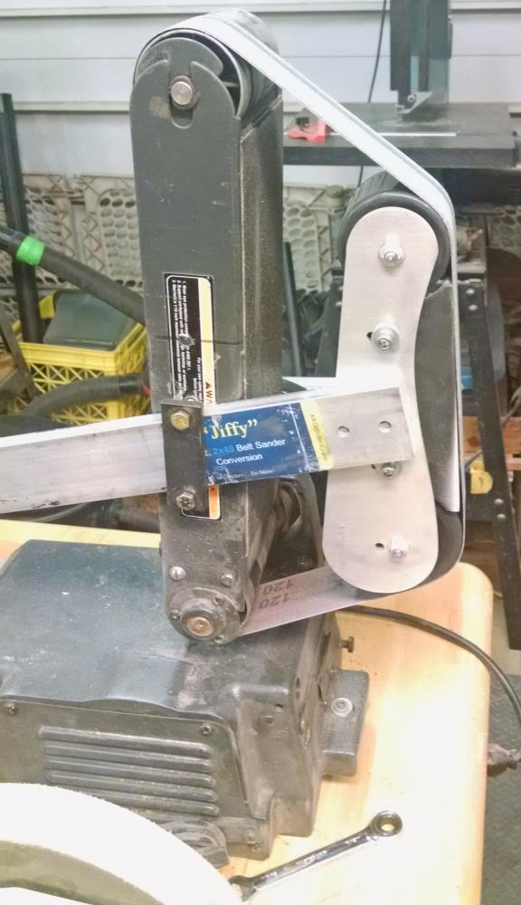

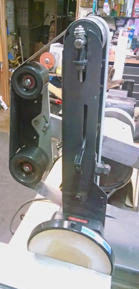

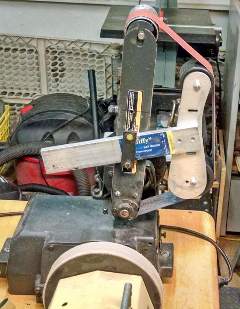

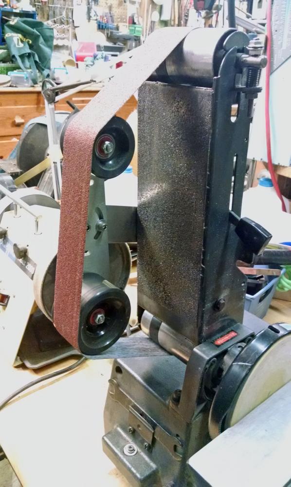

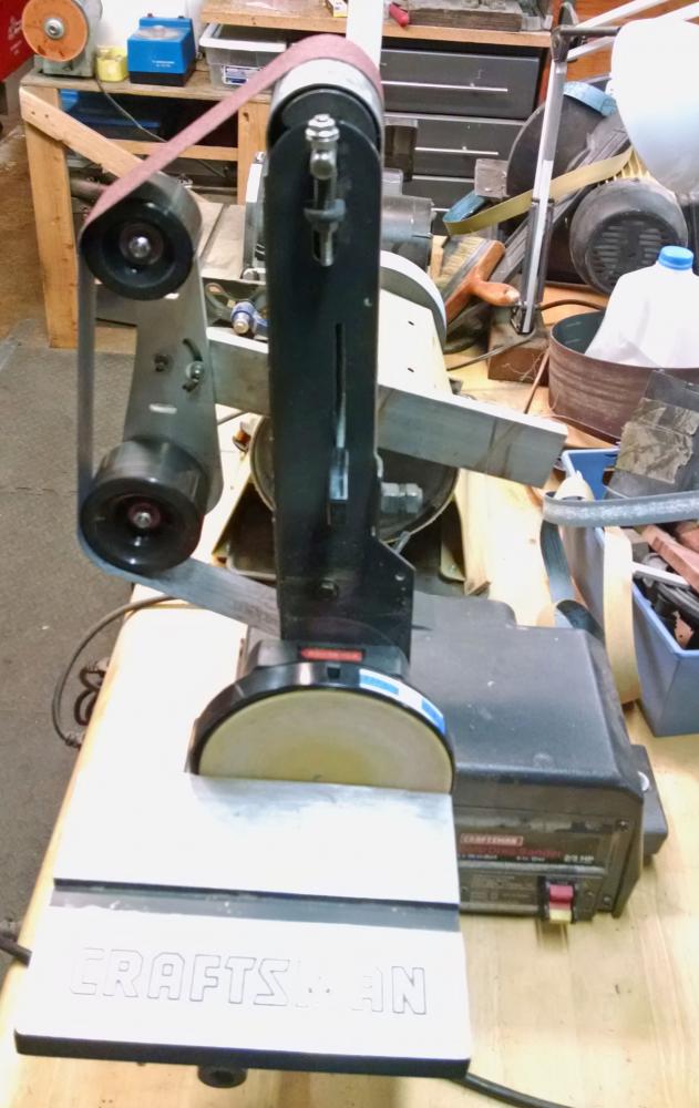

There are some pictures of the Jiffy set up in my shop on my old 4 x 36 Craftsman belt sander.
In these pictures I had it set up for slack belt grinding. Note the platen is not behind the belt between the two wheels.
In these last two pictures I have reinstalled the platen.
