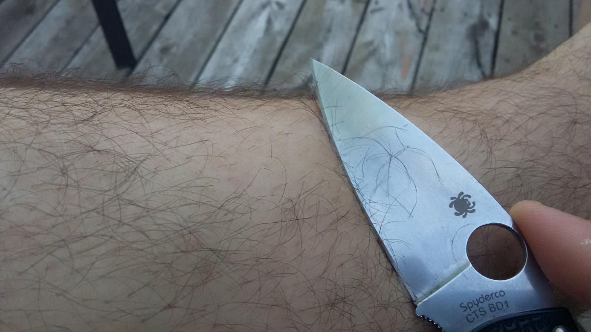

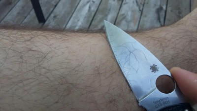

- 313 Mike
- Posts: 3774
- Joined: Tue Sep 13, 2011 1:59 am
Re: trouble sharpening CTS BD1
......at long last....mission accomplished! [ broke down and bought a Lansky 5 stone system]...
