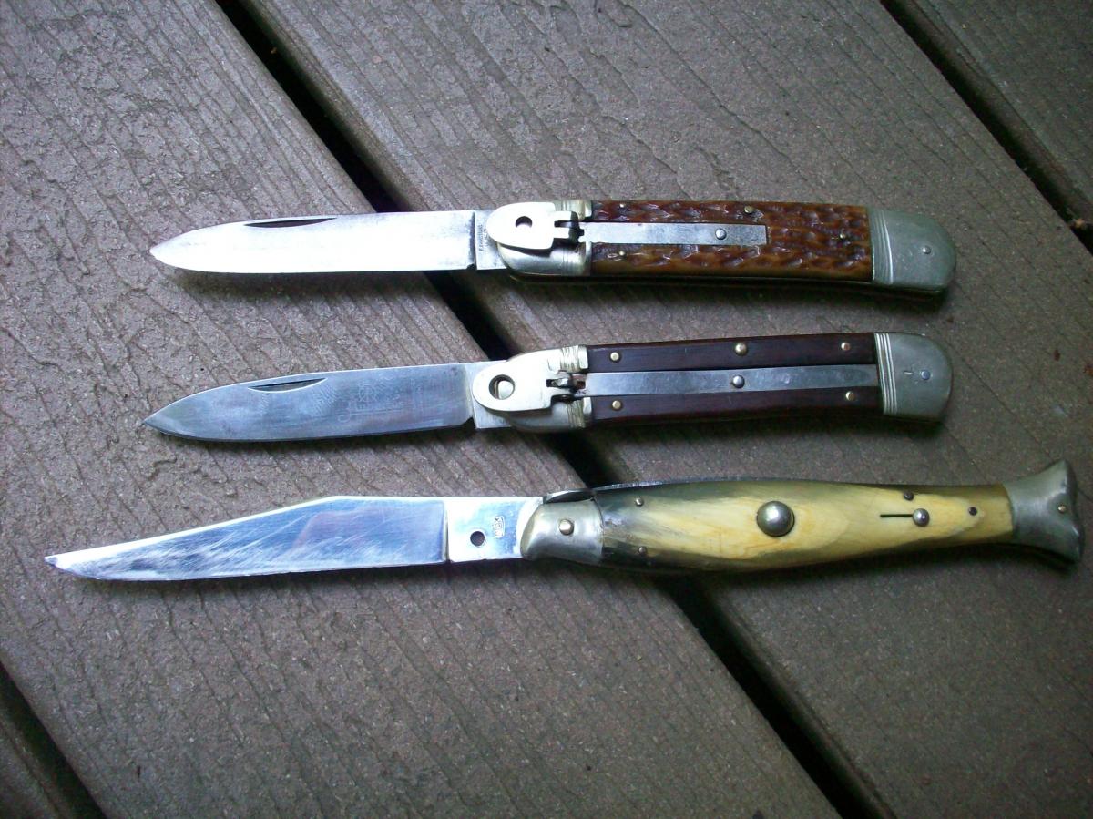

Re: Lubricating an auto
Pictures of my "lubricated" autos. Wood one I just bought marked Hubertus, bone marked E. Christians, and horn fishtail marked B.V.& F.
