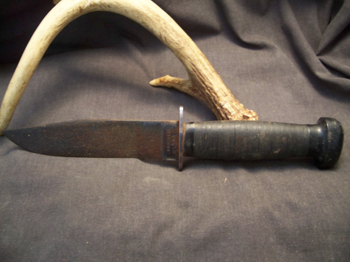

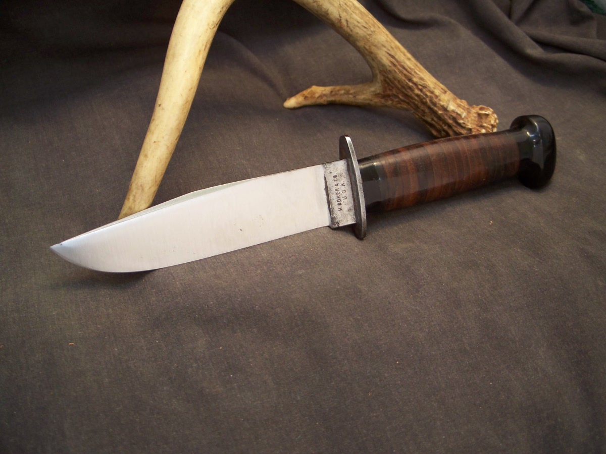

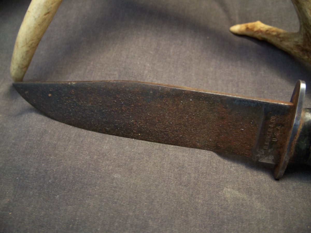

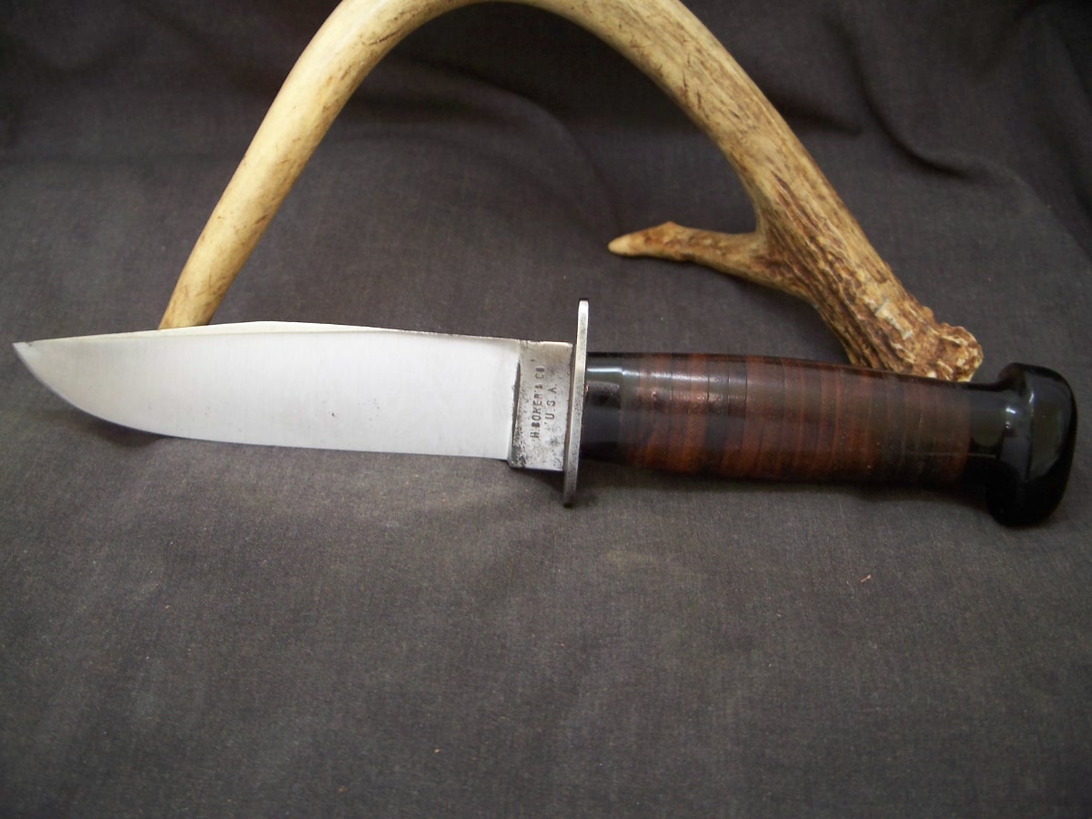

Boker Combat knife b4 & after
Well, it's been a bit slow here lately so I thought I would throw in a little restoration project I done on an H. Boker combat knife I picked up recently. As you can see, every metal part on the knife was caked in rust. Unbelieveably the handle was fairly well, still tight and not beat up too bad, but the bakelite buttcap was kinda battered. I got all the pits out but two small ones; so I gave it a fine brushed finish instead of the usual polish, had to leave some of the nasties on the tang, wanted to keep the markings sharp, and refinished the leather and buttcap.
