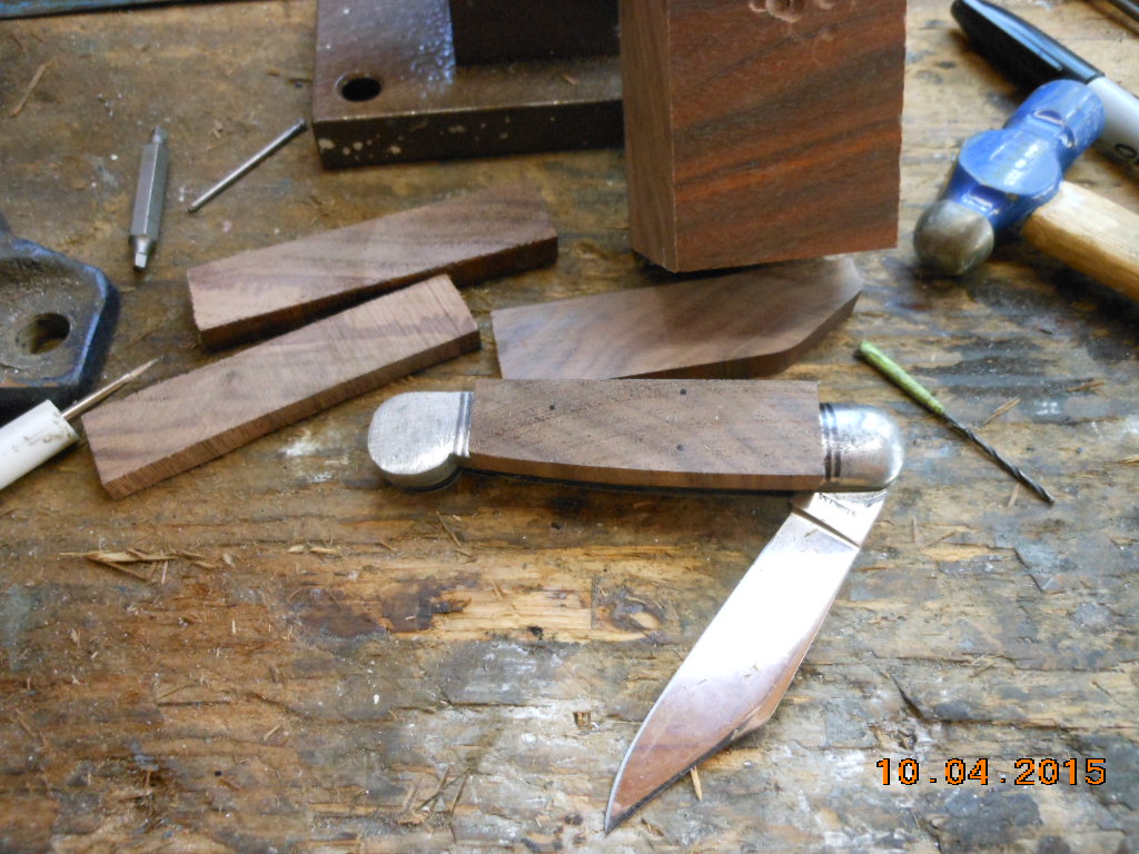

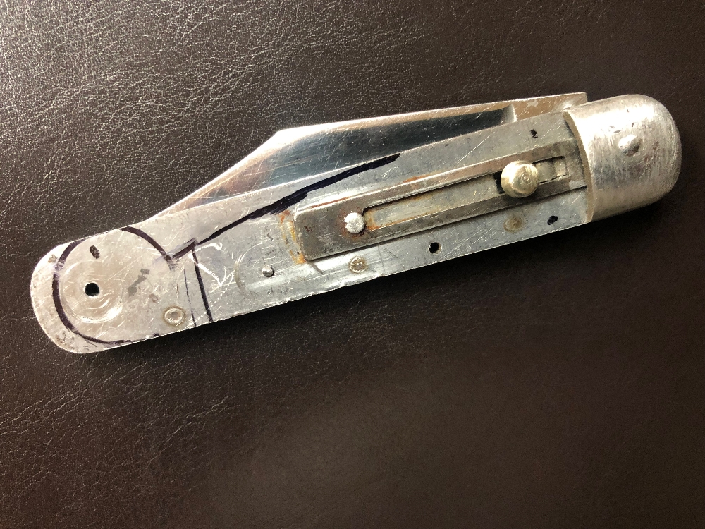

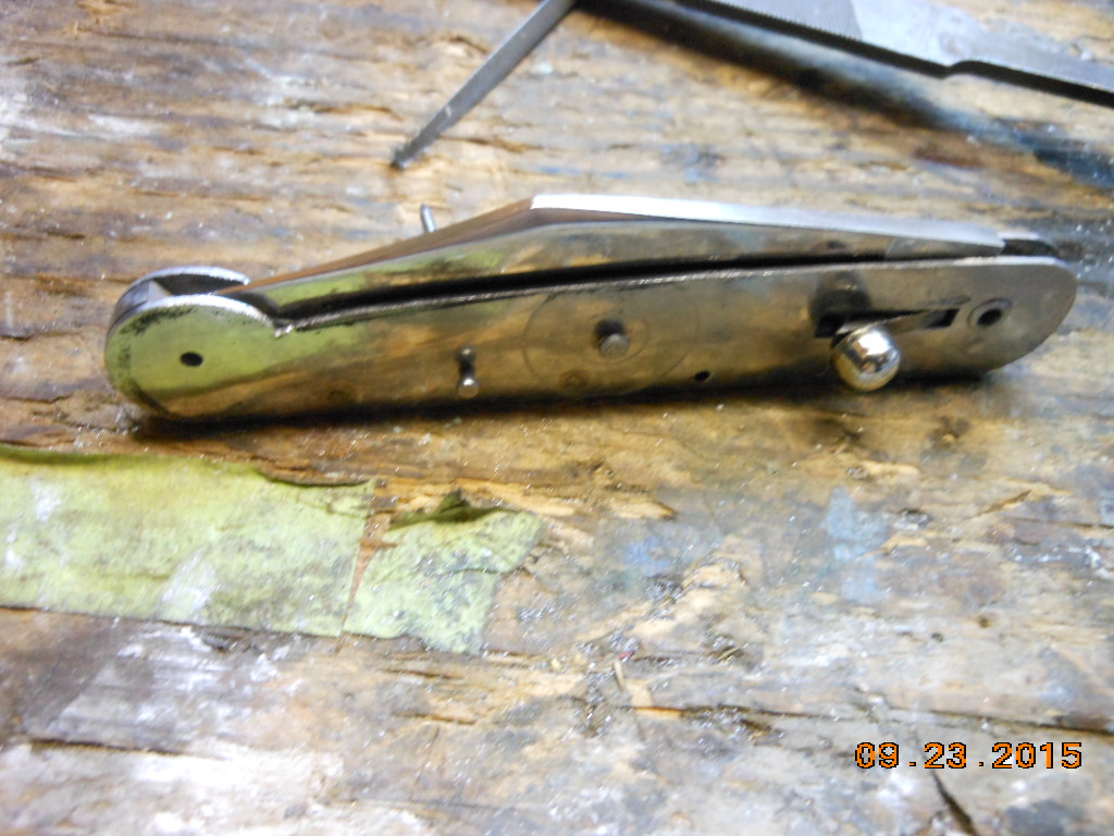

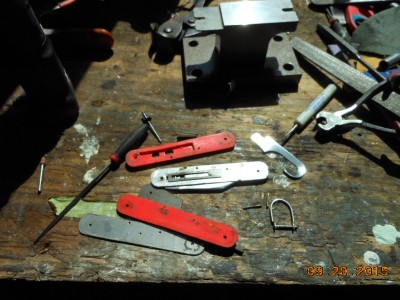

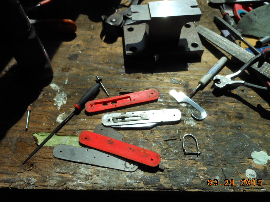

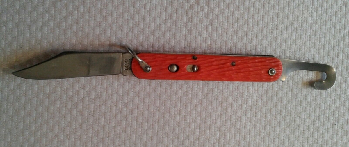

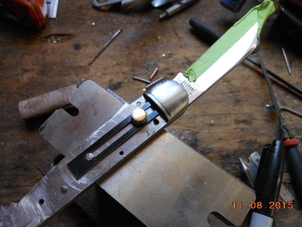

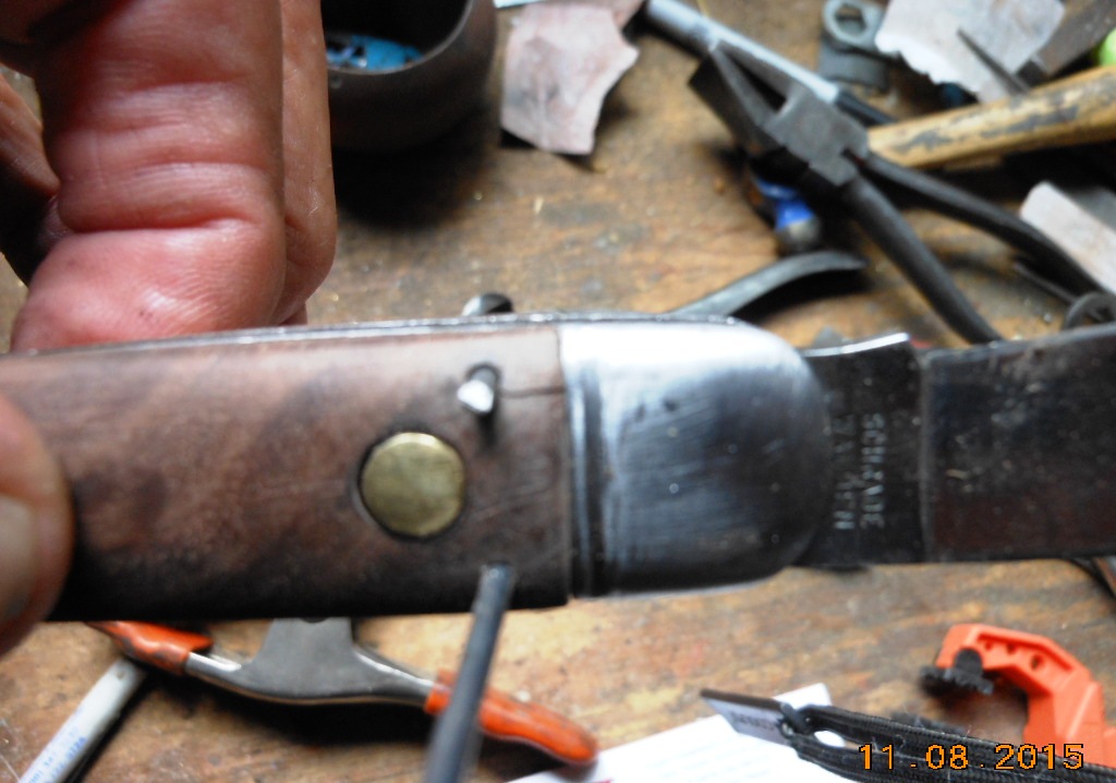

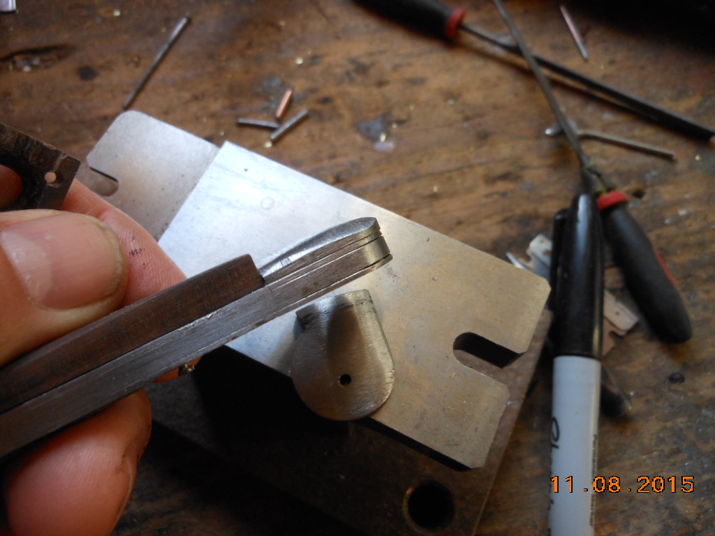

Hey all , decided after 40 years of looking at this broken ugly orange knife to mod it up for my sons 18th in Dec. Broke down and excess baggage removed . re-shaped the frame , found a sear/ button and spring & modified them to work , added genuine Schrade top bolsters( to keep in the theme) and made steel bottom bolsters . He asked me to use Walnut for the handle so that's a go
I`m thinking about torx screwing the handles on to keep it seviceable and covering the spring pin .... where can I find lil itty bitty screws and a tap for this ?

Thanks , my son wants nothing to do with screws and honestly I wasn't thrilled with the idea so it will get pinned
the spring pin will be covered dispite its potential for a service issue and will not be peened , it`ll be held in with the handle that way just the back would need to be removed to pull the pin if the spring snapped ...... moving rite along

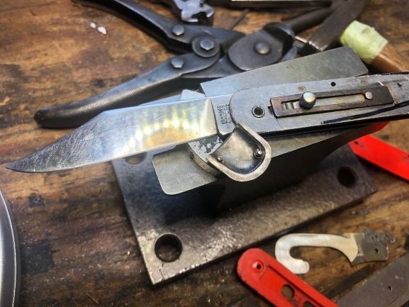

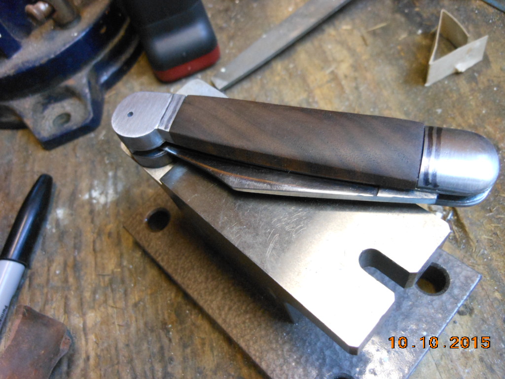

Got the T.V. in the shed watching the games and working on my knife ( lifes good ! ) todays progress , just need to pin the handles and a little touchup here & there
Not the prettiest knife but sure better than what I started with ......I've seen a lot of the orange knives done but not like this , i hope you guys like it

Re: Para mod
Not a criticism, just wondering what your thought process was when you left the edges on the lower bolsters sharp.
It looks a 1000% better than the original. I like it.
wiseguy
- Posts: 1187
- Joined: Sun Jul 22, 2012 4:46 pm
Re: Para mod
I was looking at this picture and didn't like them rounded off , i may put a slight bevel on it but not quite sure . If you have a suggestion I'd like to here it
jerryd6818 wrote:Not a criticism, just wondering what your thought process was when you left the edges on the lower bolsters sharp.
- jerryd6818
- Posts: 39458
Re: Para mod
JJ that's kind of a personal choice don'tcha think? Since it's for your son, maybe you should ask him. Who cares what we folks think. I was just being nosey buddy.

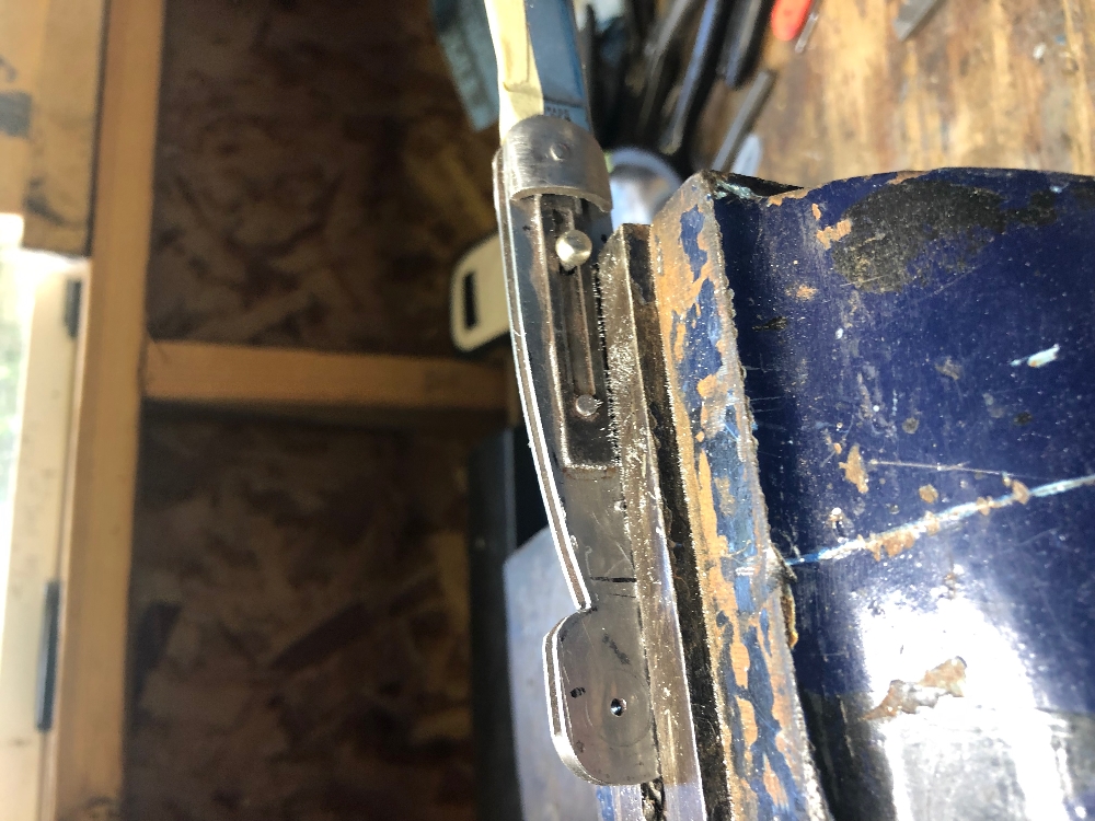

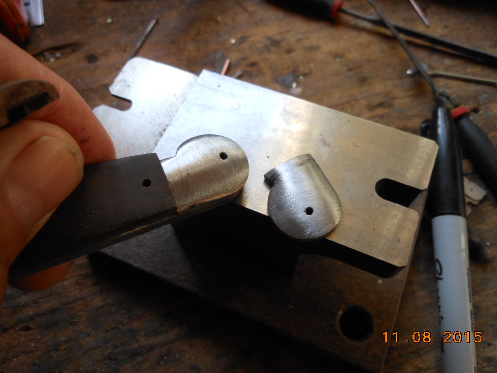

Update ! My son asked me to slim the knife down and re-do the bolsters (DONE !) drilling for pinning the bit glanced off the backspacer and wondered hogging out the hole a bit ::doh::Moving forward
and just when I thought I "had it made" .....i cracked the front handle
time to start drinking

Re: Para mod
That sucks about the cracked cover.
I'm sure you will whip that back into shape though.
I notice there is no lock on your mod, but I like what you did semi-recessing the release button.

Re: Para mod
Ya it sucks , I just cracked # 2 as well , you must have the patience of a Monk
I`ll give another try later and by the grace of God maybe it will get done !

Re: Para mod
I have found pinning further back from the edge of the wood scales if possible will stop it from cracking.
A good epoxy between the liner and scales will also help so you don't need to pin as tight.
Clean liners and surface of scale to be glued with acetone before gluing and clamp overnight.
Works every time for me.

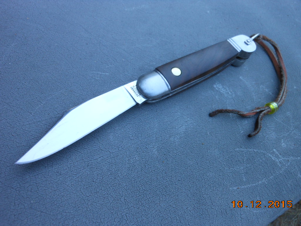

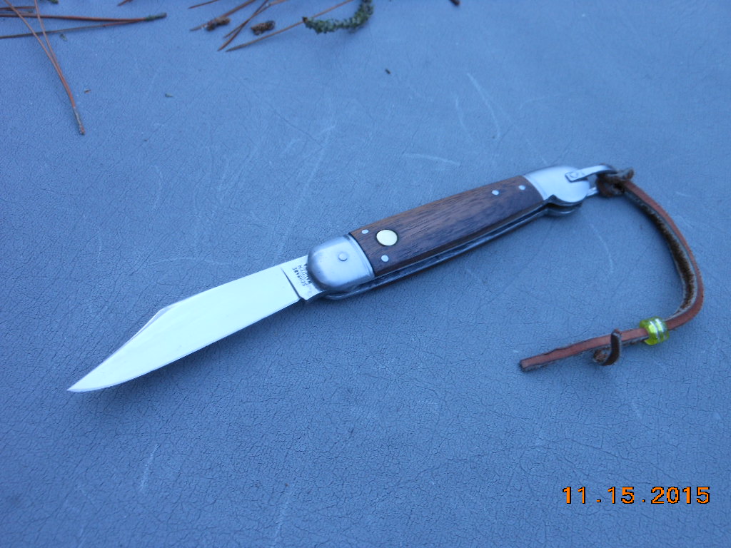

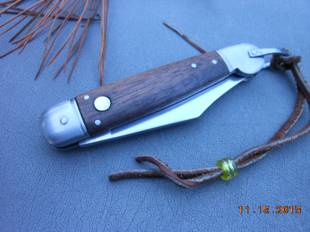

All Done ! Custom bottom bolsters and bail , modded sear,spring and frame and Walnut handles from scrap from the front doors to my house .....my sons 18th is dec 3rd and he will have his knife
Hope y`all enjoyed the post as much as i did modding this broken orange POS that was sitting on my desk for over 35 years

Thanks for the nice comments Gents , if you decide to do one similar double check you handle pin layout to either clear or pierce that back spacer and you should be home free

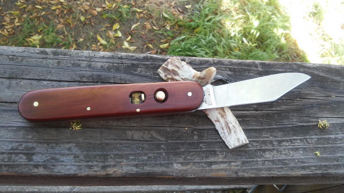

Nice work wiseguy! I like the bolsters! I did a Camillus some time back. Scales are Manzanita!
Randy

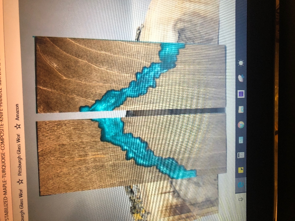

Started another one , these MC-1 mods are fun for me and satisfy the soul...tore it down & pulled off all the unnecessary parts since its gonna be a single blade EDC. I started to Re- shaped the frame & got it ready for top bolsters.
- orvet
- Posts: 19901
Re: Para mod
Great work in the end result is very impressive.
wiseguy
- Posts: 1187
Re: Para mod
Thanks Dale. Here's what's going on for handle covers, it`s a stabilized Maple with blue Shock , I may do a little file work up the back spacer as well.
