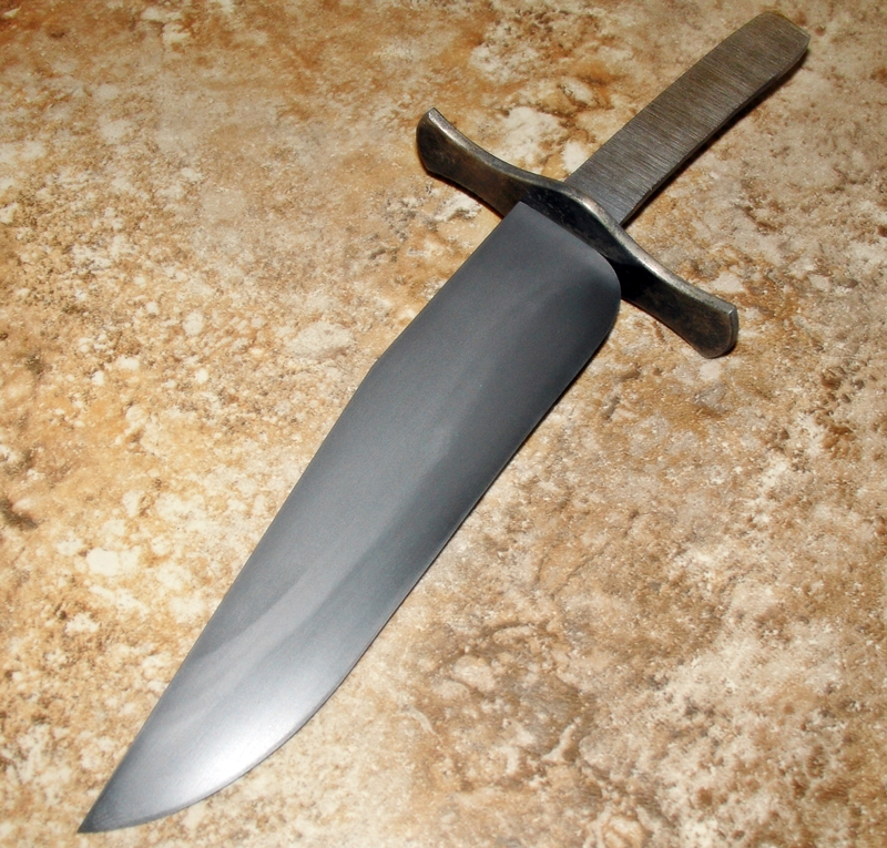

I think at some point in every knife makers career he/she considers making the famous "Bowie" knife, some people specialize in them. This 7" blade is hand forged from a 2"x3" billet of 52100 carbon steel, the guard is also 52100, it will have Sambar Stag scales with a full tang and perhaps a butt cap. I can't decide if it's going to be flat or convex ground. Thanks for looking.......

SteelMyHeart85420
Re: Bowie project...............
I'm not a big fan of Bowie knives, but, if I were commissioning that blade, I'd ask for a convex grind, and no pommel. That Sambar will dress her up nicely, you do fine work.
Yeah, convex seems to be the order of the day for bowies and big choppers. Thin enough to bite deep but thick enough to retain weight and strength.
I like the blade on that knife, though I think the guard (as it is now) is too big. Seven inches is a nice size, I can actually imagine using it to skin a buffalo or other tasks. As to the grind, if it were me and I thought it might actually be used, I would go with a flat grind, especially since I am guessing that blade is pretty thick. And a bit of pommel, just enough to (hopefully) protect the stag when it is dropped.
When you say it is hand forged from a 2"x3" billet, what do you mean? I have hammered out a few blades and that is one heck of an oversize billet to start hammering on!

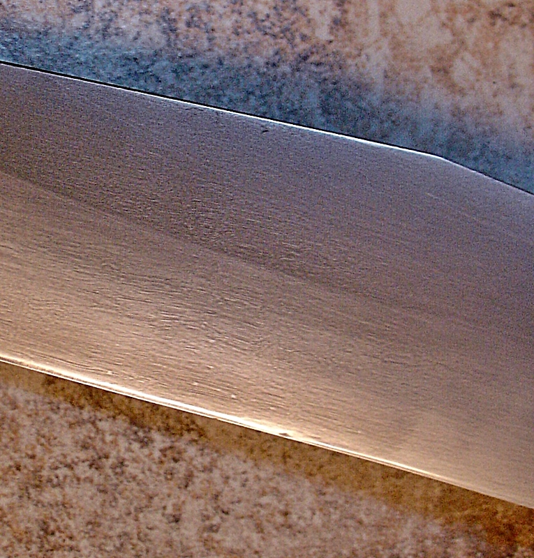

Thanks for the compliment and the feedback Steel..........I ended doing a convex grind, I was kind leaning that way since I think it's the best all around grind if done properly. That stag is going to look awesome for sure!
Thanks Kaleb for the feedback, I think this one is going to turn out pretty good!

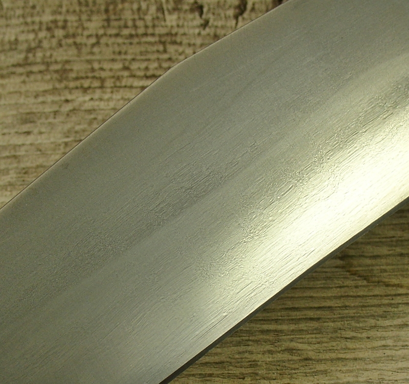

Dinadan, these 52100 billets I have started their lives as a 5" round. They were then sliced like bread and worked down by Ed Fowler into billets. I did type 2x3 but they are closer to 2x2 by 24 long, I work them down from there. This is the steel that Ed has been using for years and has had great results with it.
You can clearly see the hamon lines in the blade, one a bit higher than the other. I'm leaning toward not removing the carbon from the guard and leaving the dark enchant color on the blade.............
What do all ya'll think?
That is a very cool photo with the hamon lines. Thanks for the info. Sounds like a lot of metal removal to create that blade!

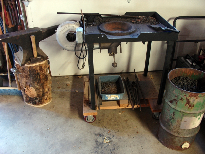

Mel, a bellows is cool............mine plugs in.Dinadan wrote:Do you have a bellows of some kind pumping air through the base into the fire? My dad used an old vacuum for a bellows and since his forge was an old tire rim, it had a hole just about right for the bellows pipe.

- wlf
- Posts: 6245
- Location: WV

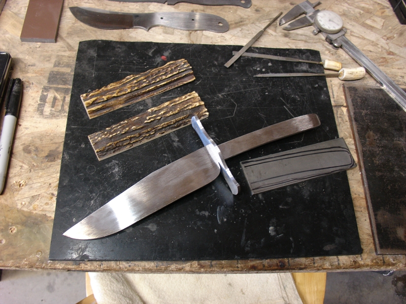

Clean ,efficient looking workplace Gary. Nice looking stag too.

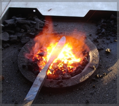

Thank you Lyle. When I fire up the forge (coke forge) I open up the door and roll it outside, there's a nice big slab in front of the shop. It's real easy to walk my anvil out there too.
Will, I have not seen that piece. I'm doing a search to find it here pretty quick.

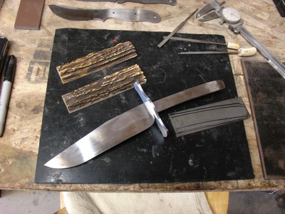

The epoxy is setting up on the stag scales as we speak. I'll peen the pins, clean her up and put an edge on it tomorrow. Then I can work on a sheath for it.

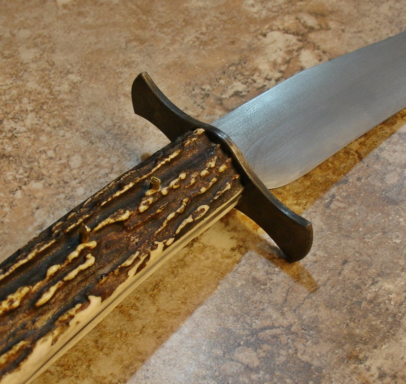

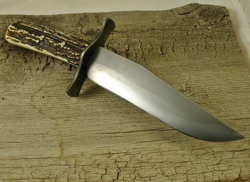

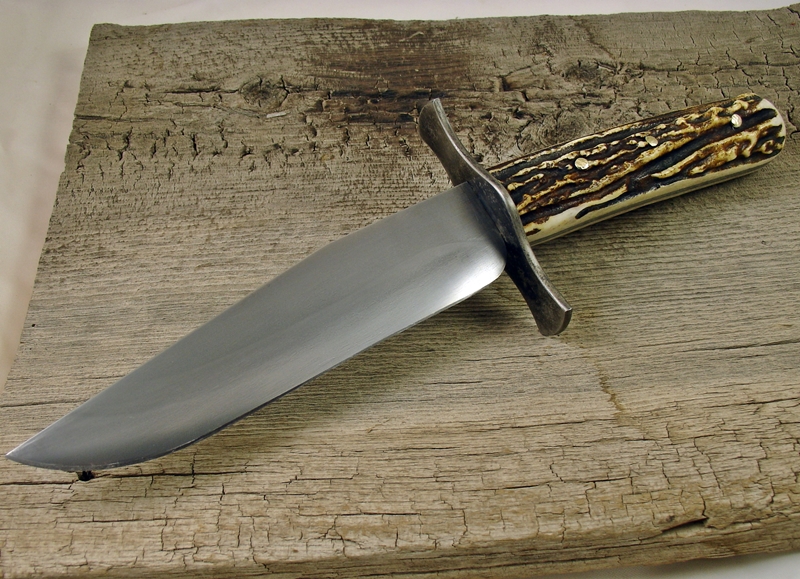

Getting close to finishing the no frills Bowie. Peen some pins, clean her up and she's complete. In the not so good close up of the blade you can see the grain structure after etching.

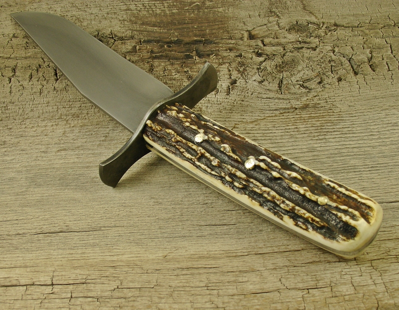

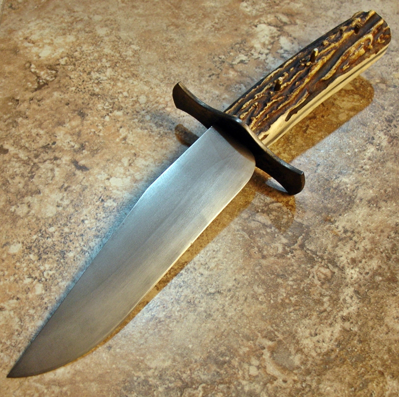

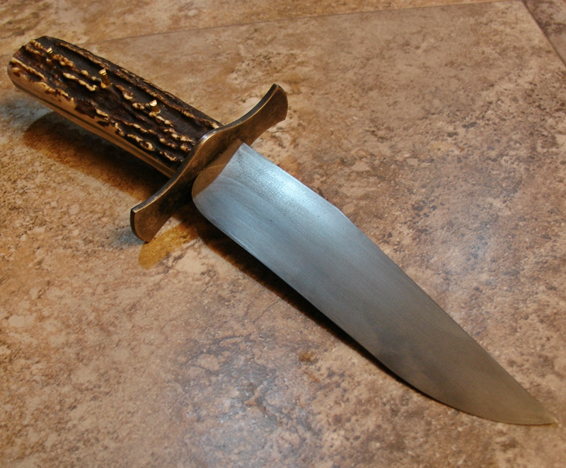

Here she is.........all dressed up and no where to go. It was a fun build, I learned a lot. I really like the knife it's just what I envisioned from the start. It would be an awesome knife for one of those guys in the SASS.
The knife ended up 11.25" overall with a 6 3/8" blade, it has a full distal taper, the spine is slightly relieved or rounded, convex ground with a full tang handle and presentation grade Sambar Stag scales. The slight recurve was intentional and just love the look. The guard I left with an oil quench finish which resembles case hardening. It balances just behind the guard on the index finger.
Thanks for all of the feedback guys, I appreciate your time.

Thats Gorgeous Gary !!! A real old no frills classic on a great American knife pattern...
I really like the flat hilt /guard....you know how on alot of bowies the
guard is bent one way then the other on the off side....
I have found using big blade knives that they are much more responsive
in the hand for different tasks with the flat guard the way your fingers hit it
It really came out good Gary...you should be proud...
thanks for the posts & pics............
Will

Thank you Will!
This has been a fun project, this knife may be my all time favorite so far. It incorporates all of the aspects of a knife that got me started in this knife making venture. The Scagel influence, early Americana, hand forging, red hot steel hammers and sparks, Ed Fowler, Wootz, Stag............it's all there and the more I handle this knife the more I like it.

Gary that is a wonderful knife. Your skill is obvious and the end result is something anyone would be proud to own. Well done.

Thank you Phil, I appreciate the feedback. I enjoyed this built enough to perhaps do another one here shortly.

That is a beautiful knife! Looks just right for the great plains in the 1840s. Looking at it makes me think buffalo hunters, wagon trains, fur traders ...
