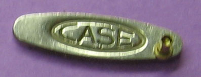

wildcat
Posts: 349
Joined: Wed Dec 06, 2006 12:28 am
Location: Kingwood, Texas
Post by wildcat »
Take apart a new Case and you will see what i am talking about. This is NOOOOOOOTTTTTTTT a pin that has been peened. I have peened hundreds of pins, I know what they look like. Unless they have the most advance peening technology in the world that makes a perfectly flat and round head on one side and a hole in the other side. I guess i need to take a pic.
Thanks ::tu::
orvet
Posts: 19901
Post by orvet »
A pic would help.

wildcat
Posts: 349
Post by wildcat »
okay, sorry for the loooong delay. I kept forgetting to take the pic.
this is it. kinda fuzzy, but you get the idea.
orvet
Posts: 19901
Post by orvet »
It looks like what you posted is the same as the ones I posted. Mine are still crimped down, holding the scale to the liner.
I think that type is just crimped to hold the scales on. Much easier to do by machine than peening a pin.
To answer your question:
No, I don't know where you can find them. I think it would be very easy to replace them with peened pin stock.
