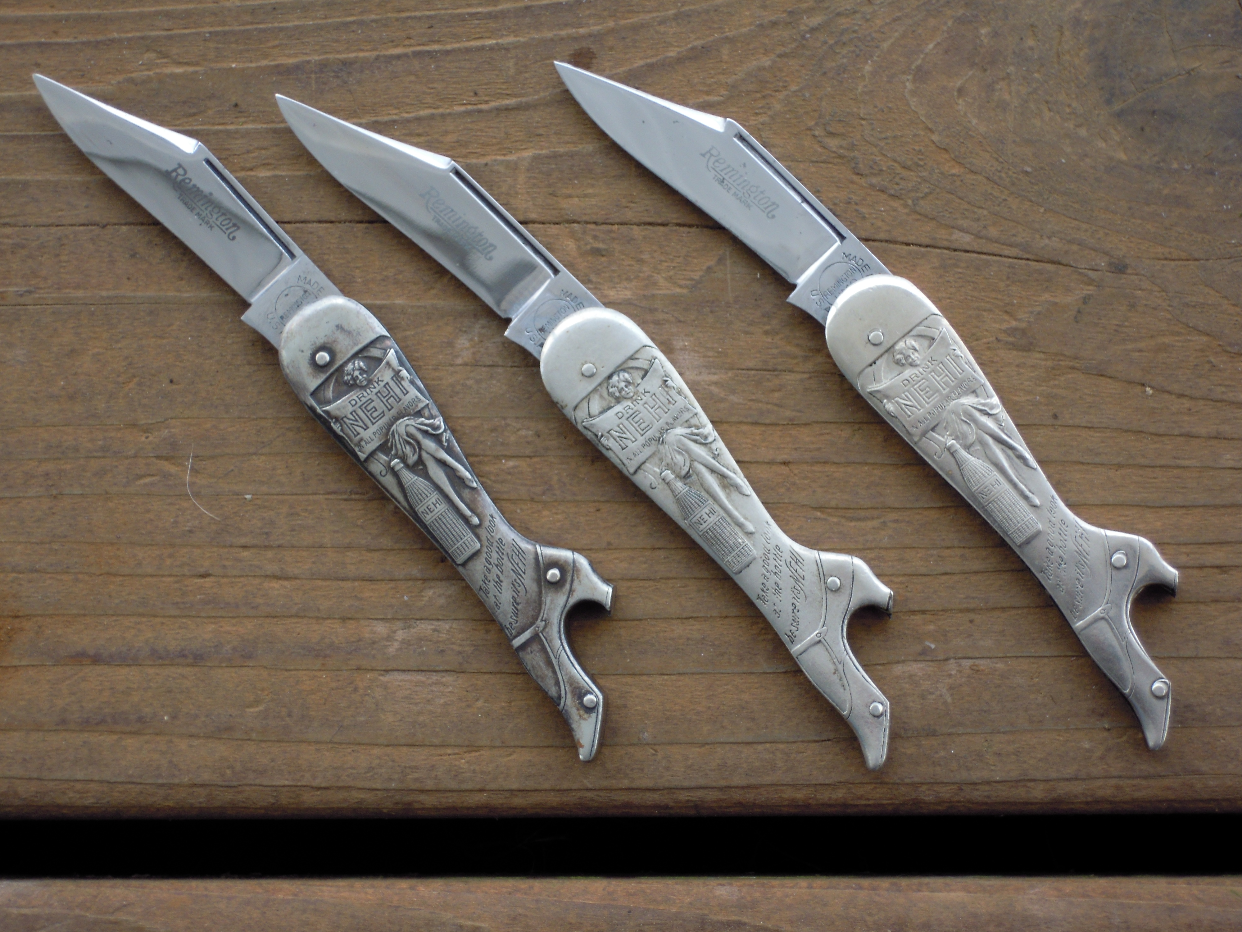

If it has a chain attached that was an aftermarket add on. Originals did not come with chain. Look at the provided link to the Dennis Ellingsen article for all you need to know. The three shown below are all original near mint with blade etch. An easy and quick way to tell originals is the bottle cap lifter if intact will be a sharp hook on the original. Also note the line across the lower part of the bottle. Most fakes do not have this feature. Also note the different locations of the handle rivets. Fakes are usually on the lines of the shoe while on the originals they are not. There are always a dozen or more fake or reproduction Nehi's on Ebay. many thousands have been sold. A few originals turn up and rarely a near mint original Remington Nehi will turn up. I had three near mints but only have one nice one now.
http://www.allaboutpocketknives.com/kni ... &mode=view
