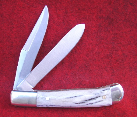

I've read just about every tutorial here on the site and gazed wonderously at some of the beautiful work that has been displayed. It serves as a great initiator and offers encouragement to an all thumbs novice to the knife world, especially in the art of rehandling and such.
Pictured is one of my latest victims. It began as a Parker (Japanese) trapper with a cracked set of handles that happened because someone (???) tried to pein over the rocker pin and laid hands on it too hard! :roll:
It ended up with the set of white handles pictured that are of elk leg bone. The natural cracks are only superficial and don't really effect the integrity of the knife. I'm fairly well pleased, but I learn a little more with each project. I'm using knives that aren't of any real collector interest, so I'm not putting myself into any real jeopardy.

you done good Dewey! Nearly all handles I have done in natural bone have those natural cracks, I just did a Schrade 8OT today and it has a couple of those natural hairlines. I like that alot, in fact I think you should send it to me for further inspection. I'll send it back......... I promise :lol:
What I like to see is the attention to fit between the bolsters, no gaps that I can see and a nice smooth polished finish on both handles and bolsters. You're learning quick. ::tu::

Thanks for the encouraging words, MM. As you know, when the two bolsters aren't parallel with each other, it makes it somewhat more difficult. But, I've learned to shape the new scales so that they will "wedge" themselves tight. I'm sure you know what I mean. I like the cracks....and on the next set I do, I'm going to soak them in some lacquer based wood stain overnight....maybe a dark mahogany color.... hoping it will give them an aged ivory look. Have you ever tried this?

real nice job ::tu::

First of all let me say I like your work very much. SECOND, the "natural cracks" if you will are the genuine character of the knife. I don't understand why folks will discard a knife, or like with some GEC Primative Bone knives, I know a distributor who had knives returned due to these natural cracks, they were not pin cracks (did hear of some of those) those are caused by assembly and are not acceptable, give me one with natural cracks please. Matter of fact, go to Alpha Knife supply and look at the mammoth ivory. Which ones are more expensive, why the "cracked Ice" of course, because they add so much charactor to any knife. OK, I apologize for the rant, a pet peeve if you will.
I see that you're fairly happy with your work and you should be. But to me it means you see ways of doing it different and you want to improve with each knife. ::tu:: ::tu::
Hmmn, Maybe try what GEC did with Copenhagen or green tea to dye. Walnut hulls collected in the Fall make a nice natural dye.
Keep up the good work, you're hooked! :D ::nod::
