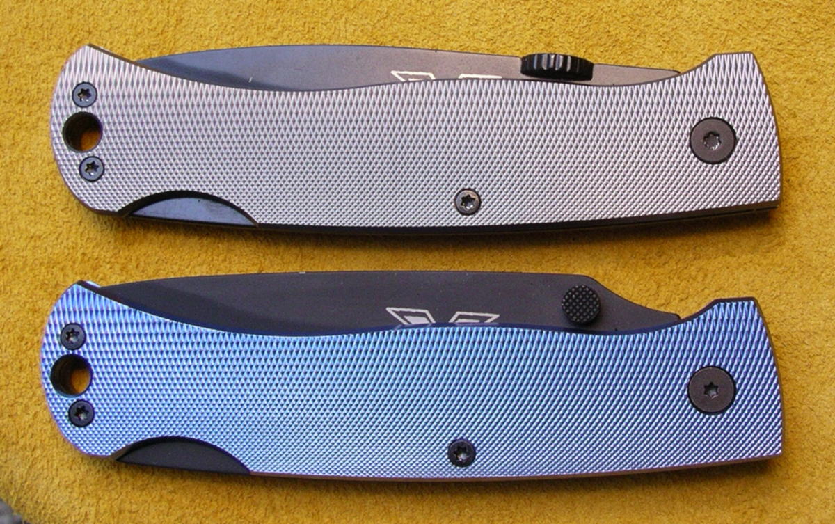

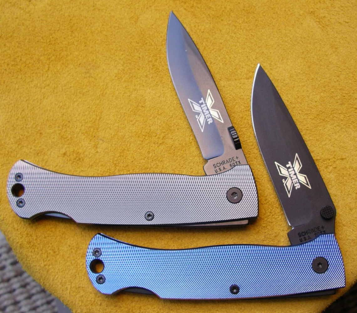

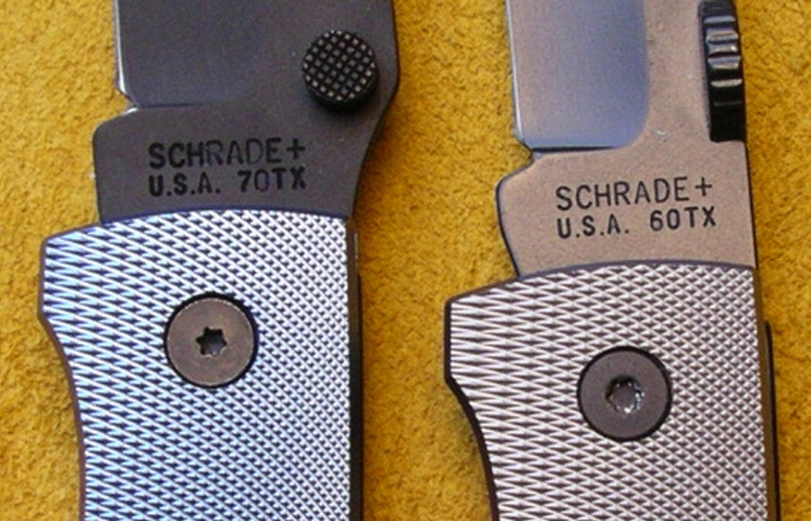

Here are pictures of the 60TX & 70TX, the knives with frames made in China & then knives finished in Ellenville, N.Y.
They are full size 5" knives like the 7OT and 6OT, but slender not as heavy. Blade action is smooth and lockup rock solid.
What i'm trying to say is that these are Very nice knives. Note too how blade is shaped at base so that tang is covered when closed. Nice feature, well thought out.
If you are shopping for these i think there are also ones made in China after 2004 that look the same but no "U.S.A." stamped into tang.
kj
OOPS, i just realized i am a bit off topic here. Thread says "Old Timers" and these are "X-Timers". Still it's all Schrade so good to share what we know.

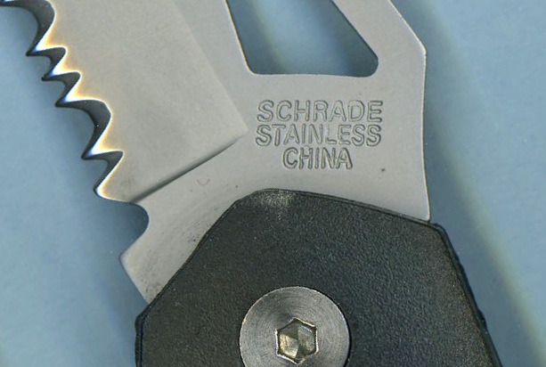

kootenay joe wrote:All Schrade made knives are marked "U.S.A."

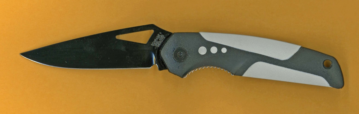

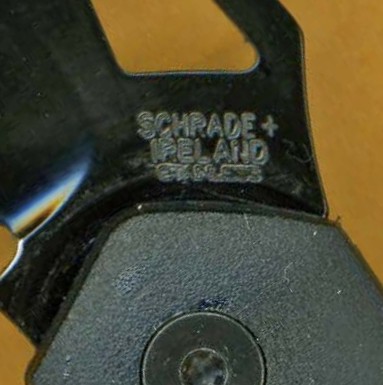

That is true so far as I am aware with the exception of the Badger Series. The Badger Series were produced and assembled in China though I have one in my collection that is tang stamp Ireland. So apparently they had some SX-4B knives made in Ireland. That’s the only model I have seen with the Irish tang stamp.
~SX4B Ireland tang.jpg (43.09 KiB) Viewed 4820 times

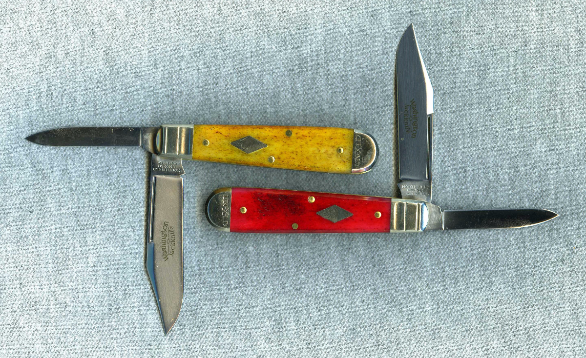

Anyone who would like to have an original 2OT (and who wouldn't?), I have to say that the Washington jacks by GEC are stunning. I hope I am not going too far afield here.
kootenay joe
Posts: 13373
Re: Which Old Timers did Schrade NOT make?
Post by kootenay joe »
Not far afield as orvet did say it would be great to see a new Schrade 2OT made in USA. The GEC Washington Jack you show is a recently made USA knife that is a close replica of the Schrade-Walden 2OT.
It is such a fine pattern that i think if Smith & Wesson were to have a new Schrade 2OT made in USA if would sell well. The relatively small run of the GEC Washington Jacks was not enough to saturate the market.
