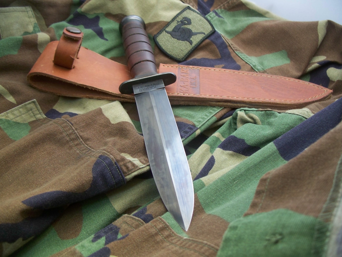

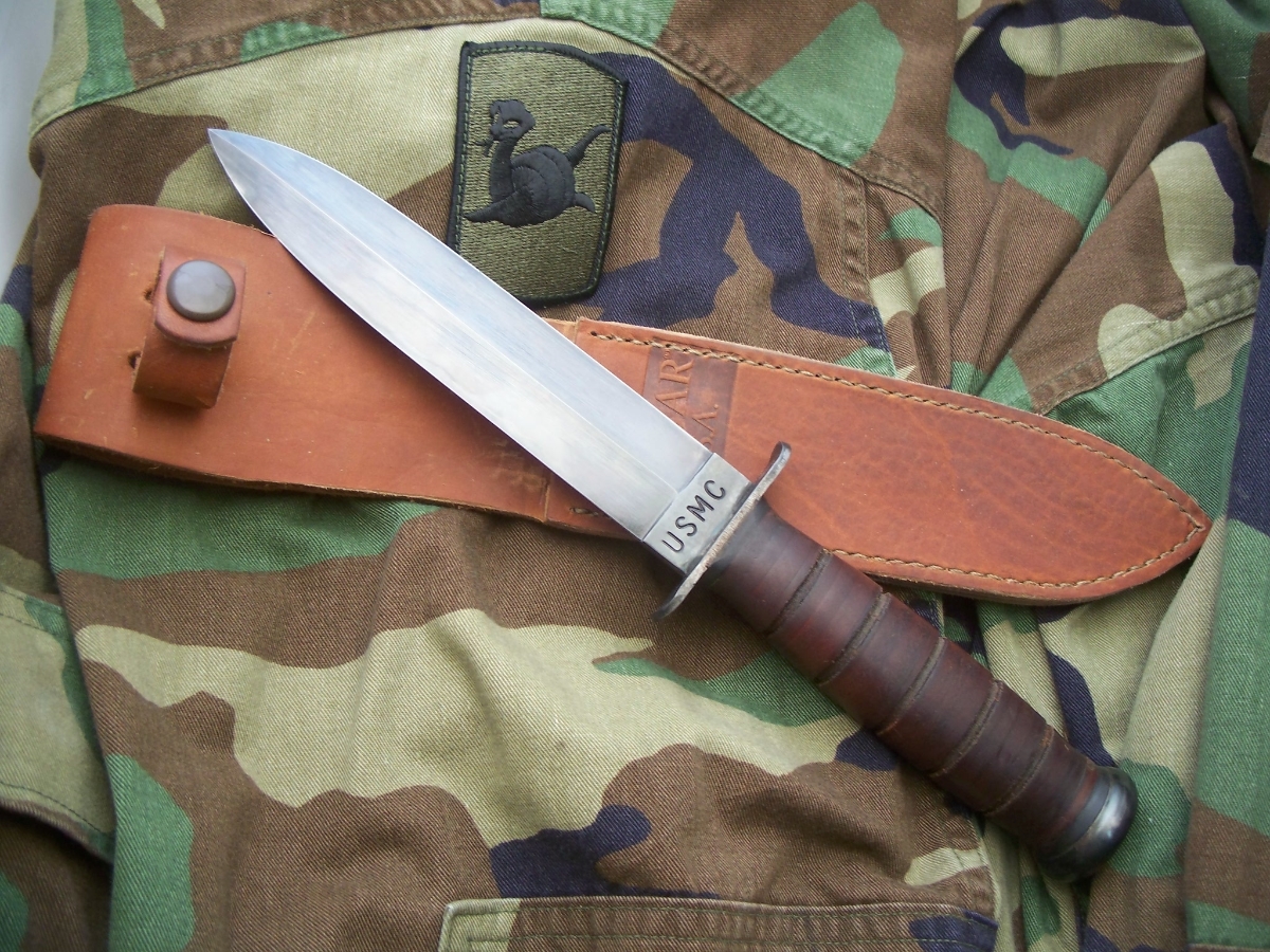

I started this a few years ago but never had time to finish it. Finally did it last weekend when I had a few free moments. This is your standard KA-BAR fighting knife reworked into a dagger, and I reworked the original sheath as well. This was a beater I got off ebay for about $27 if memory serves, I had to replace a couple washers and I replaced the thin factory guard which was bent with a reworked guard from a WWII Camillus navy MKII which is much thicker and more rigid. The bluing on the blade does not show up well in the photos, I think I had the lamp too close to the light tent. It was a fun project and is one more eliminated from my tote of unfinished projects, hoping to knock out a couple from that tote each month. There is 7 years worth of my personal unfinished projects in there that I have to throw aside when duty calls.

I'm still shaking my head ...
I can see how you have done it and it's a 'relatively' minor and simple mod ... BUT what a quantum change in looks and functionality

MM, that might just be my favorite of all the mods you've done. The shape, the lines, everything about it is very pleasing to the eye. And I just can't help but believe that the balance on that thing is superb.
That's a very nice dagger.

MM, that knife looks great. You do some very good work. Thanks for posting.

That's very cool, Kaleb! I like what you did with it.
I have a ton of personal projects also, but as you said, duty calls. Customer work always comes first, but occasionally, I can slip one of mine in as well.
Keep up the good work!

Kaleb, I am with Wade, I think that is one of my favorite mods of yours!
You got the centerline pretty straight to from what I can tell in the pictures. As you know that is not an easy task!
I'm just glad I'm retired and don't have to depend on knife repair for a living!
However, if I just spent the money I make repairing and modifying knives on groceries, I wouldn't have to worry about a weight loss program!
I have some really cool personal restoration projects set aside for when I get time. I think if I worked eight hours a day, five days a week on my personal projects it would still take me several years to complete them all.glennbad wrote:I have a ton of personal projects also, but as you said, duty calls. Customer work always comes first, but occasionally, I can slip one of mine in as well.
