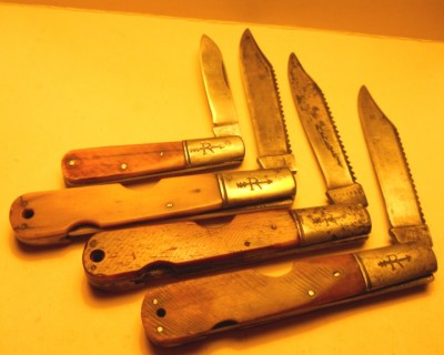

You can see in this picture that the center pin is forward on a lockback Russell knife. Also these fish scaler knives do not have a nail pull so maybe the knife in the op was a fish scaler that was damaged and the scaling portion removed from the blade and that is why that area is beveled. My comment about the Russell's having nail pulls in the op was in reference to the regular knives and not the fish scalers.
I suppose if this were a straight knife it might go for near $400 - $500. Stag is rare on these. Maybe someone has a good blade for it and is buying the frame?
