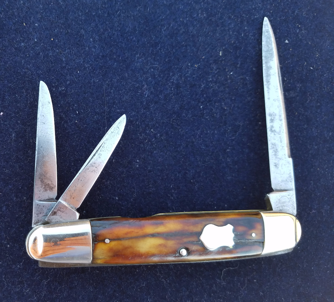

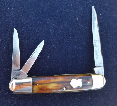

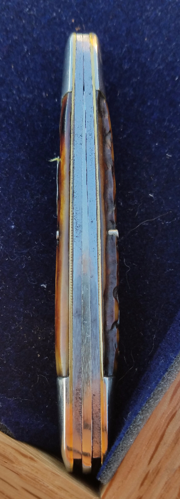

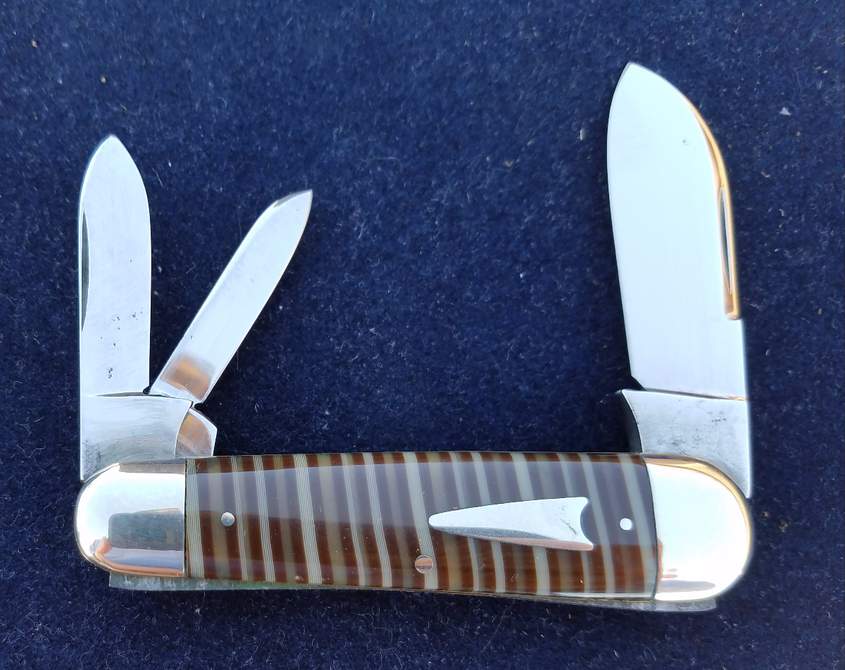

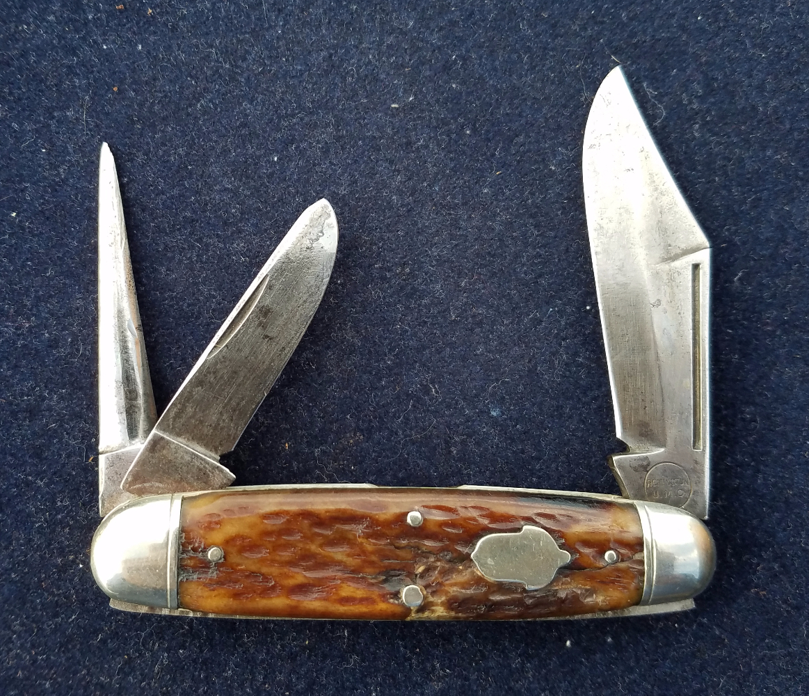

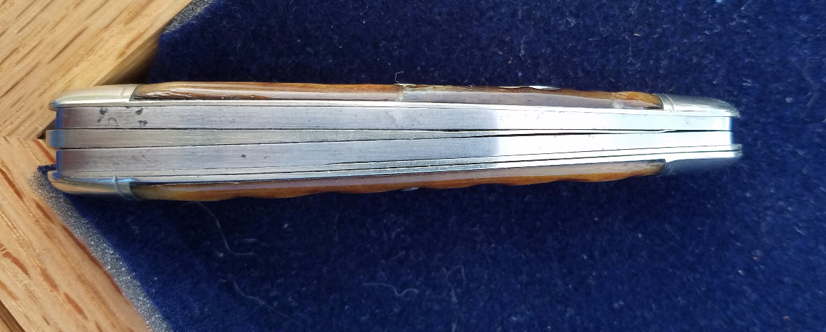

Ok. I appologis for not starting with pictures. Here are 4 different handle shaped knives. Ranging from 4.5 inches to 3 inches. All having the main blade use both backspring. Looking at them for me to wondering if they all were considered whittlers.

Keith,
I am not an expert on whittlers, but I would consider those for knives to be whittlers.
Those have the tapered wedge center brass liner, so I would not call those a split back spring whittler.
But I would consider them whittlers.

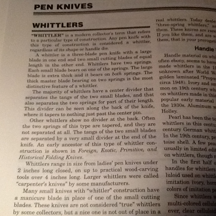

Those all fit my definition, but that's not worth much.
Per Levine's Guide to Knives, here's what he says about it. Hope this helps. To answer your question though, take a look a this old post. Looks like a true split backspring, like Roland was talking about, but it's not a whittler!

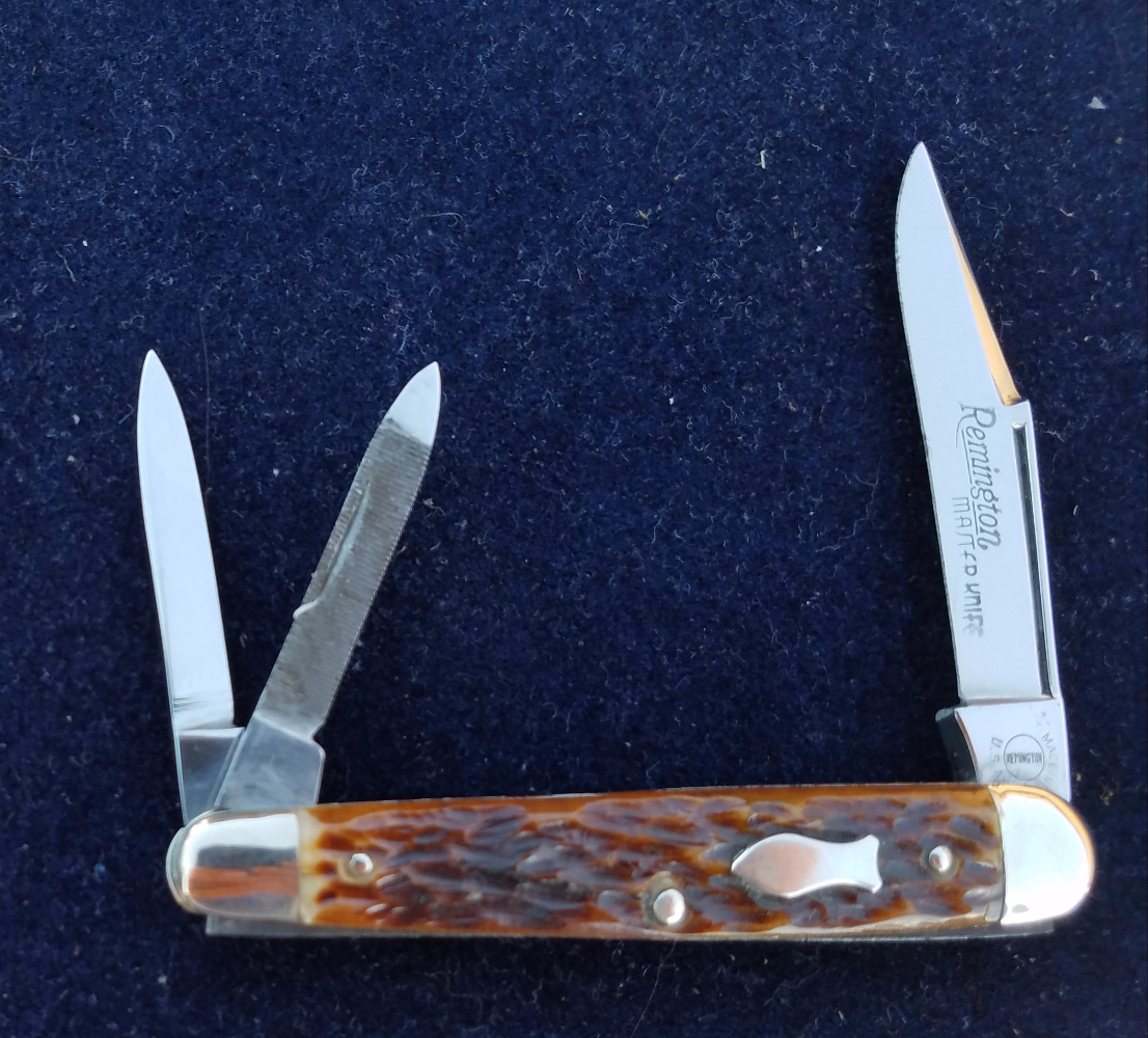

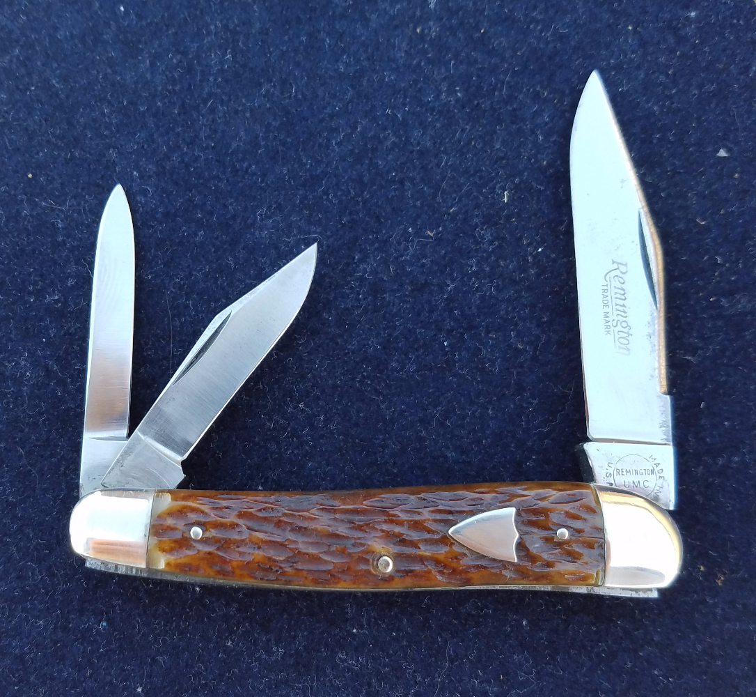

I've been digging around and found this one. I have been under the impression this is a cattle knife "BUT" pretty good chance I'm wrong.

Keith , If memory serves me correctly and often times it does not But I believe Case made some 45's inthe split spring fashion that looked more like Cattle knives than whittlers.espn77 wrote:I've been digging around and found this one. I have been under the impression this is a cattle knife "BUT" pretty good chance I'm wrong.

If I read Levine correctly he'd say it's a whittler. Probably either a "jumbo" or a "cigar" whittler - his book has a chart listing those types along with 14 other kinds of whittlers. Personally I'd call it a cattle knife built on a whittler frame. The spey blade qualifies it as a cattle knife. The construction makes it a whittler.

Ken that is not a Cattle knife frame. Most Cattle knives are equal end with straight sides. Yours is equal end but the sides are slightly oval, i.e. there is a slight curve outward of top and bottom edges. Your Remington is a Whittler and a beauty too.

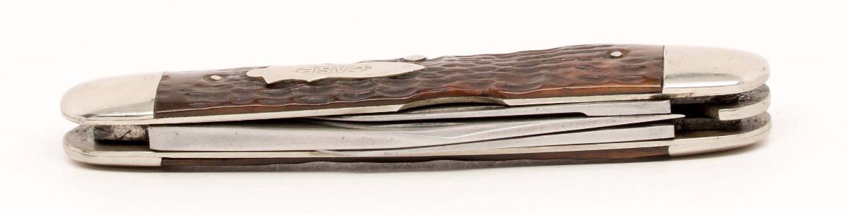

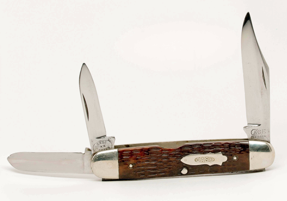

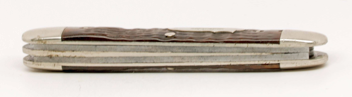

Greg, you are thinking of the Case Tested XX 6345 SAB which is in a whittler blade configuration with a split back spring. It's a rare variation of the 45 pattern and I wouldn't know if it should be called a Whittler, a Cattle Knife, or bothgsmith7158 wrote:Keith , If memory serves me correctly and often times it does not But I believe Case made some 45's inthe split spring fashion that looked more like Cattle knives than whittlers.
Keith, your Remington whittler is super nice!

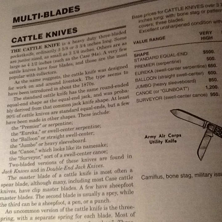

I agree Keith's Remington is a whittler. I also agree the equal-end with straight sides is what would be considered a "standard" cattle knife. However if you have access to a copy of Levine's Guide you'll see under his Cattle Knives heading pictures and descriptions of sleeveboard, cigars, balloons, serpentine, a humpback, and a gunboat canoe. I'm no expert on cattle knives or anything else. Just going by what Levine's says.kootenay joe wrote:Ken that is not a Cattle knife frame. Most Cattle knives are equal end with straight sides. Yours is equal end but the sides are slightly oval, i.e. there is a slight curve outward of top and bottom edges. Your Remington is a Whittler and a beauty too.

I am aware of the various Cattle knife frames. I have a collection of Cattle knives which was my focus a few years ago.
However i don't think the oval Remington frame was ever one used for a Cattle knife. I mentioned the equal end variety because that is what the poster was thinking the frame was.
If a knife fits the definition: 3 blades, 2 springs, master bears on both springs, then it is a whittler. It does not matter what frame is used or what blade profiles are there.
The Case Tested as shown by "Ralph" is a Whittler.
The Whittler is one pattern with a clear definition. Most other patterns have a more fuzzy definition.
