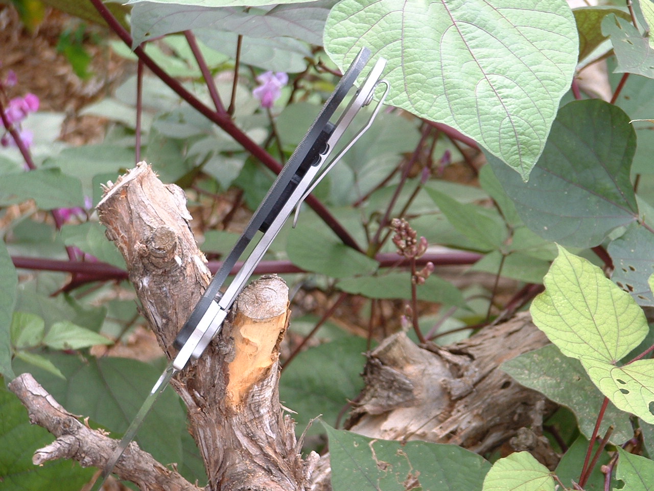

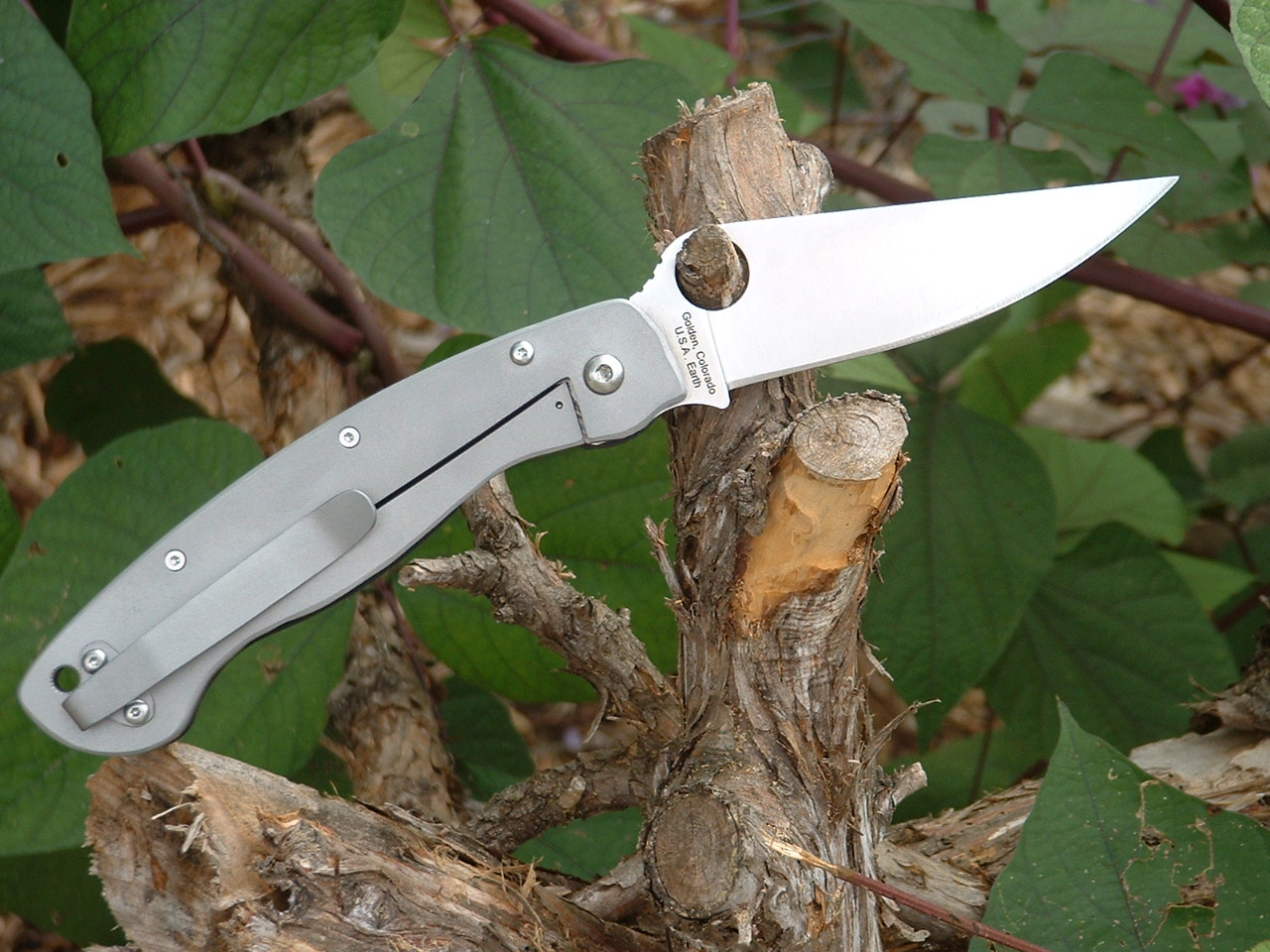

Just finished this one up made to order tonight. This is how they should be from the factory in my opinion. But hey, what do I know right ? :lol:
This one went from a factory weight in the liner lock clothes of 4.2 ounces to as it sits now at 4.5 ounces in .140 thick titanium with dual .068 lock relief cut outs to spring the lock at the bend point, and it sports one of my signiture low rider pocket clips mounted for tip up carry.
Thanks for looking.
STR

So that's what the hole in the blad is for.... :P :wink:
Very nice job and well done man.
KOOL photos too.

::tu:: i like it. very good job

Very nice STR, I love that blade shape ::tu:: ::tu::
