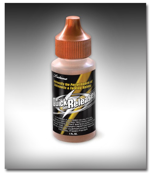

Latama quick release oil is the best, period. I use it for guns too.

I use Quick Release also and I think you will find that lots of the members on this forum do too.
Steel doesn't matter and there are a ton of choices from plain old mineral oil to high tech lubes with Teflon to motor oil, etc. Go with something food safe if you use your knives to cut food.
Everybody has their favorite lube for pocket knives so just pick a few, do a little research, and make your choice. Quick Release works good for me but honestly, I'm happy with anything slippery for my pocket knives. After all, we aren't trying to protect high speed moving parts that generate a lot of heat. We just don't want the joints to wear out and dang near anything will work for that.

I’ll agree with the others that Quick Release is the end all be all for the joints. And it sure doesn’t take much. If you want oil for rust protection, ballistol (or most any gun oil) will work well. I lkke Ballistol the best.

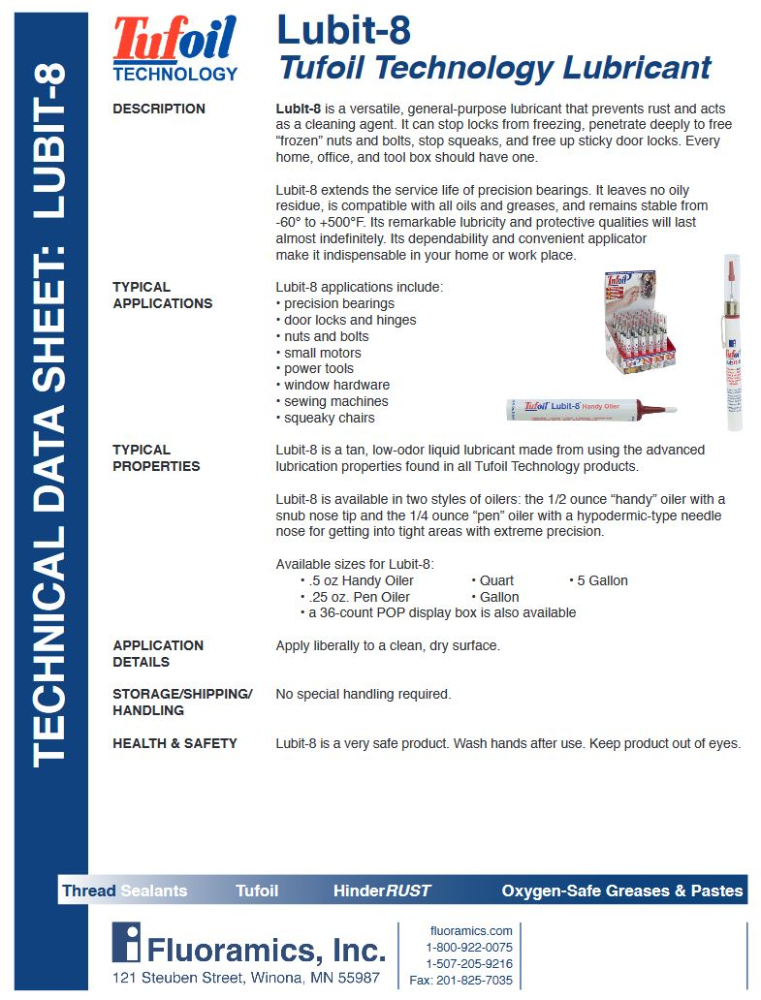

I've always used TufOil with great results.

Quick Release is my favorite as well but I also have a container of the old standby 3-IN-ONE on my desk as well as one of Mill-Rose. Any light machine oil works. Don't use WD-40. It's not a lubricant, it's purpose is to chase moisture.

There's 2 different ones I use:
1. To oil joints-Latama Quick Release. (Amazon)
2. To oil blades for rust prevention-AG Russell Rust Free. (AG Russell only)

Following the video by TripleF I began using Quick Release and, as he demonstrated, have been able to quickly restore the closing snap of some older knives. For long term storage of carbon blades I highly recommend Rust Free by AG Russell. Just apply a drop or two on the blade and with the tip of your little finger you can apply it to the blade. Let me stress, just a drop. You will see how easily this covers the blade.

Then I found Quick Release Oil, and it's absolutely the best oil I have used on knives! I have had knives without snap that begin to snap as soon as I added some Quick Release Oil, even without cleaning the knife.
I have used cheaper oil then Quick Release and I have used more expensive oil, but I have never used an oil that works as well as Quick Release on slip joints, switchblades and modern tactical knives.
