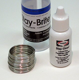

The liner will get a hole blown in it, and the bolster will just get hot. You need similar/same size items to actually make a penetrated weld. Silver solder is the way to go. You can even solder dissimilar metals.
Stay Brite is the brand I use on Stainless, and aluminum. Harris is the manufacturer.

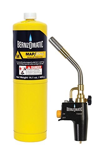

A MAP gas torch is all you need...
