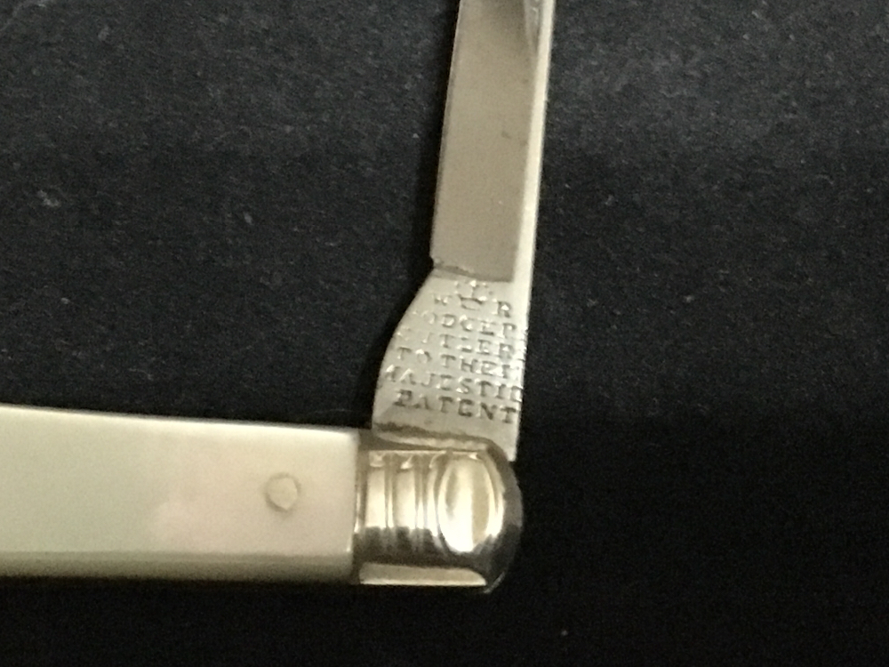

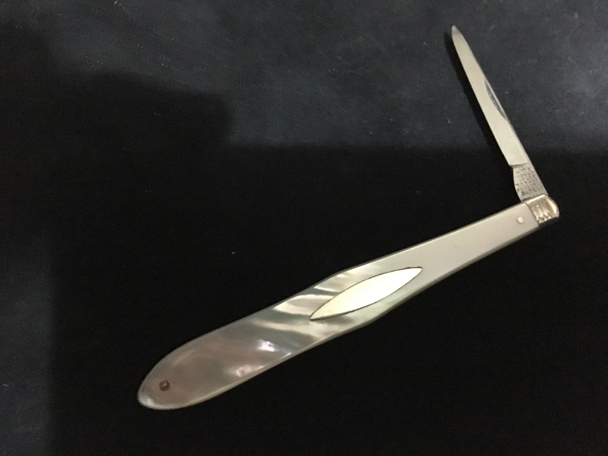

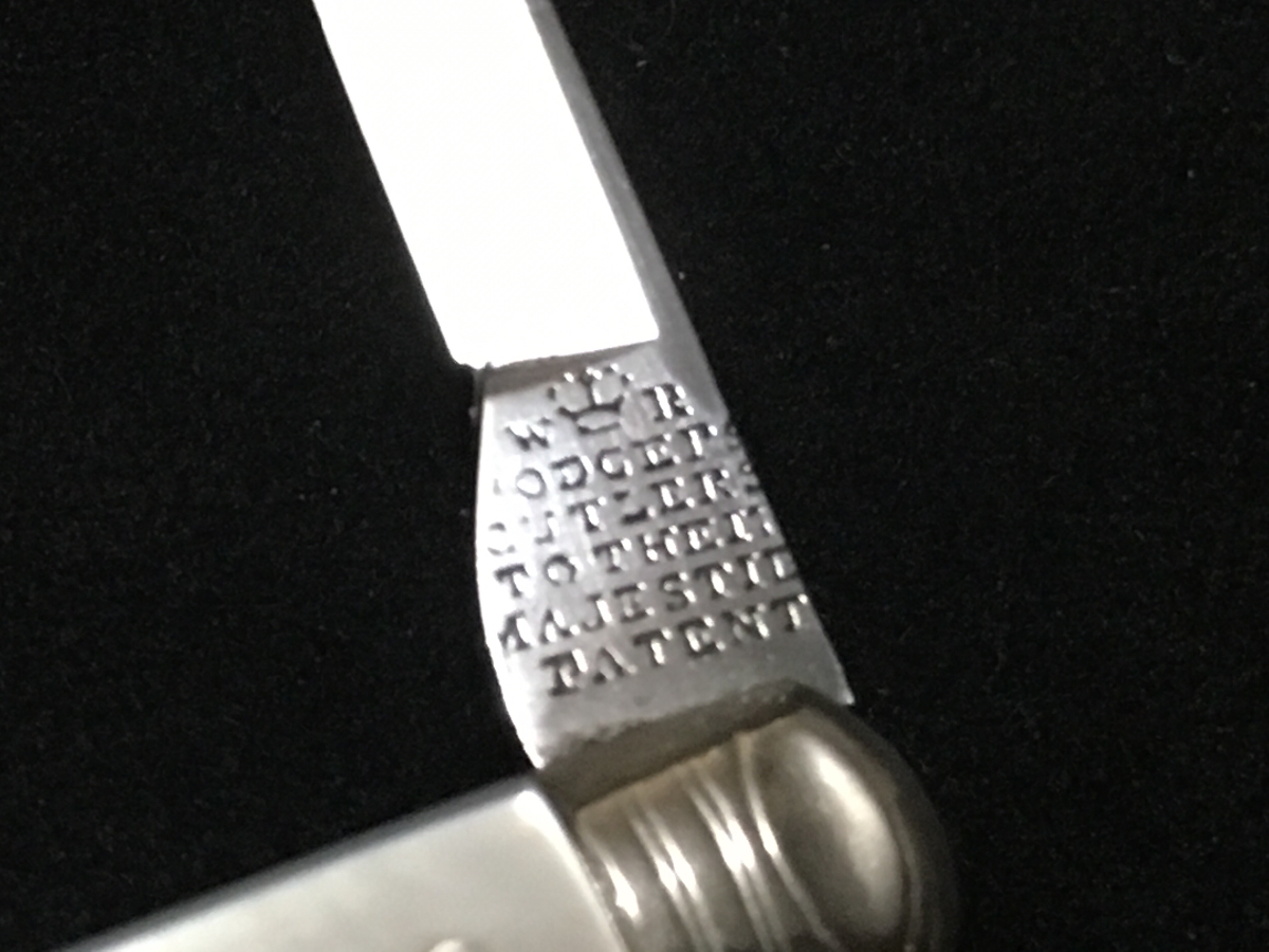

Here’s a Rodgers quill knife I recently picked up. Closed length is 3”. Great snap with a half stop. Gorgeous pearl handles. The tang is stamped W R and the crown, Rodgers, Cutlers To Their Magesties, Patent. Can anyone help with dating this???

Can't say I've seen a quill in that fine of condition in a while. That it was made by Joseph Rodgers makes it especially nice.
Goin's says your stamp dates 1837-1901

I believe FRJ is mistaken. V crown R would be for Queen Victoria, 1837-1901. W crown R is for King Willam, 1831-1837 if my memory serves me, I am away from home so my books are not handy. Your little knife is VERY old and very nice!!

Thanks for your input! It’s the nicest quill knife that I’ve come across. The only blemish is some light pitting on the blade. I picked it up for $68. So looks like a great buy!

Gunsil is correct on that stamp. W crown R, 1830-1837. Good catch Gunsil
Sorry about the error.

I know Goins shows 1837 as the start date for "V crown R Their Majesties" but i have seen "Their Majesties" being referred to as from late 1890's to very early 1900's.
I think "V crown R Her Majesty" is the older stamping in the V crown R era and the "V crown R Their Majesties" was used only at the end of the V crown R era.

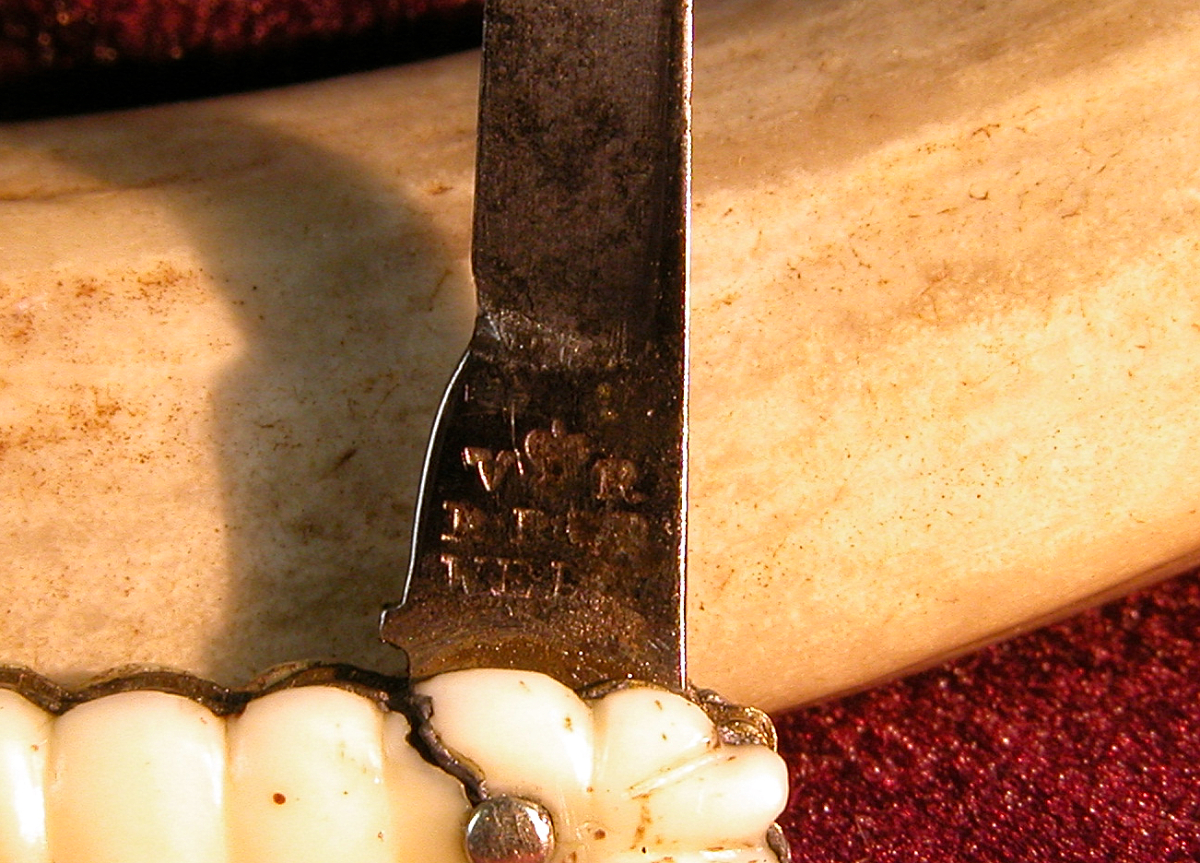

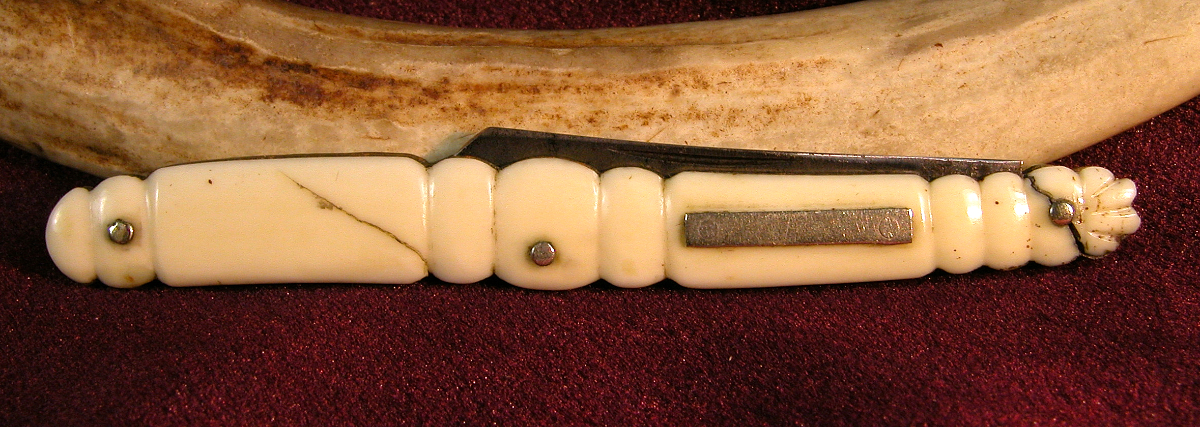

And what if the VcrownR has nothing alluding to majesty at all??? Is that earlier in the 1837 to 1901 range??

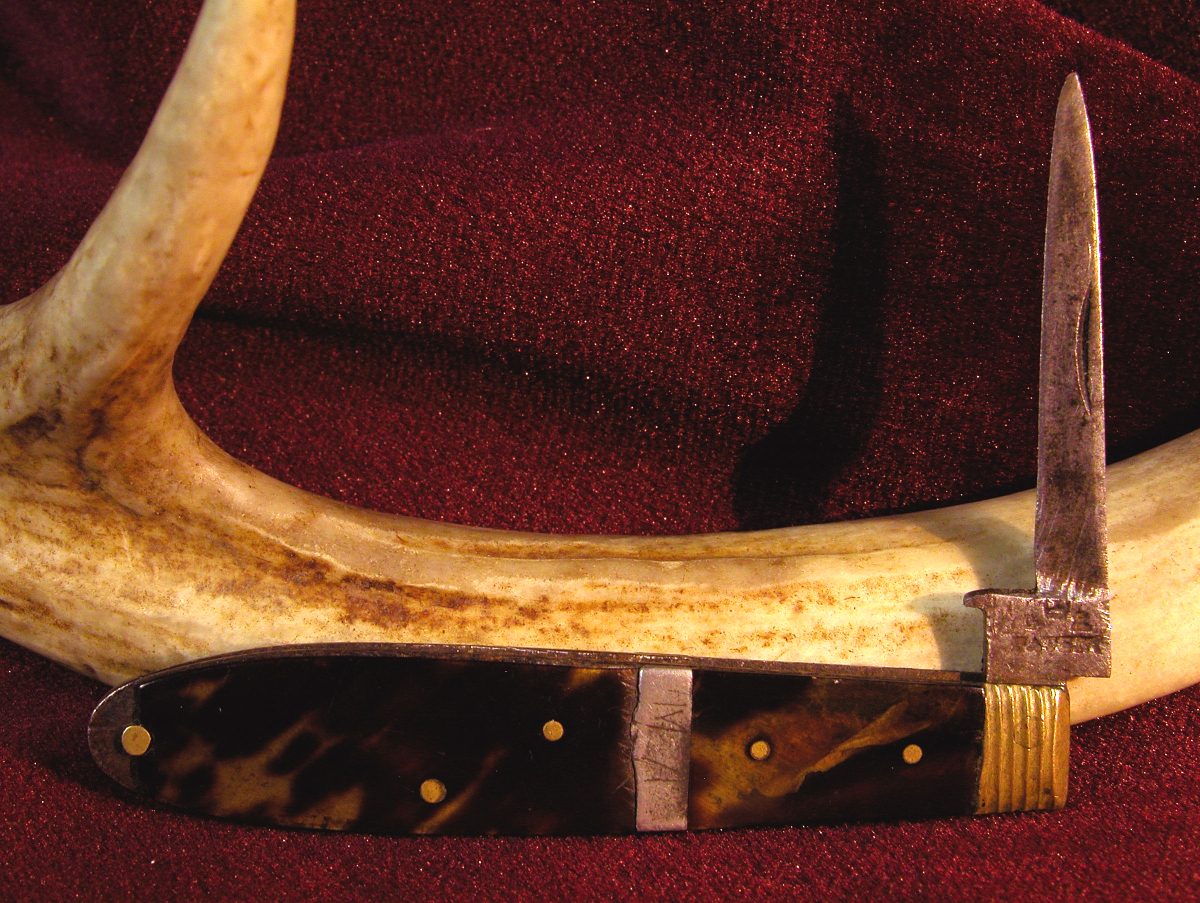

I do have a GcrownR offset - my oldest knife and that is 1820-1830 and probably Rodgers made from my understanding - guess that is the "R" - so are all WcrownR, VcrownR and even WcrownR all made by Joseph Rodgers?? That was never clear to me....

Gunsil
Posts: 3081
Re: Rodgers Quill Knife
Post by Gunsil »
Lee, all the crown marked knives simply mean they had a royal warrant, that is that they were approved for purchase by the ruler at at the time for purchase for royal households and members. The R is not for Rodgers at all, it is for Rex (king) or Regina (queen). Joseph Rodgers was not the only cutlery firm with a royal warrant so the answer is no, not all crown marked knives were made by Joseph Rodgers. It wasn't only cutlery that had royal warrant marks, they can be found on many other items. G crown R knives can also be made after 1910 during the reign of King George V, although those made for export to the USA will have the England mark, but those not made for sale here may not have the England mark but will have the G R mark with the crown.

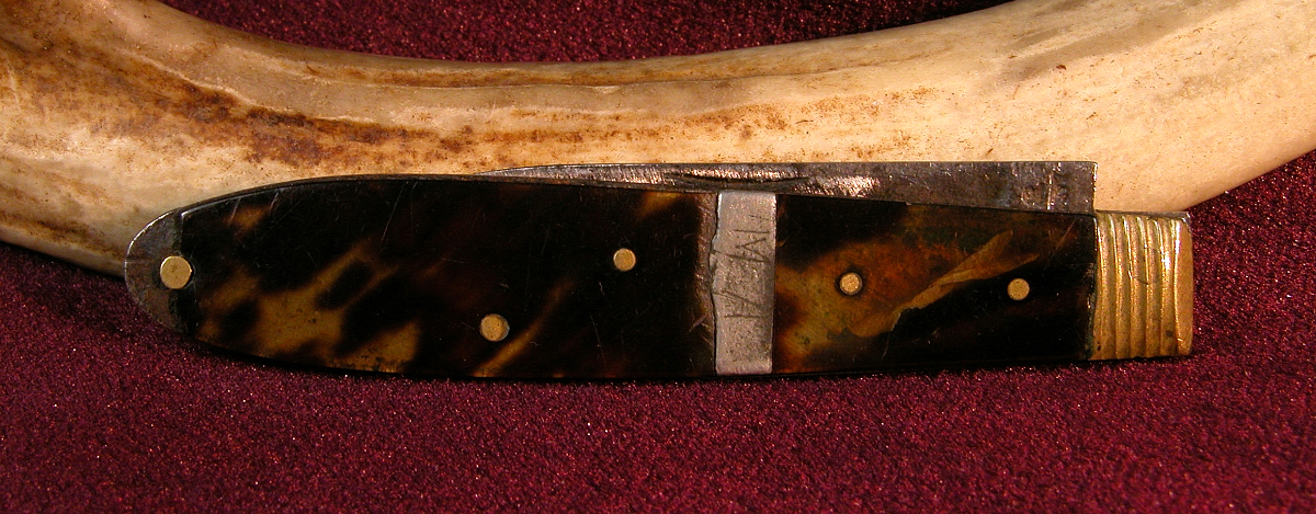

Thanks Gene ::tu:: ... However on my knife the GcrownR is offset and my understanding is that is an earlier mark rather than later because of the offset nature...
Not great photos from long ago but here's the GcrownR knife...

Thanks KJ ::tu:: ... Just as an aside - I had information from a very trusted source with many years of knife collecting that the GcrownR quill knife of mine above was Rodgers and the "elegance" of it (tortoise, sterling silver band and what is believed to be a gold plated bolster - perhaps brass but certainly appears to be gold to the few who have seen it in hand) certainly suggests Rodgers to me as well... The VcrownR quill in which I showed the tang stamp above has carved natural "material" was most likely Rodgers as well but that is just my opinion and never actually delved into it further - here's that knife below: -
KJ - I think there is dating charts for royal appointments in Levines and the Houston/Zalesky books, not sure about Tweedale and although I have the latter book as well I haven't looked for a dating chart of royal appointments in it...
Lee

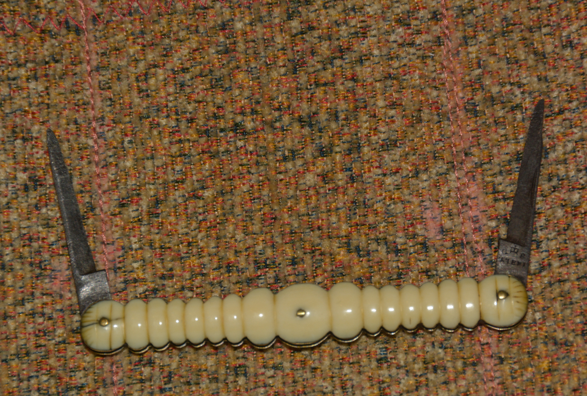

Heres my little G crown R patent quill knife ivory scales. The guys on the now defunct BB site reckoned it was George III
gerry

Sweet knife Lee. It is not the crown offset from the GR that means older, many later VR knives will have that. What makes it an older (or really old) is the fact that the stamps were hand carved rather than machine made as the later knives exhibit. What is the maker's name below the royal warrant mark??

Gene - I wish I knew what the marks were below the royal warrant mark and I wonder if the GcrownR is a carved stamp given the look (thats a new one for me as being carved so not even sure what to look for though the VcrownR knife no doubt looks to be stamped). I played jeopardy with the missing letters for a long time due to the wear on the stamp, and even had some help from smiling-knife & a few others but just can't make it out. Given all that - For the GcrownR it looks like "Fatery" ::shrug:: and under the VcrownR it is no doubt jeopardy at its best so here is what I see with options - ? R ? (maybe a P R ? - maybe M R ?) and under those letters W E I ? (at least one more letter - maybe 2) OR W L L OR W I L OR WEL.... Hows that for confusing :shock: :lol: :lol: .... My feeling is that the knives may have been made for a retailer and perhaps those are the stamps - but just don't know.
Post-Edit - Forgot to add that if it is not a maker and in addition to the possibility of a retailer than perhaps it was made outside of Sheffield - maybe London, Birmingham etc.. but I am not aware and really don't know if any royal warranted makers were located outside of Sheffield...
Lee
