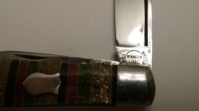

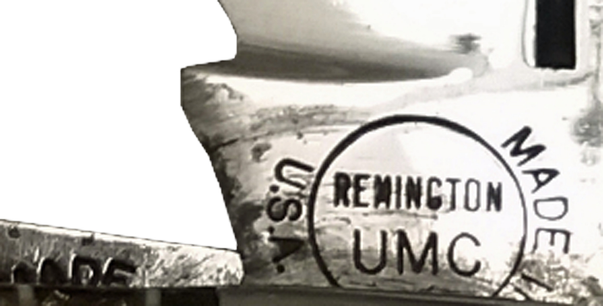

I picked this one up today but I'm questioning the tang stamp. The "UMC" letters are larger than the 'REMINGTON" letters. The other Remingtons I own the letters are the same size. Is this tang stamp authentic? Thanks,

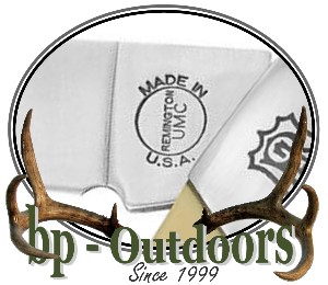

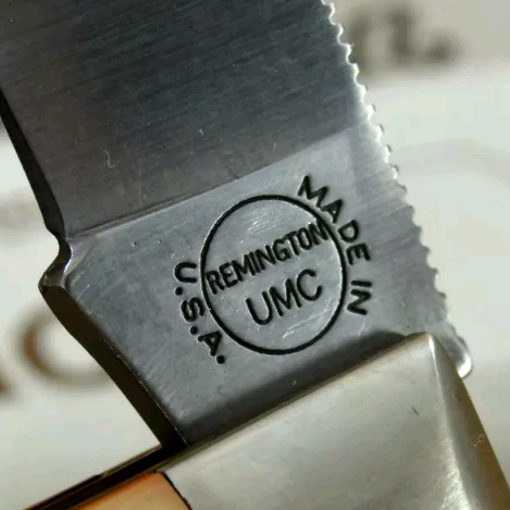

I don't know the answer, but check this out: http://www.bp-outdoors.com/knife_brands ... nives.html
Maybe your knife is newer?

Ah, maybe that's it... thanks. Can anyone confirm TwoFlowersLuggage's suggestion? Any other opinions or explanations?

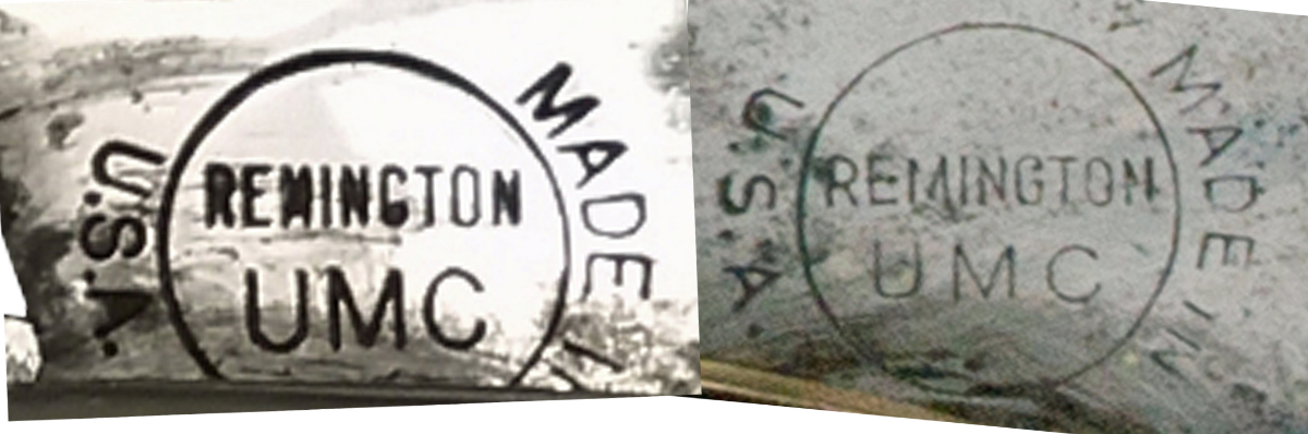

Dennis, I can't comment on what the size of the letters might indicate. I cropped the stamp and enlarged it significantly in the photo below. To me, the stamp looks like it is original to the blade - I don't see any evidence of "tampering". From what I can see of the knife it looks old to me. I don't see anything blatant that would give cause for concern.
I included a side-by-side comparison with a stamp for a RS3333 that was handy. The blade tang on the RS3333 is much larger than the knife you are asking about so the lettering on the knife you are asking about probably is more "scrunched together".

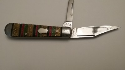

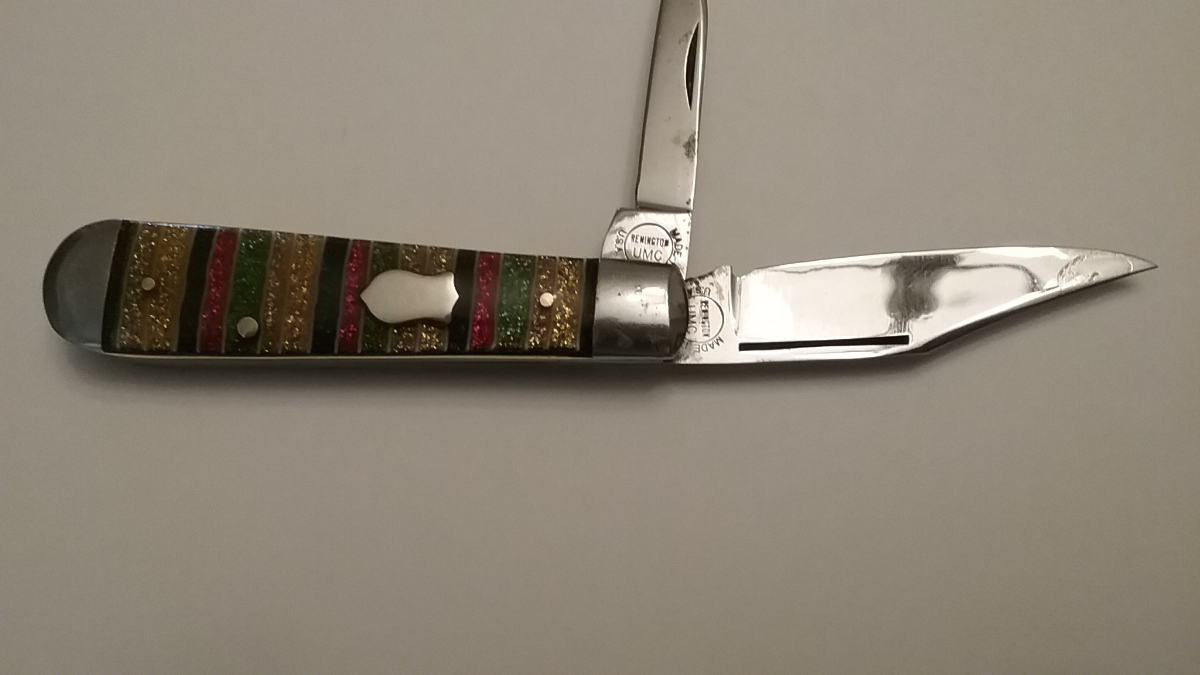

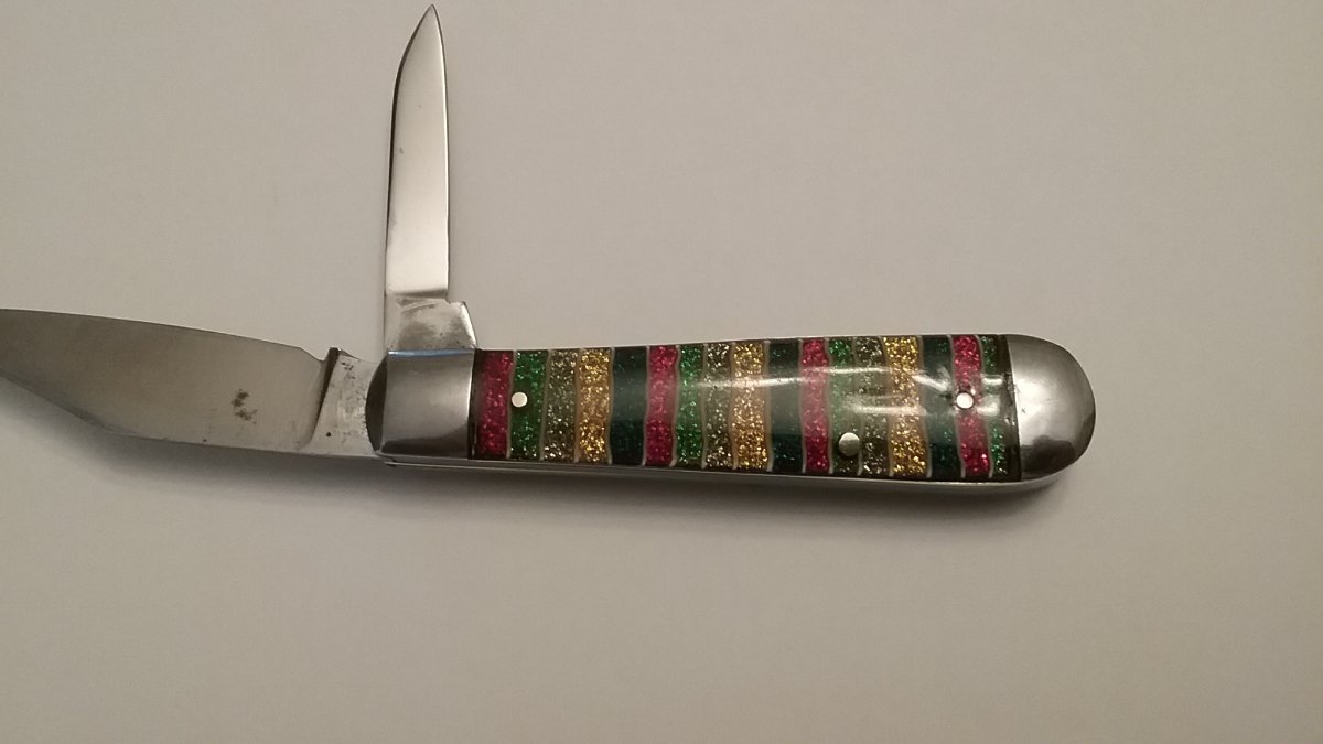

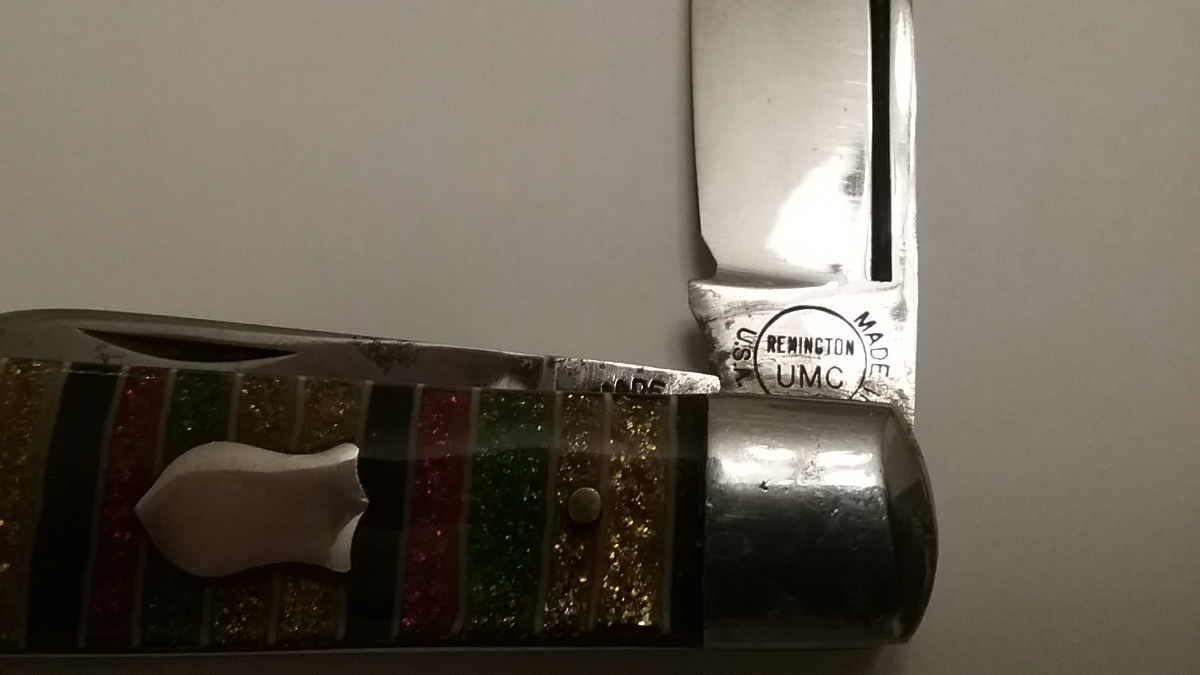

Here are some full knife photos Peanut.

Imo by looking at the pictures your knife gives me many concerns. The main blade should have some kind of swedge on it. Choil doesn't look like a Remington choil. The pull doesn't look right (to fat). I've seen many Christmas tree knives but not any striped that Remington made. Again only my opinion. They did a lot of things I haven't seen.

Thanks espn. What is your opinion on my original question? Does the oversize "UMC" exist in legitimate vintage Remingtons? (Per the photo TwoFlowersLuggage provided we know it exists in modern ones.)
Dennis
espn77
Posts: 3576
Re: Remington Tang Stamp Question
Post by espn77 »
I think the stamp resembles the modern erra stamp.

peanut740
Posts: 8123
Post by peanut740 »
I'm with Keith,not an original Remington.

did your new friend give any background on where & when he acquired the knife?
I asked him today. Best of his recollection he acquired it quite some time ago from another collector. Perhaps in a trade he thinks.
A Google search turned up a photo from a 2015 eBay sale with the identical handle pattern and shield. Only the title was available and not the entire listing and it was titled "Old Candy Striped Pocket Knife Antique" and it sold for $32. The body of the knife and the blade configuration was different but the handles were exactly the same. So perhaps this was a cheap knife re-bladed with fake Remington blades. Too bad, as it has pretty handles, brass liners, a solid feel, and sharp blades with great snap. A new one for EDC rotation I guess.
