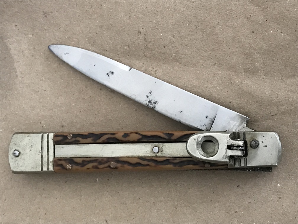

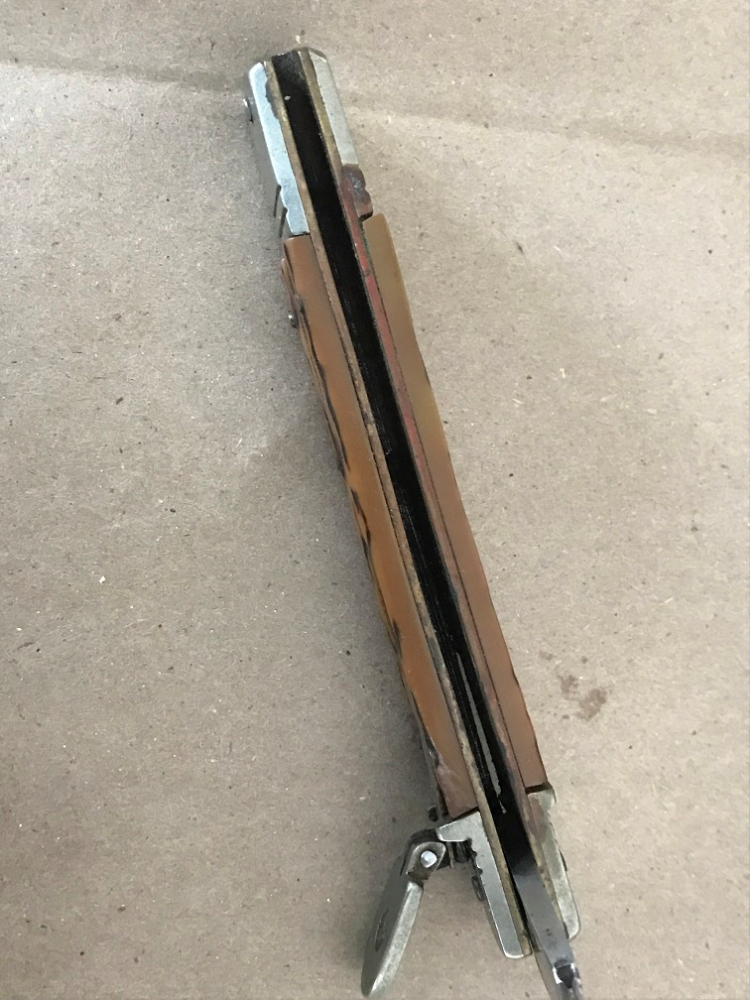

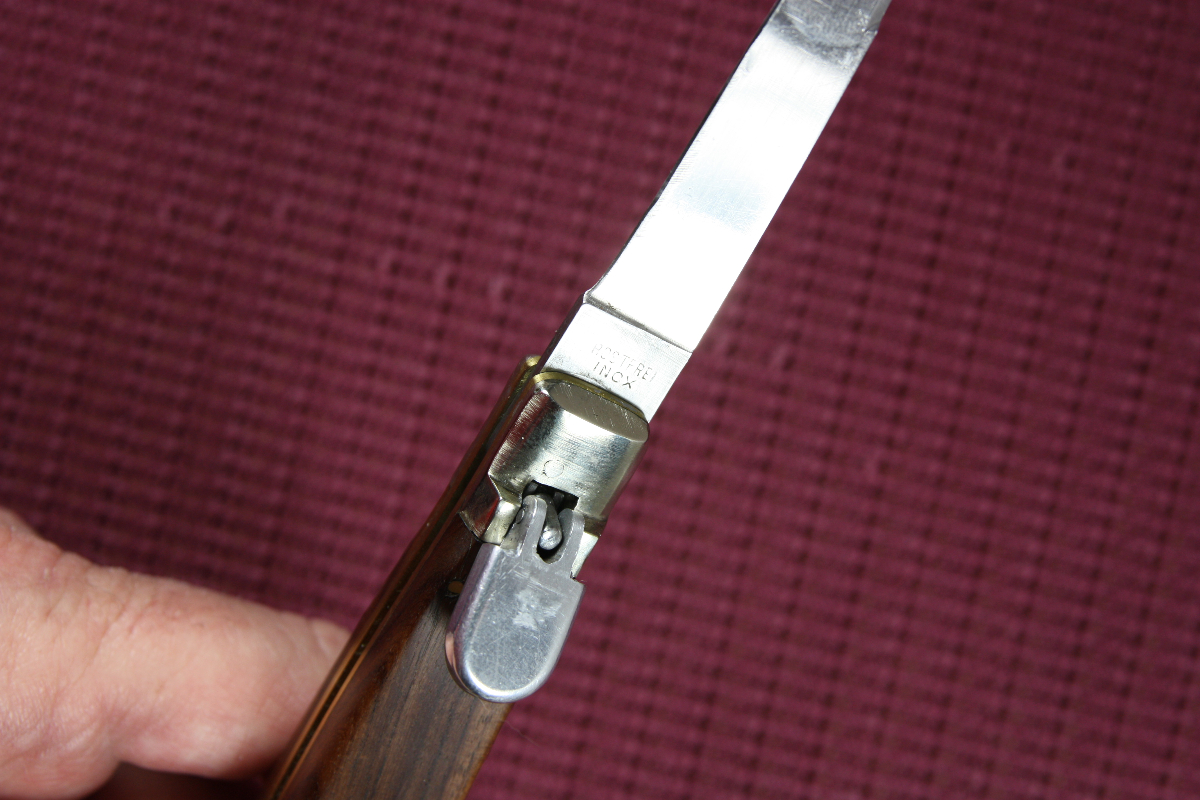

It's only marked INOX. The blade is stainless (hence the stamp) but the backspring is high carbon. The kick spring is broken and the blade tip is slightly bent. Scales appear to be plastic. It's very loose.
Maker? Value? Worth sending out for repair or home brew it? I have some ability and tools to rebuild it but don't want to ruining it if for some reason its valuable.
No name lever lock - what do I have?

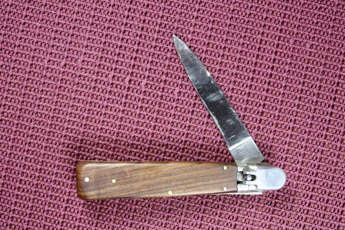

I picked up a similar one a year ago a our local flea market for $1. It too had a broken spring like yours. I was not able to find out much about it. The markings on mine were "Rostfrei-INOX" which means stainless steel blade. Mine had plastic handles with a bullfighter scene on them, which might make one believe it is of Spanish make (or the real MFG wants you to think that). If no one is proud enough to put their name on a knife when it is new, then it is difficult to find out later. These are not of very good quality and thus not worth much, even if not broken. I fixed mine up as a lockblade, but I don't consider it safe to carry in my pocket as the latching mechanism is very worn. I rehandled it with Bocote and made a new release button from aluminum, total overkill for this junker, I did it just for practice when I was starting to work on knives. If I was you I would just "tinker" with it.

Tinkerer-
Your knife was made in Maniago, Italy-probably in the 1960s. The handles are celluloid.
It is basically a copy of a German Weltersbach pattern.
While it's not worth a ton of money, I don't recommend home-brew repairs. The handles should be replaced-as they will deteriorate and ruin the knife.
The spring is a fairly easy replacement-as are the scales, and the knife would be tightened up during the repair.
