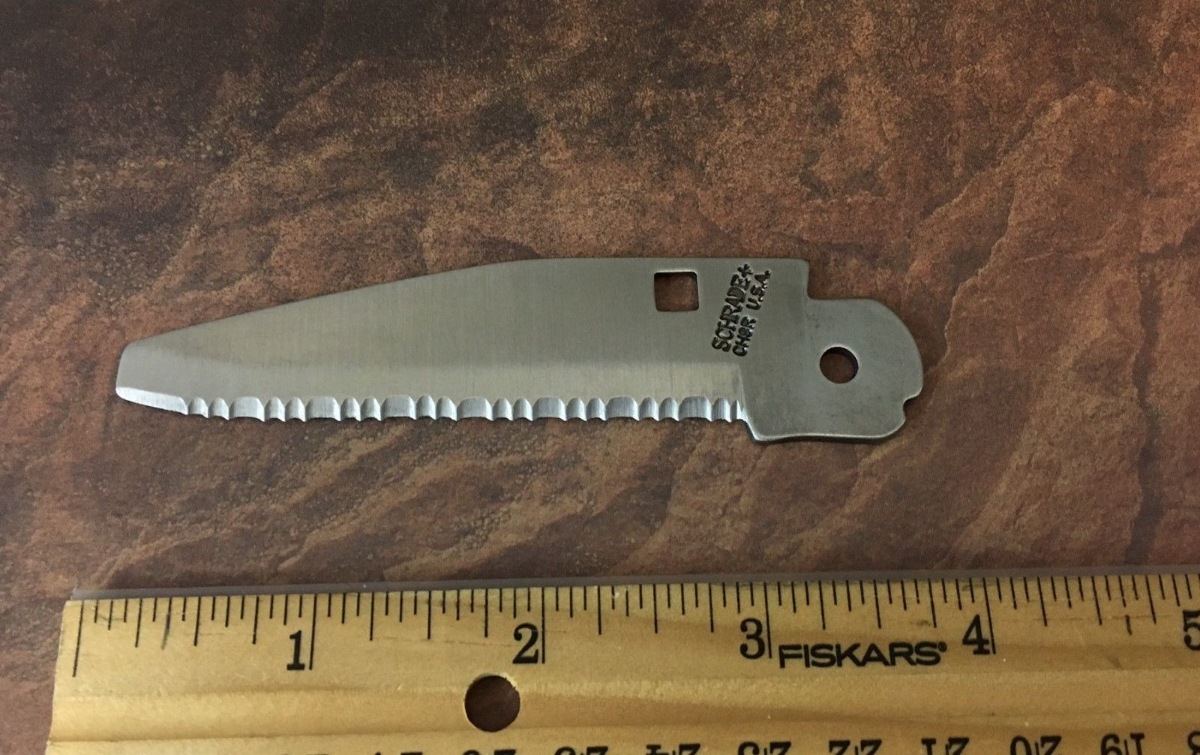

On eBay, there are fully serrated, blunt tip "rescue" blades marked CH-9R being sold as Ellenville leftovers. The "CH" stamp would denote it as a member of the Cliphanger family. Our research page on the tactical Schrades doesn't mention a thing on the CH-9R.
Was this knife ever sold by ISC, or was it one that never made it? I also see dagger blanks sold as being "Schrade", so those might also be that Old Timer dagger that was nonexistent.
And a dumb question--will these fit in an existing Cliphanger frame? It looks as though they might fit in a CH-7. I'm thinking about putting it in a secondhand Cliphanger frame, as those aggressive serrations will slice through just about anything.

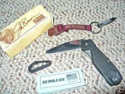

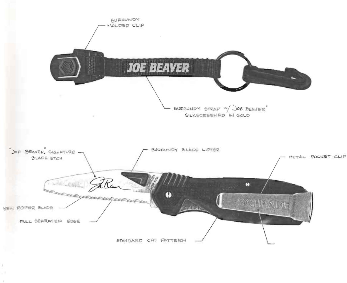

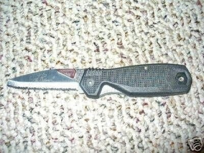

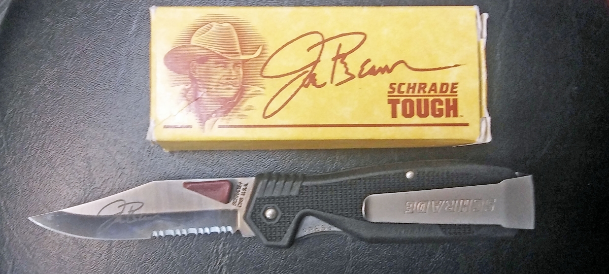

The only CH9 knife that I know of is the Ch9JB Joe Beaver knife. Also not mentioned in our reference list. It was a limited edition for the PRCA World Champion Calf Roper. The serrated blade being handy for cutting rope should the roper get into trouble. Many ropers carry such a knife. (mostly Spyderco) I, regrettably, had a chance to buy one in a western wear and tack store in 1998 and didn't. Now all you have to do is figure out what or who the 'R' stands for on that blade. Maybe rope or roper? Maybe someone's name? Or 'Rescue' as you suggested. Oh, and it was the larger size Cliphanger frame, as I remember. Dimensions of the blade in question should confirm or deny my foggy memory. I can't say if there is any modification to the frame to accommodate that blade shape. I have tried in the past to find pictures of the CH9JB and this was the best I could do. Don't know if any of this helps, but there it is.

- Schrade Joe Beaver CH9JB.jpg (112.85 KiB) Viewed 2921 times
- Schrade Joe Beaver CH9JB (2).jpg (115.55 KiB) Viewed 2921 times

That does indeed appear to be an Imperial Schrade, U.S. made blade. It should slip into a Clip Hanger frame of the proper size.

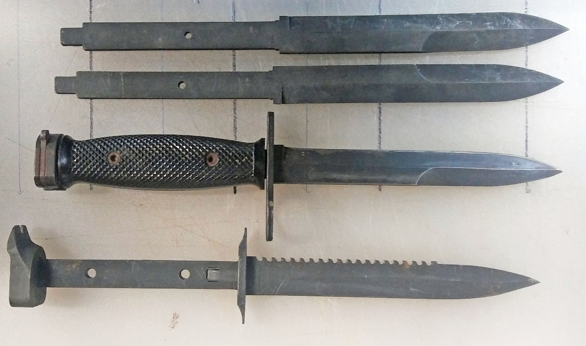

In this picture below I have shown some of the M-3 bayonet blades I have and a complete M-3 bayonet.
At the bottom of the picture is the Imperial M-73, just the blade, guard and the pommel without handle.
My M-3 blades are slightly different on the end than the blades this seller has for sale. I don’t remember whether my blades were supposed to be from Camillus or from Schrade. After they’ve set around for a few years you kind of forget unless you have them labeled, which I didn’t. I think sometimes the unground blanks, especially when they haven’t been stamped, set around warehouses and get moved around a few times and what may have been mostly from Schrade, partly from Camillus and partly from somewhere else all get labeled as Schrade when they are put on the market for sale. At that is my theory that it's the best explanation I have to explain why blades that were not made by a certain factory are suddenly attributed to having come from said factory.

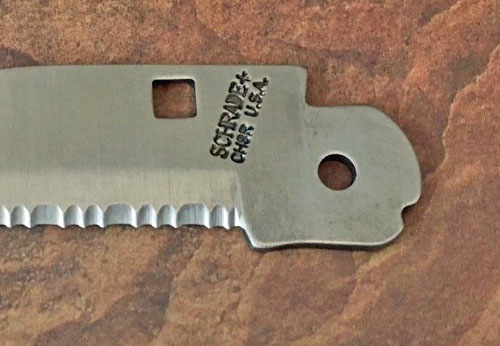

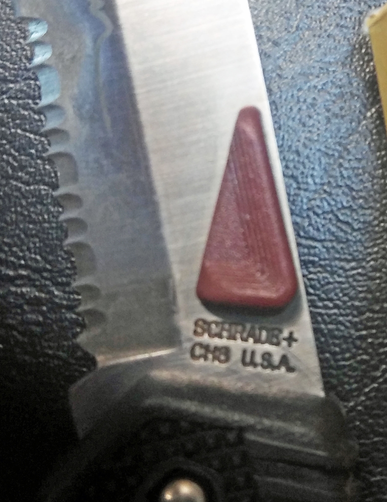

As regards the CH9R,I think the seller miss-read the tang stamp, I think it’s a CH8R. Their photo isn’t high resolution but I was able to Photoshop it a little bit and see the little more detail. It’s hard to be 100% certain from such a low resolution photo, but I think it’s an CH8R. This my CH8, Joe Beaver, and in the tang stamp picture you can see it is difficult to tell for sure whether it is an 8 or a 9.

'On eBay, there are fully serrated, blunt tip "rescue" blades marked CH-9R being sold as Ellenville leftovers...Was this knife ever sold by ISC, or was it one that never made it?'
Yes, Schrade did make and sell the CH9R, as I bought two in the 1990s for use in whitewater canoeing, and gave one to a friend. I still have the other. It has a 3in. fully serrated, blunt tip 'rescue' blade.
