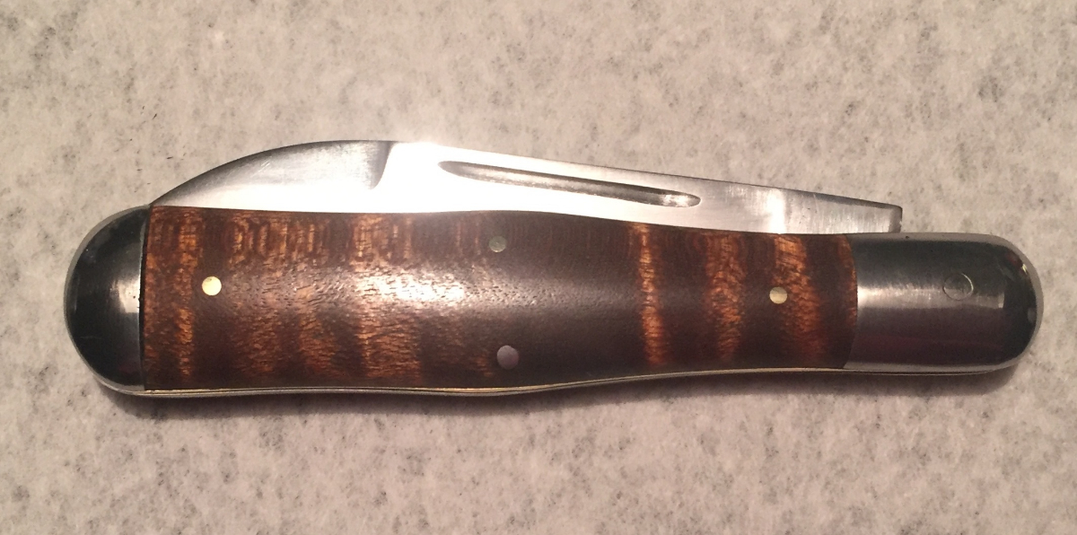

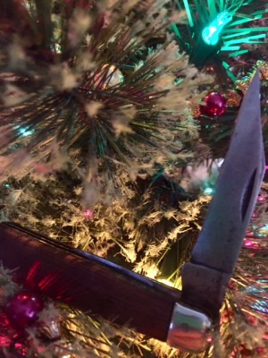

I handmade one for my son's Christmas
- Meridian_Mike
- Posts: 5041
- Joined: Mon Apr 21, 2014 8:36 pm
- Location: Mississippi

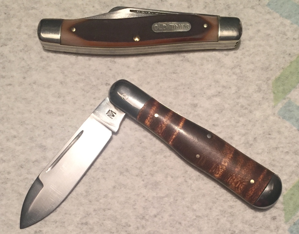

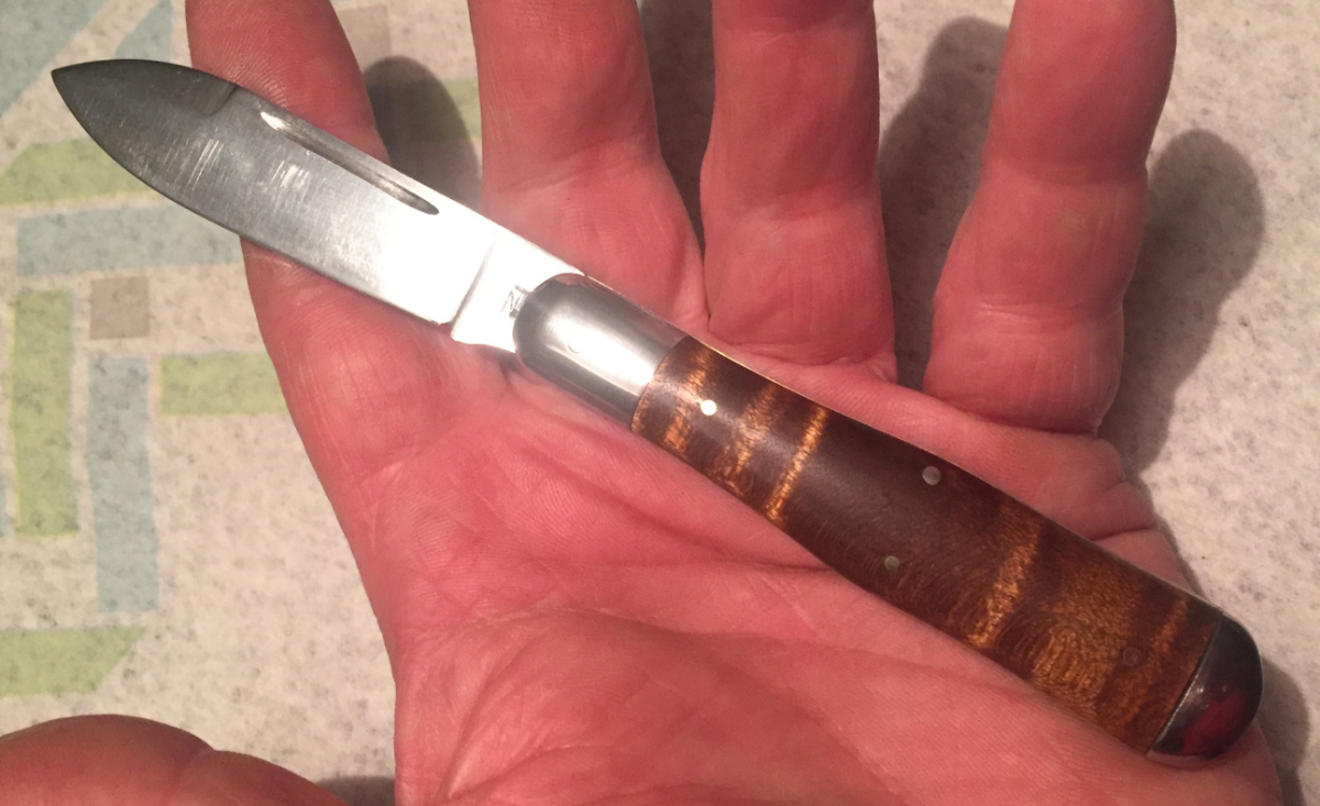

I'm getting better but I'm still not there. This is my best one so far. I guess it is acceptable....
I cut up a masonry saw blade for the blade and spring. The scales are a piece of curly maple that came from the dump. I took a knife apart that was in sad shape and used it for a pattern to make my parts. Funny how proportions work out a LOT better when you have a GOOD PATTERN to go by.....LOL.
Here she is.... Be gentle....
(Not the Old Timer.... the coke bottle below it....LOL)
The wood on the handles is a sweet piece of curly maple that was a REJECT(?) from the Peavy guitar factory that used to be here in Meridian. I mean the grain MOVES when you turn it. Beautiful wood for sure.

Thanks everyone! I am learning.....
I may never get to where I am satisfied with my end product but I enjoy trying!

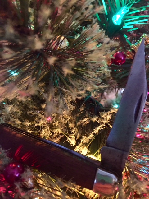

p.s bought this knife at resale shop
Very,very nice. The best Christmas presents are the ones that are handcrafted. We
hung a few ornaments on our tree this year that were made for us by adults and
by our grandchildren.
Hope I get a handmade knife this year!
Bob

Thanks Doc... I've been studying blade styles. Some of the way it turned out was sort of a "happy mistake" as Bob Ross would say...... I am pleased I guess.

Well, I have always subscribed to the "power tools help you make mistakes QUICKER" theory.... Yes, I did use power tools.
I have a 1" wide belt sander that eats up belts rather quickly. I have one of the jigs everyone seems to be using that is a piece of steel angle. I clamp my blade to the side of the angle and sand away everything that doesn't look like a blade.
I also have a filing jig that I use sometimes.
Yes, I have been practicing up on my heat treating too. I use the "magnet method" of heat treating. If you have a magnet close by, you heat the metal until it turns "non-magnetic" and then quench it in burned motor oil.
I don't have a dedicated oven..... yet..... BUT I learned that if I have a good fire in my ole wood stove, I can get the metal up to temp in it.
There is several youtube videos out there that seem to have proven heat treating methods.

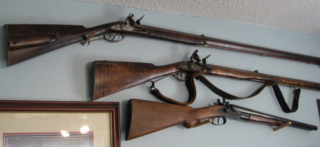

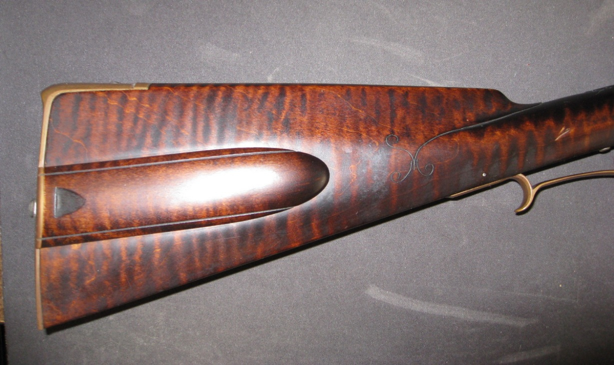

Man yeah.... I have a couple I have built. I got a stock from Jim Chambers many years ago. That stock has some KILLER flame.Delmar Morgan wrote:Looks good to me. Like that curly maple , that's the type I like flintlock muzzleloaders , makes me go
Check out the butt stock.....
58 cal. flintlock.
FUN...
