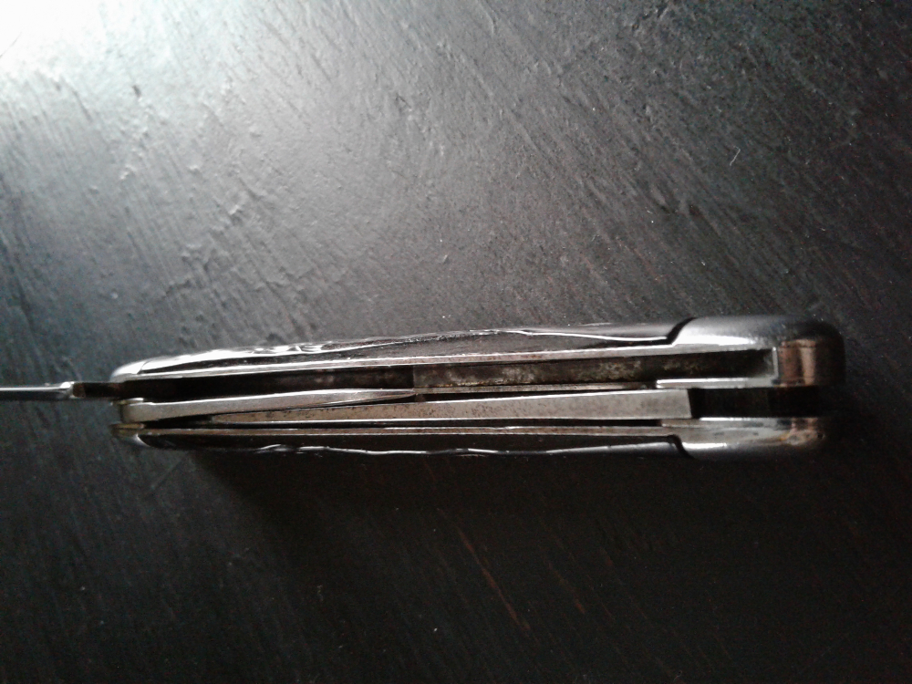

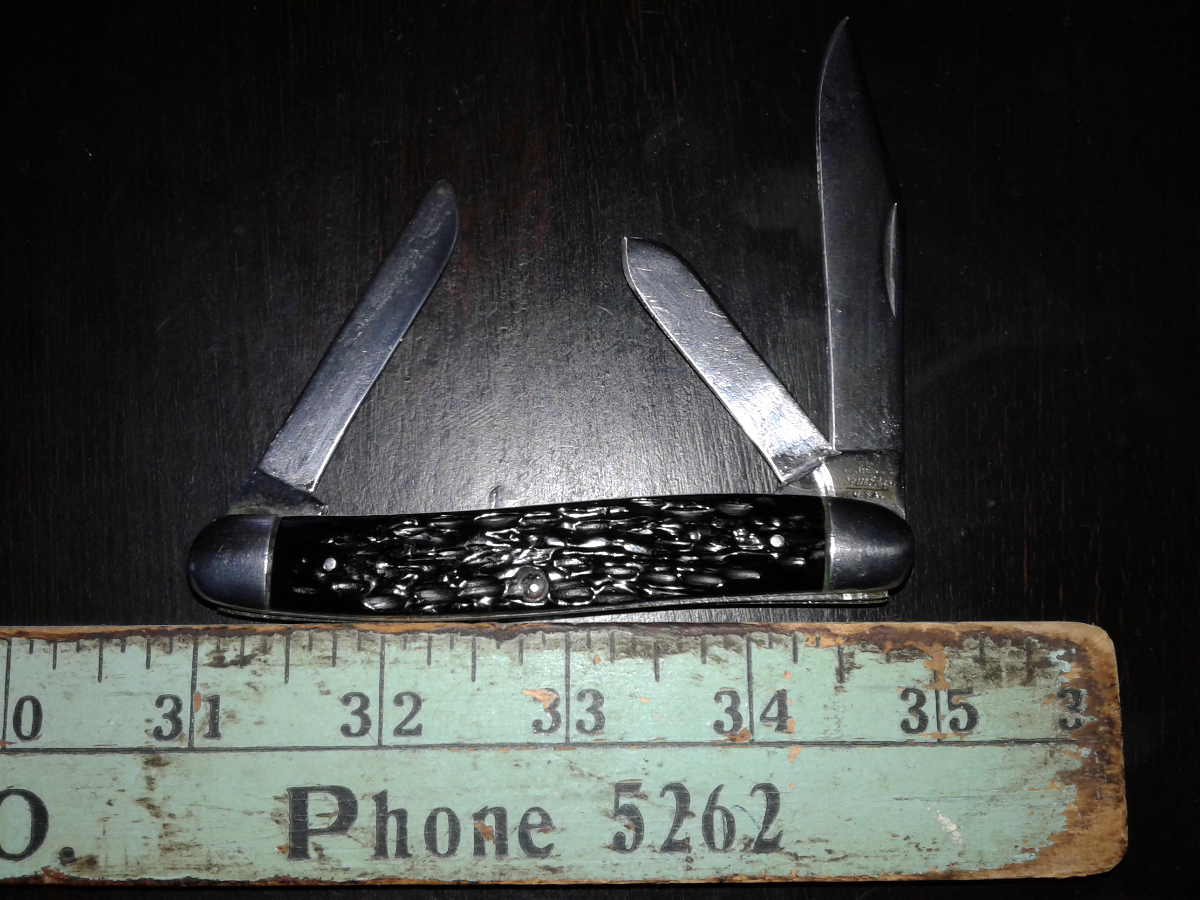

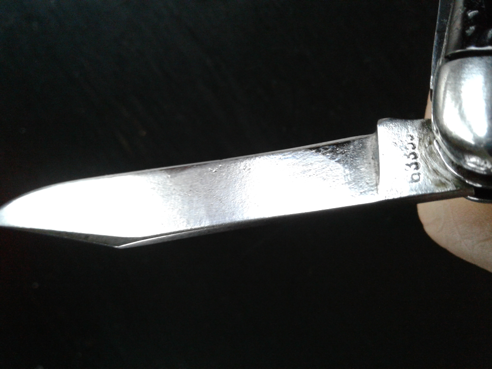

Good morning,
The pattern number on this large stockman is making me question what this actually is. It has the tang stamp normally associated with the 1916-1939 period, but the the 3rd digit of the pattern, I believe is a "3", and this clearly has an all steel construction. Although the stamping are heavily worn, I believe it to be a 63355. The last 2 digits are barely readable. I understand a "0" would normally be used after the 3rd digit, but I'm not finding anything on a 633055 either. The mid sized spey blade and the mid sized spear or pen, along with the clip are unusual. Anyone have a list of pattern numbers or access to them? l9ok

I need to know the length of the knife, closed. Your photo suggests 3 3/4". Is that correct?
Given the black composition handles, the date of manufacture would have been circa !939 through 1945.

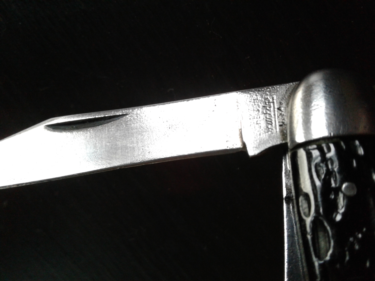

Re: Robeson pattern numbers
Happy to see your response, Charlie. I measured it at 3 15/16" oal. The main clip, the only blade with stamping, is 2 7/8" from bolster to tip. The spey is 2 1/4". The spear or pen blade is 1 7/8". The tang stamp is ROBESON/ SHUREDGE(script, angled and underlined)/ U.S.A.. The reverse pattern is stamp is definitely 633--, with the last two numbers appearing to be 55. The top half of each number is barely readable. Additionally, I see no brass or nickel silver in it. Bolsters, liners, and pins are all steel. The tang stamp confused me as I believed it to be of the years you suggested, but the stamp is earlier. Being all steel, one would assume it's a wartime knife?
