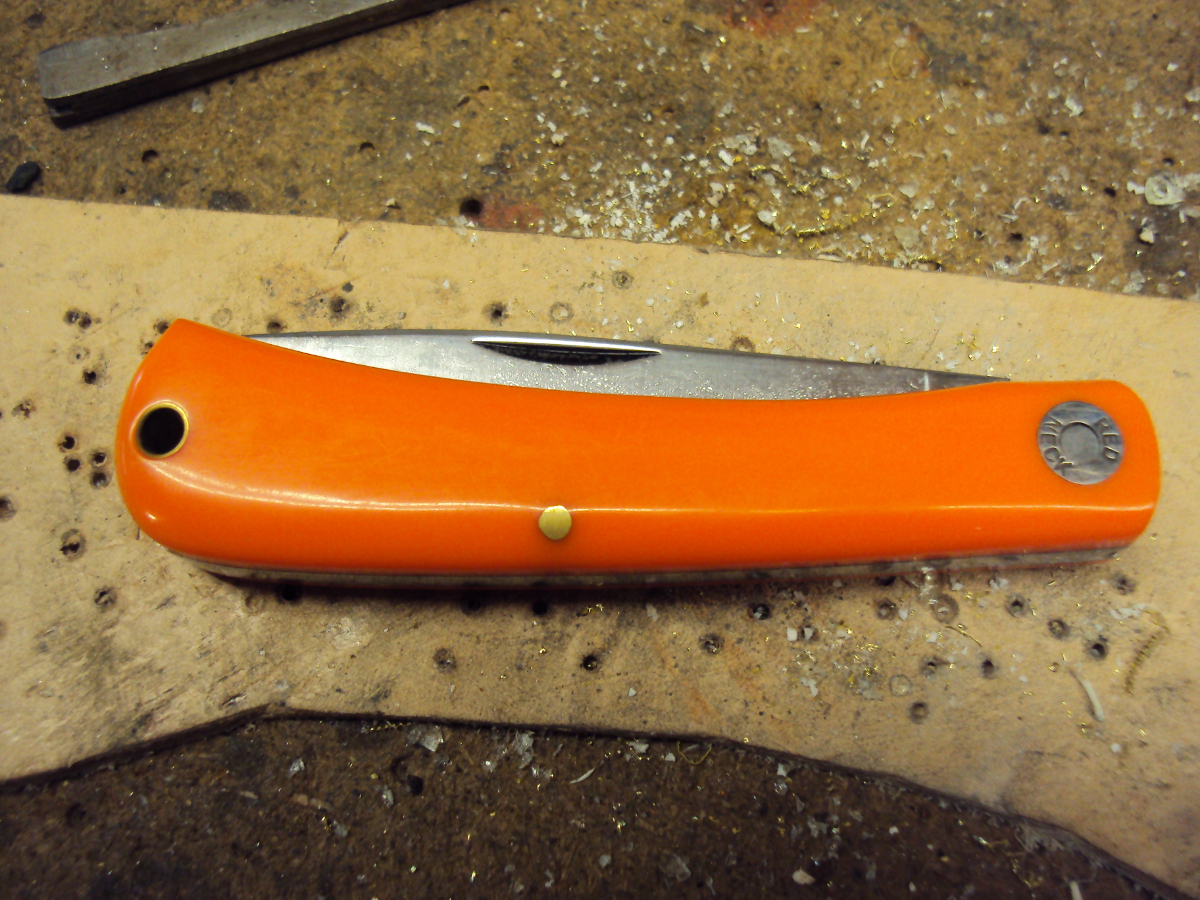

This one had some ugly orange covers, stag again for the recover...

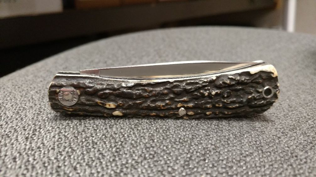

Out of curiosity...Does the lanyard piece, go through the base of the backspring...or does the backspring "hook" over the top and around the lanyard piece? I've just recently encountered my first old knife, where the backspring only has the one pin...and "hooks" around the end pin. What holds the lanyard piece within the liners? Solder? Epoxy? You don't "peen" those do you?

I am as curious as you about Glenn's method because they are not easy to with my method...

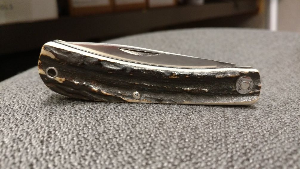

The spring does not have a hole, just a notch that rides up against the tube. install your "spring" pin first, it doesn't have to be all the way tight, just mostly snug.Doc B wrote:That's beautiful!!!!
You've found some very nice stag there!!!!!![]()
The tube is held in place mainly by the tension of the spring. I do not use epoxy on the tube. I end up flaring the ends of the tube, that holds things nicely.
- Doc B
- Posts: 3700
- Location: San Antonio
Re: GEC 71 bullnose
Interesting...thanks for the info!!!glennbad wrote:The spring does not have a hole, just a notch that rides up against the tube. install your "spring" pin first, it doesn't have to be all the way tight, just mostly snug.Doc B wrote:That's beautiful!!!!
