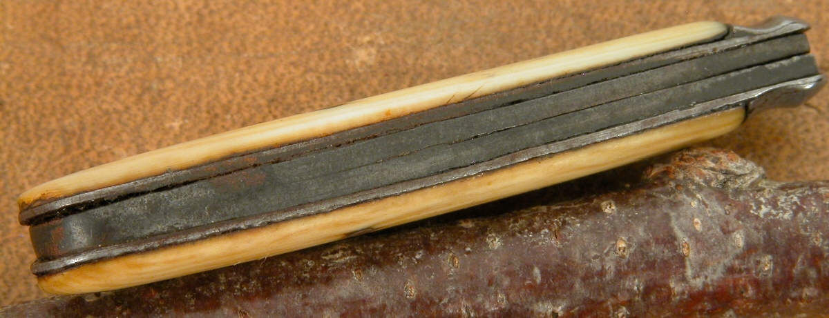

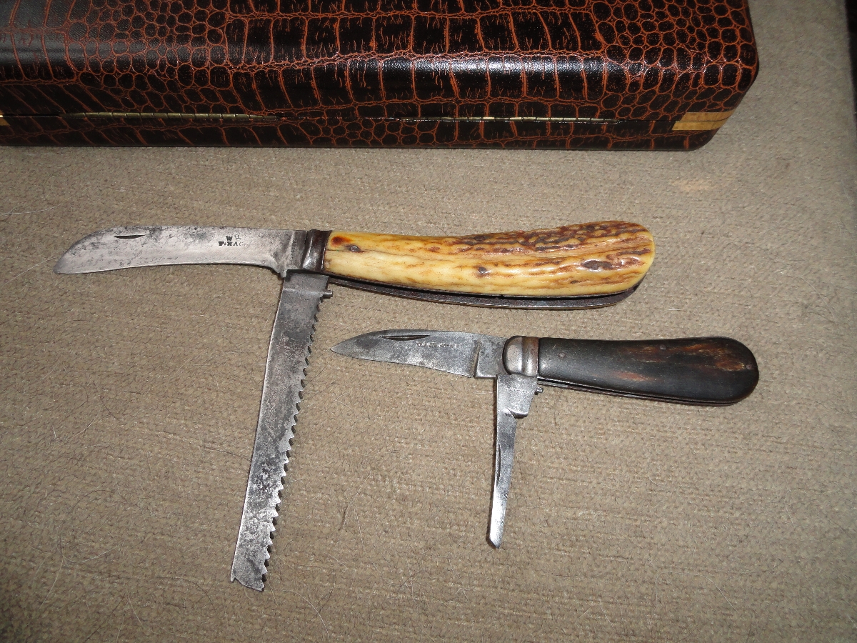

We've had a few discussions about true split back whittlers and I've never seen one, but I have two true split back knives which I've posted pictures of before. I thought I'd post one of the old pictures and another one I took to show the split better on the small knife. Both are stamped cast steel and show the marks of Cutlers to the King, but the maker is worn off. I would guess both are early 1800's from the readable parts of the marks and their construction. I would love to see any true split knives any of you have, and especially a true split back whittler. Mine are a hawkbill and a Wharncliff jack.____Dave

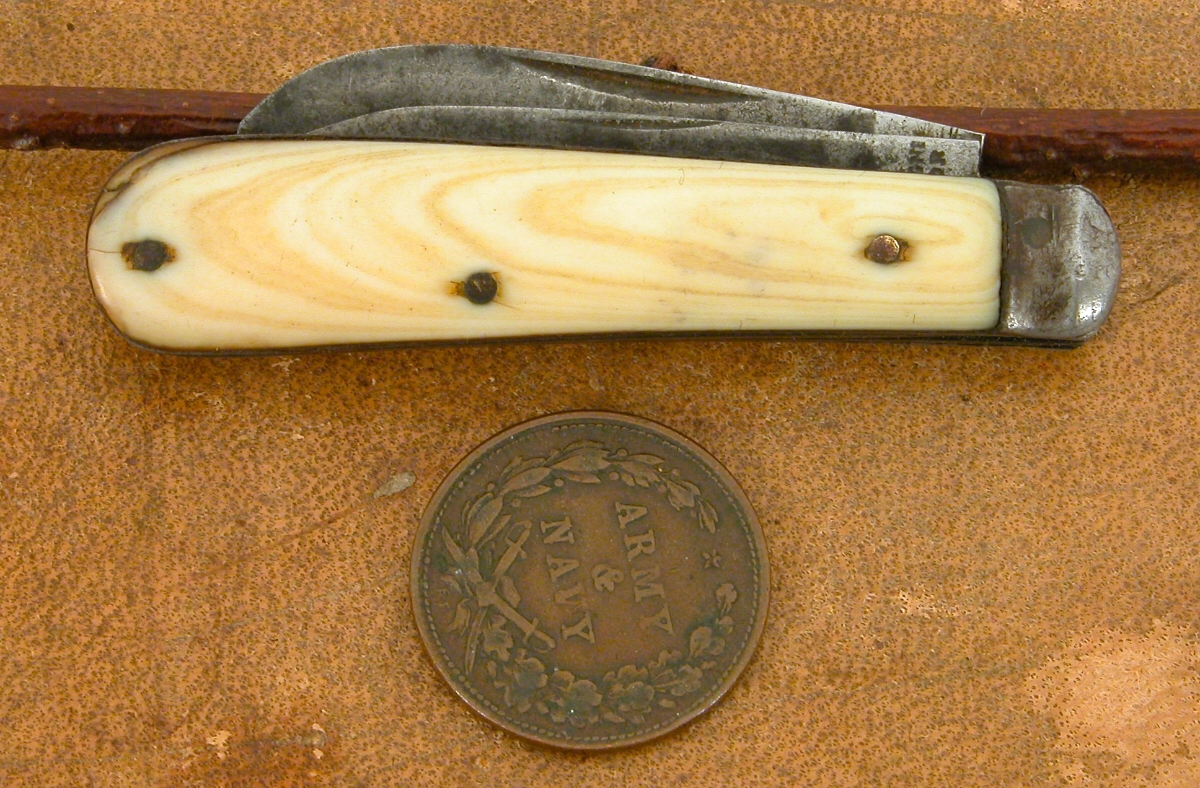

Re: True split back knives
Nice knives Dave and great thread to start

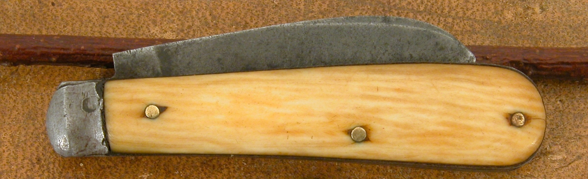

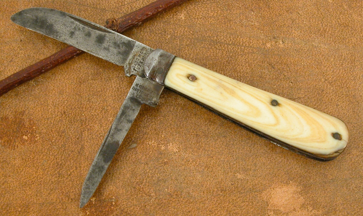

... as you mention I mostly hear about true split spring whittlers but never saw one - anyway here’s one I posted under “Old and Rare” thread....
This small 2 blade swayback ivory jack with rat tail bolsters is 2 1/8" and is a true split spring. All steel construction including liners and bolsters though the pins appear to be brass on the handles (not pivot pin) - no doubt much heavier in hand than one would expect for a knife at this size. On the mark side photo I included a penny sized 1863 Civil War token for relative size though I think this no doubt pre-dated the Civil War... I'm thinking based on a few things 170-200 years old or maybe more - early for sure. The knife no doubt has stove pipe or square kicks on both blades....
The knife is stamped "Gascoigne Superior" on both master sheep foot blade and pen blade. Gascoigne is a known British surname since the 12th century with French roots. Sheffield was not on the tang stamp and there is not a Gascoigne listed in Tweedale's directory. It is possible the knife was pre-1830 when Sheffield was not stamped on knives as of yet. However I did find an online directory from 1821 and again 1841 that had a Joseph Gascoigne listed as a cutler and spring knife maker in Attercliffe - Attercliffe is a northeast suburb of Sheffield. This is a strong possibility for the maker. The other noted Gascoigne was one of the partners which started Empire Knife Co (Thompson and Gascoigne)...
I am thinking the knife was possibly a desk knife given the size - possibly carried but not for larger utility at this size.

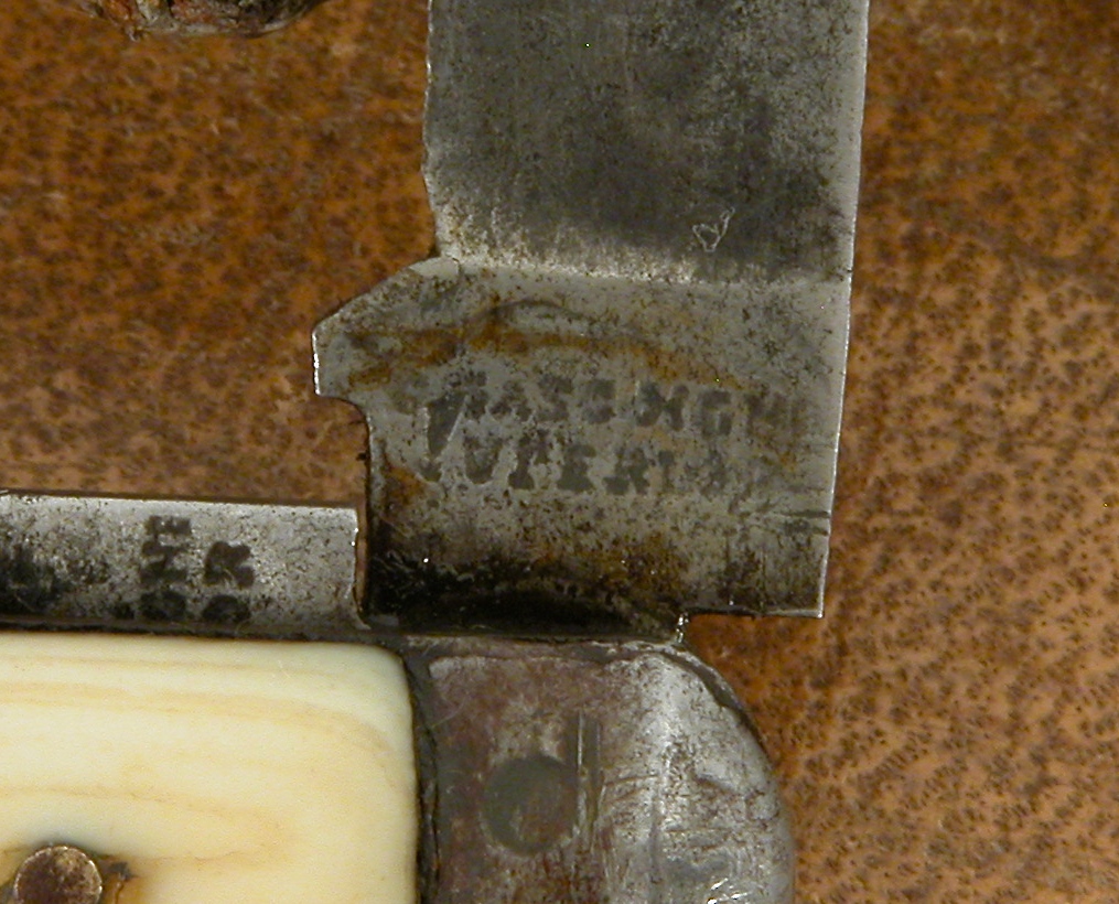

Thanks Lee. I sure wish I could see more of the stampings on either of my knives, but as we see from yours, any information is a little tough to come by. I hope this thread builds on what little we do know. ___Dave

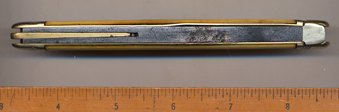

- Mumbleypeg
- Posts: 15713
- Location: Republic of Texas

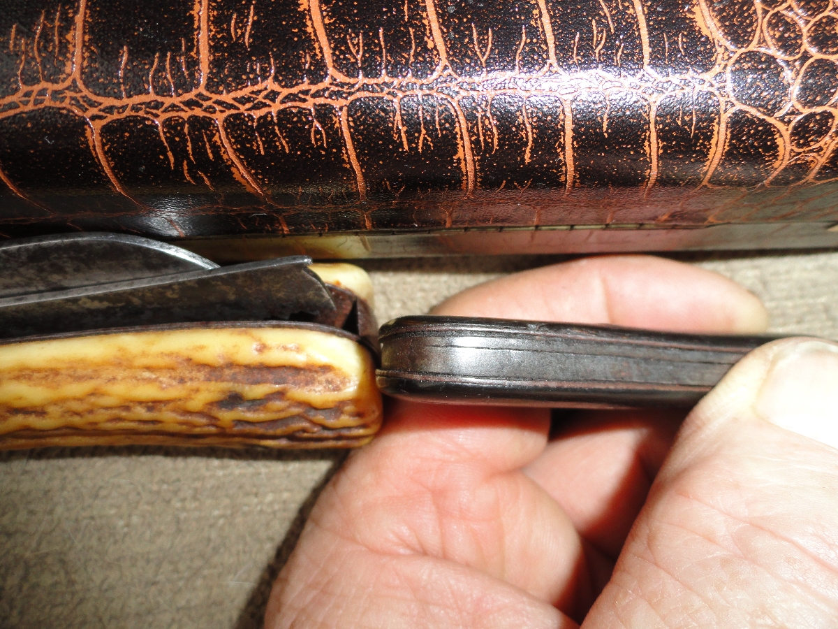

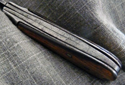

Here are a couple of pictures I’ve found and kept over the years, showing true split back springs. Not my knives, just some pictures I thought were interesting, may have been from other AAPK posts.

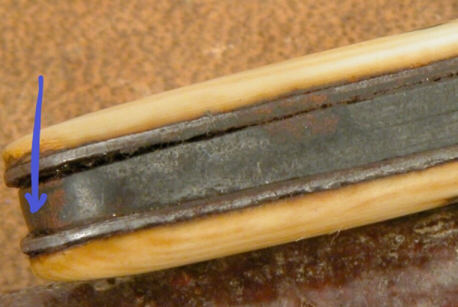

Mel - I’m not sure they were welded or forged together from 2 separate pieces - somehow I think they were split from one spring - I saw that line you highlighted on my backspring but on both sides of it there are no signs of 2 possible separate springs that were forge welded so it maybe a scratch (and in fact it doesn’t quite line up with the definite split) - I originally thought maybe they “scored” the single spring so it would split where they wanted but not sure that is the case... I looked with a high power magnifier... in fact the end of spring that wraps around towards the handle well shows it to be solid on the spring end and inside the well no signs of anything other than a solid single spring except where the definite split is located ..Dinadan wrote:Interesting idea for a thread, Dave! I was not aware that there were any split back spring knives other than whittlers. Those are very nice old knives that you posted as well as the one Lee posted. I am thinking that the springs were made separately then welded together by heating and hammering in the old blacksmith way. Looks like I still see the seam in Lee's knife. Very cool stuff and a tribute to the skills of the old time makers.
Thanks for posting those KenMumbleypeg wrote:Here are a couple of pictures I’ve found and kept over the years, showing true split back springs. Not my knives, just some pictures I thought were interesting, may have been from other AAPK posts.![]()

The example I posted (the bottom picture) must surely have started as two pieces, forged together on one end, then treated to create spring steel.
In my feeble mind I see no other practical way it could be done, especially given the technology available. On any attempt to create one by cutting from a single piece, the resulting kerf would leave create wider gap between the resulting two springs. Like the one example I posted. I believe that top picture is a good example of a sawed one-piece steel spring, with a brass piece inserted.
