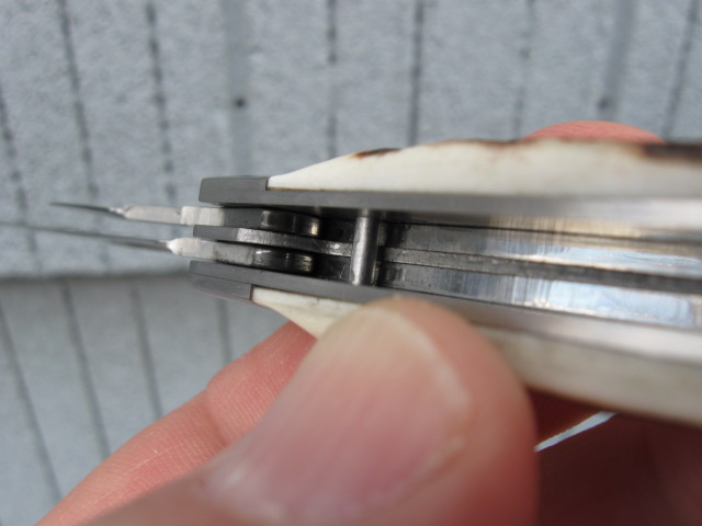

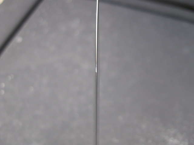

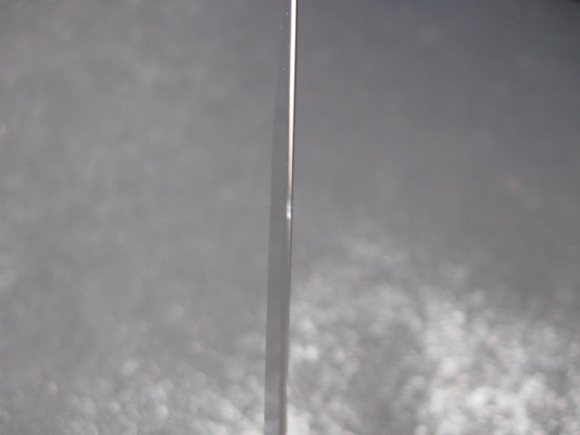

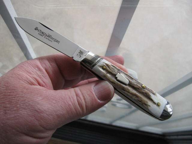

Ken, it looks like this. Just a small ding in the sharpened edge. It's easy to miss unless you are looking for it but it's noticeable when cutting certain materials. I cut a lot of shrink wrap at work and if I haven't already discovered the problem, I'll know about it then because the edge gets hung up on the shrink wrap.Mumbleypeg wrote:
Maybe I just don’t know what to look for.Anyone got pictures of this problem?
The knife above is this Schatt & Morgan #69 Jack.
Rick T.

Well I guess I've got it wrong all these years, thinking a strong mainspring was good thing. I guess I should throw out all my old knives that have alligator snap.

The tiny divot in the edge of an unsharpened blade does not occur if the spring is a bit soft or if you hold the blade to control closing force. This must indicate that some flex happens with a strong spring, otherwise the kick would stop blade before contact with the spring pivot pin.
It is not anything to worry about. I see it as normal for a certain percentage of slip joints; i.e. not a defect.

I do consider it a defect. The risk of blade rap should be taken into consideration by the manufacturer when designing the pattern. There are at least two manufacturers who agree and have done something about it.

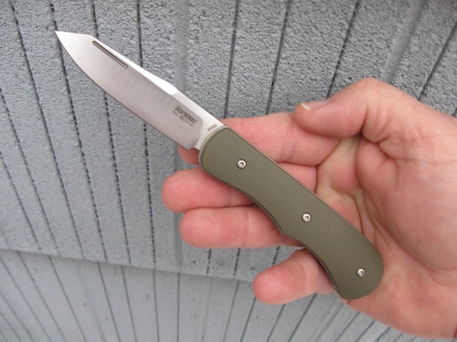

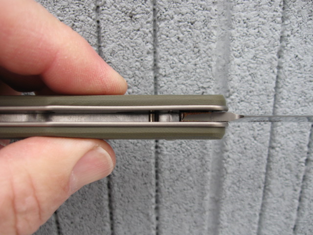

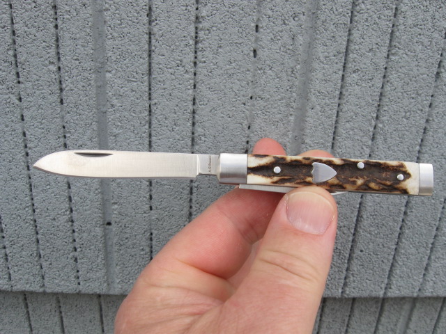

Both A.G. Russell and LoinSteel incorporate a Striker Pin to prevent blade rap. The tang strikes the pin which sits well above the backspring eliminating the risk of blade rap. It's as if they said "Like good snap but hate blade rap? Here, let me fix that for ya".
A.G. Russell Doctor's knife. Note how far above the edge the tang is. Still no blade rap because the Striker Pin prevents it. LionSteel Otnat. Same concept. These are obviously knives of a more modern variety but it's nice to see that the problem was recognized and resolved by these two makers.

RIck, I have that Dr.’s knife, I will have to look for that. Now I am going to be checking all my knives for that pin.Railsplitter wrote:I do consider it a defect. The risk of blade rap should be taken into consideration by the manufacturer when designing the pattern. There are at least two manufacturers who agree and have done something about it.
