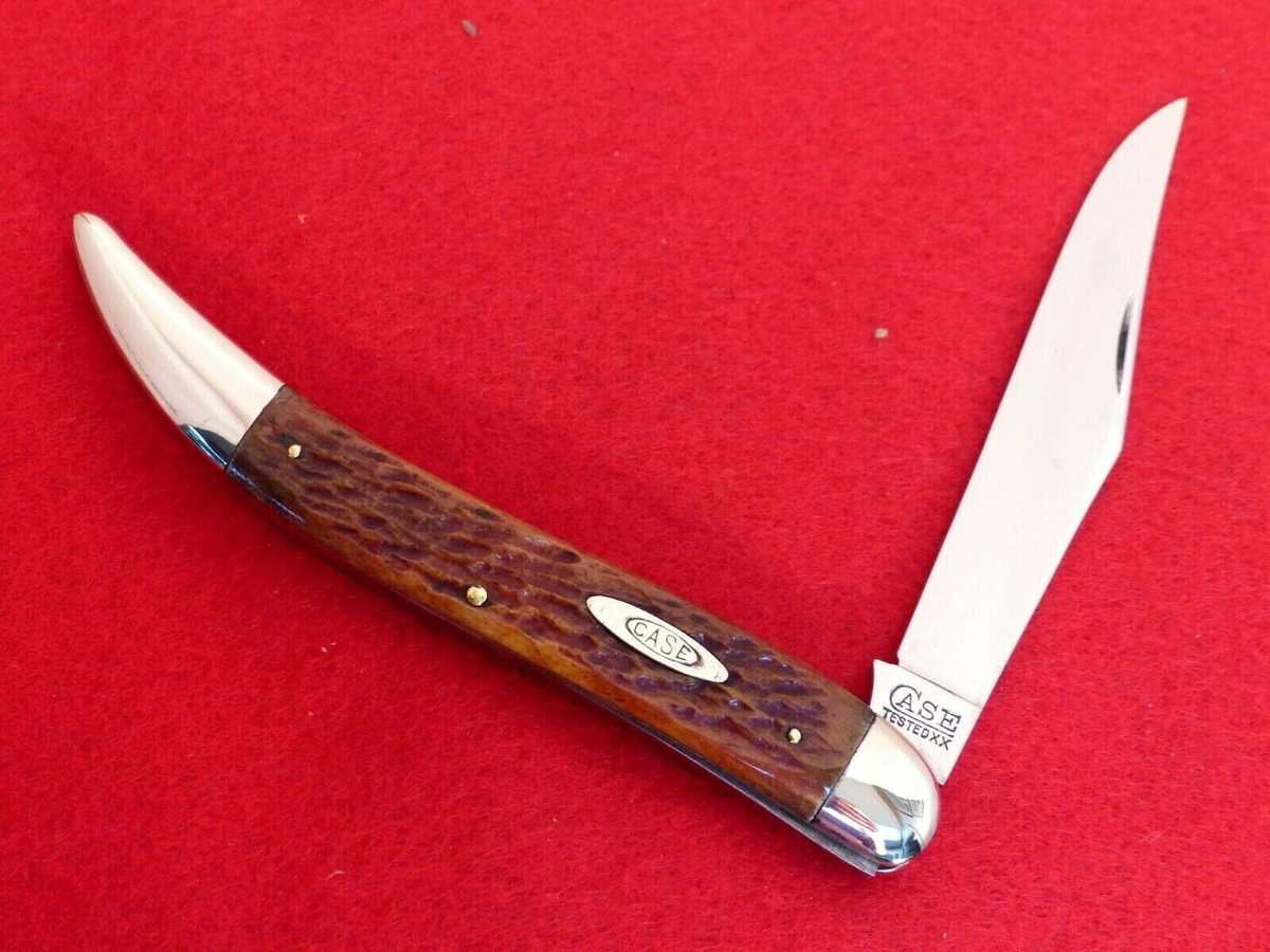

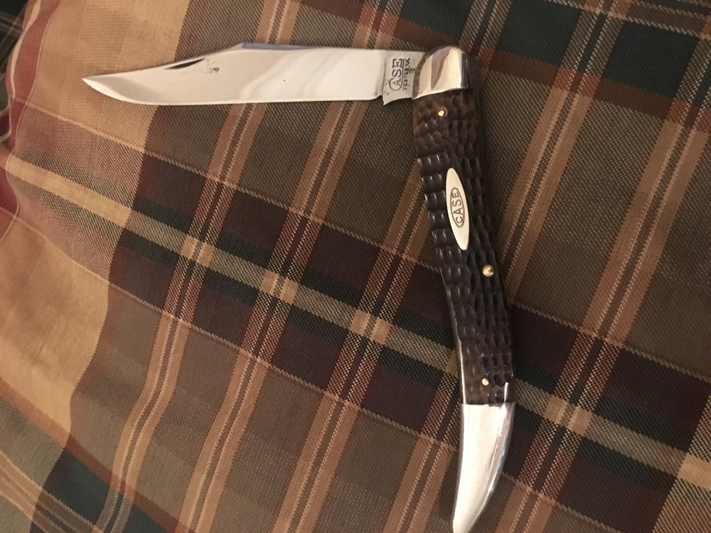

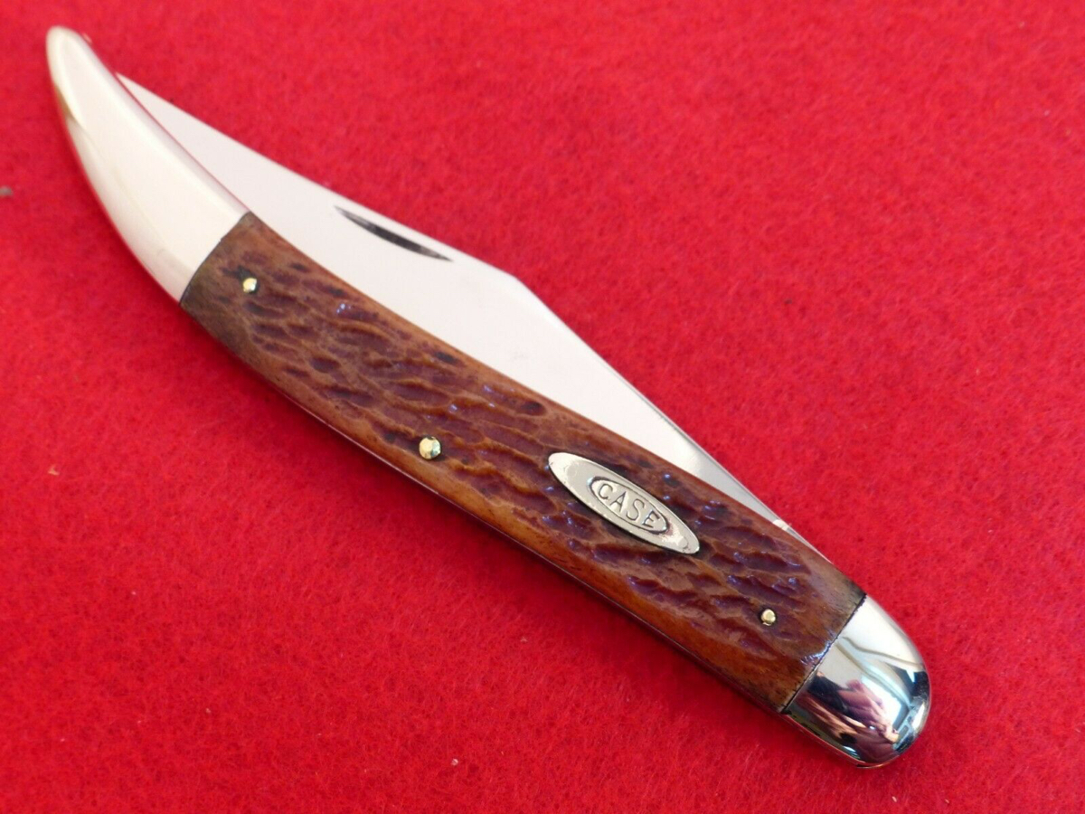

Another offering from Sports Colbs on the Bay, already racking up bids. Looks to be the same bone used on the Tested XX fishing knife --2095 posted here a couple days back. Since this "Counterfeit Watch" is for new comers as well as the more experienced collector it should be reiterated that neither this knife nor the Fishing knife just mentioned are counterfiet in the strict sense of the word. No fake "Case Stamp" cold stamped on to a tang that's had another (often newer, less expensive) brand's name removed, etc. This is for all sakes and purposes the real Mckoy: A Case Tested XX Era --1098 pattern "Tickler," "Toothpick" one of the greatest examples of knife art and craft of the early 20th Century. Like the fishing knife, this one may have had handles that out- gassed at some point in time replaced with these non-original handles. If Sports Colbs had merely mentioned this I wouldn't be posting the knife here. But because he's saying the bone is original to the knife--a warning must be issued. Enclosed: a couple pics of the knife and a link to Ebay and for comparrison one of my 098s with factory green bone covers.

The pictures aren’t that good. The handles looks like Rogers Bone which would be correct.

I agree with Robo - rehandled in modern "Rogers" bone. Shield appears to be too small. The basic knife was a 61098, appears to be real but cleaned. Case never made the single blade 098 in yellow, so must have been green bone handles originally.
