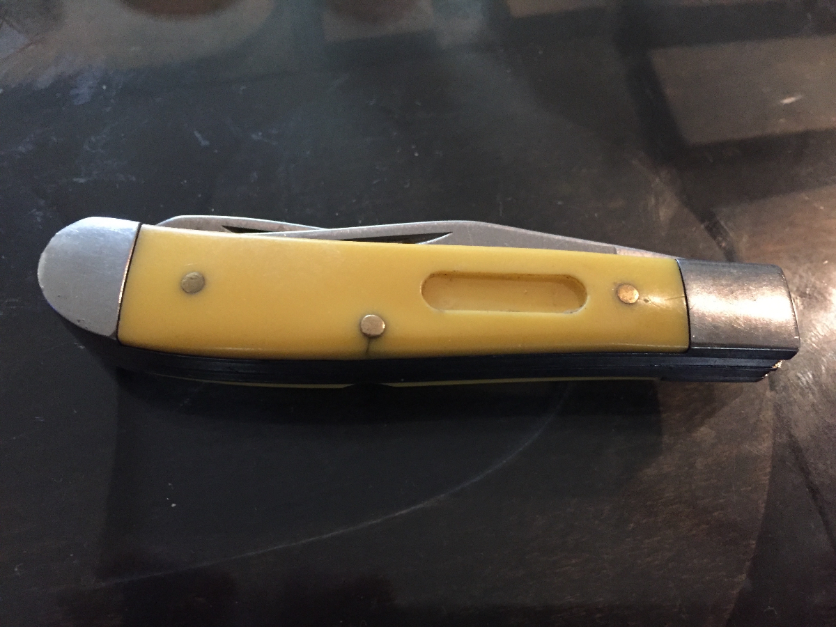

Low Tech Shield Replacement

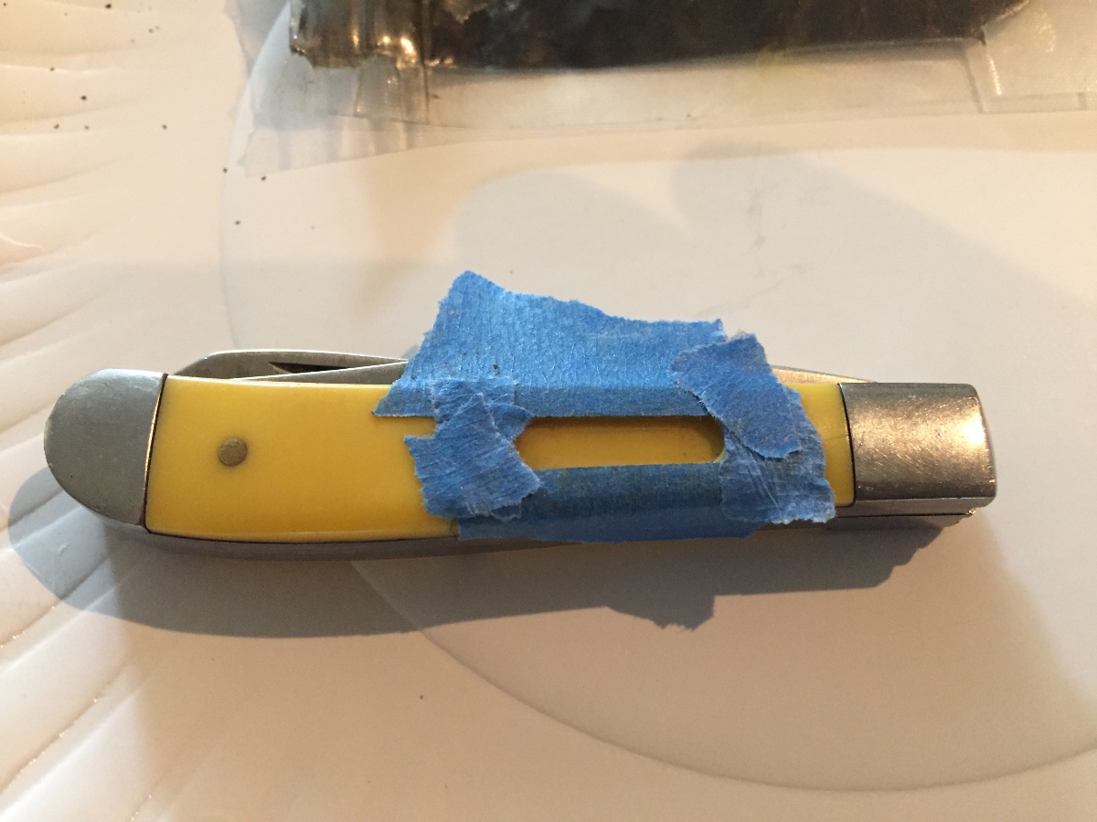

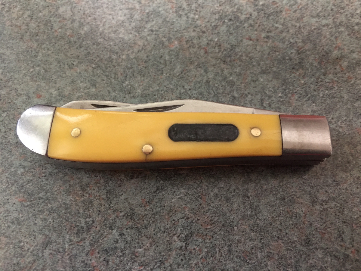

Here is a quick and easy way to "replace" a missing shield. I wouldn't choose this for a knife with too much value...but it beats painstakingly fabricating a new shield and fitting it.
**** I'm pretty sure this is a Schrade import, of relatively recent manufacture. It has no country of origin marked on it and is only marked SCH17TY. I thought if something was imported...it had to be marked with country of origin. How did Schrade get by this?
Didn't take a lot more than 15 minutes total time. Painters taped to confine. Mixed a little black mica powder (you could use charcoal) in epoxy. I don't care what the box of "5 minute epoxy" says...wait overnight to sand it.

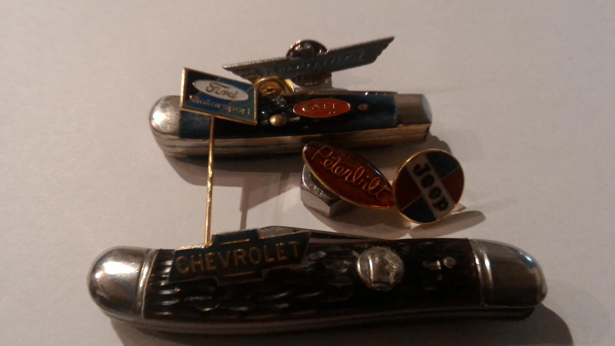

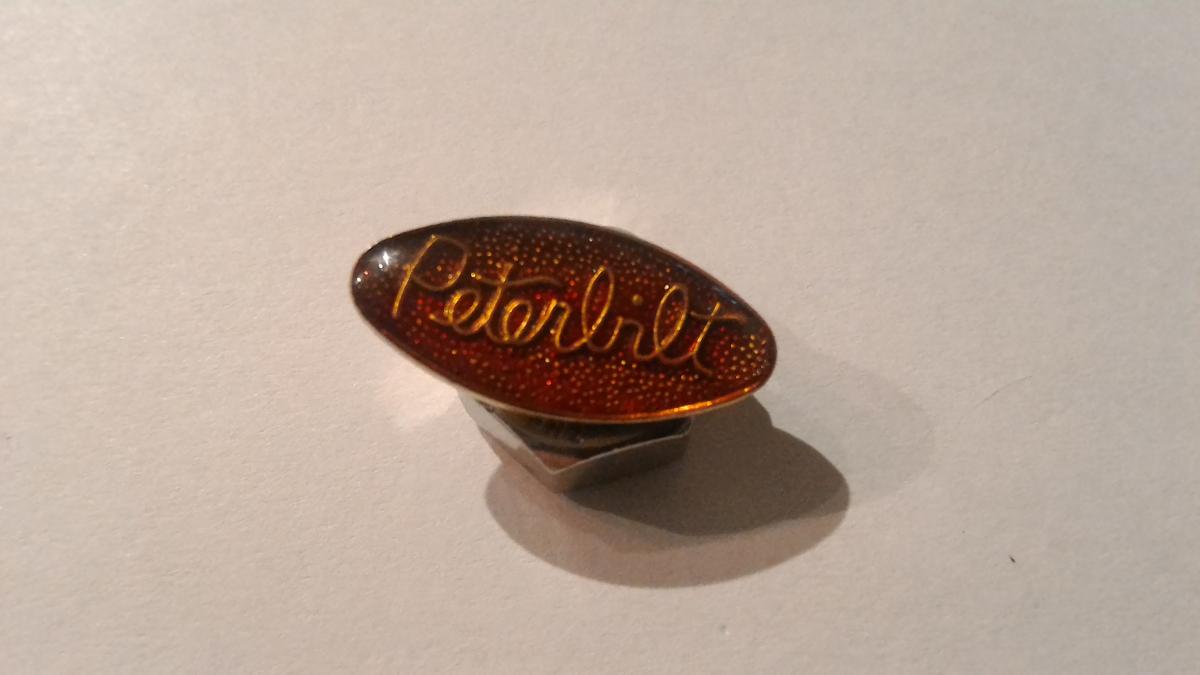

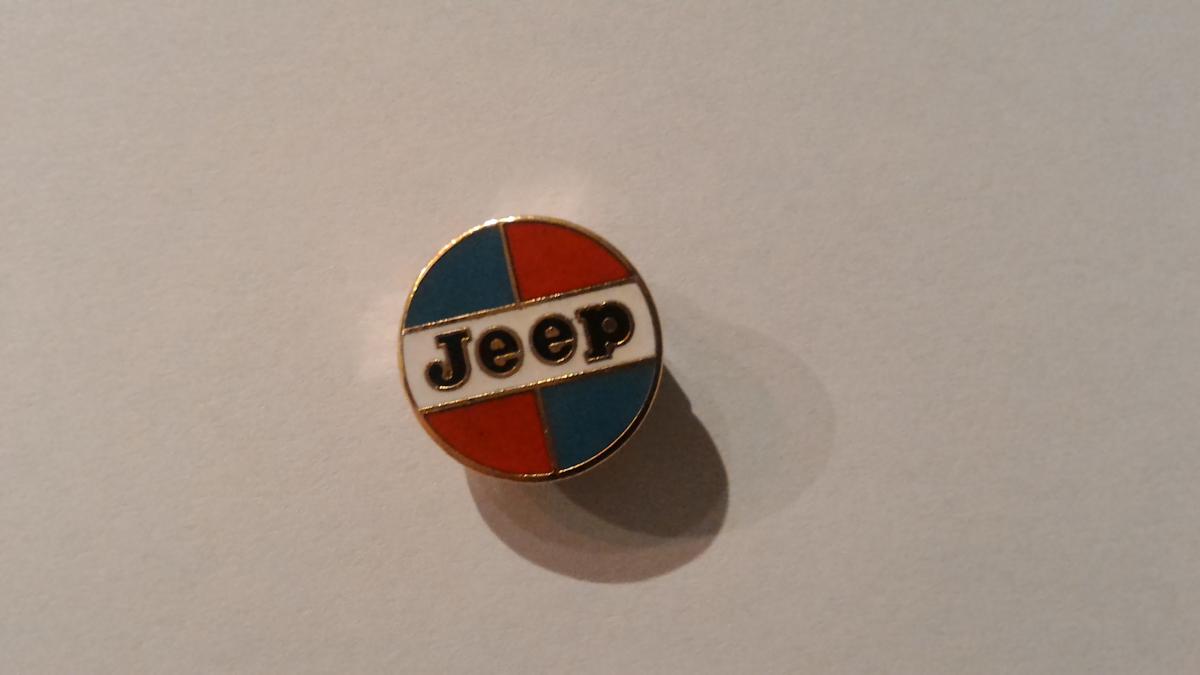

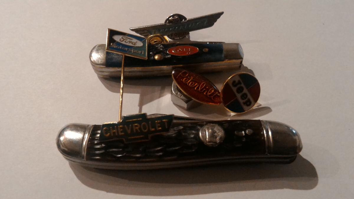

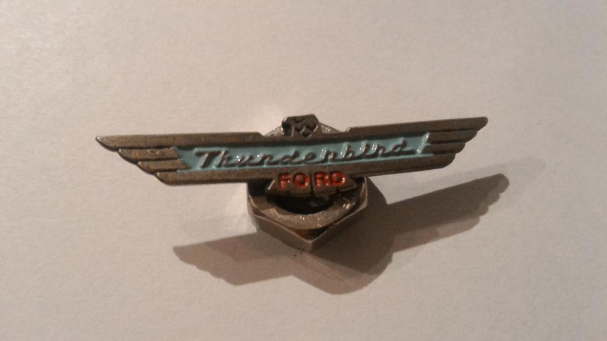

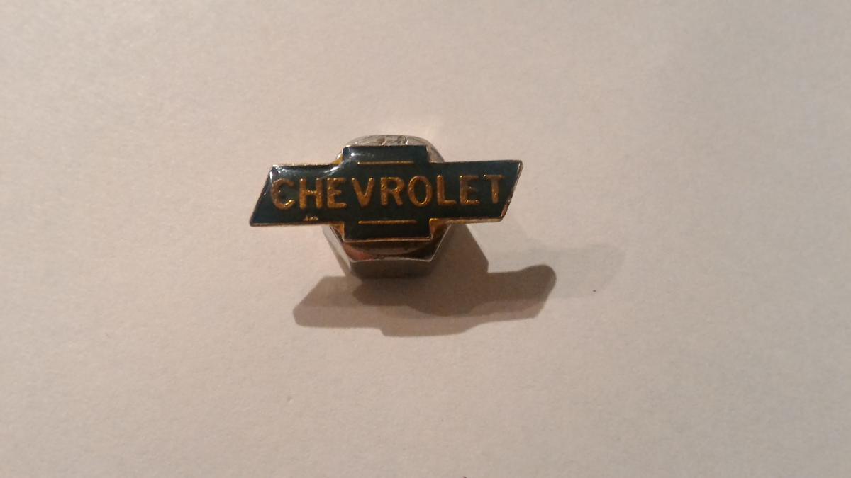

Hi guys,

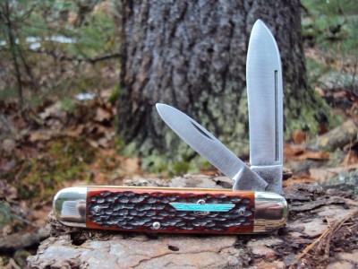

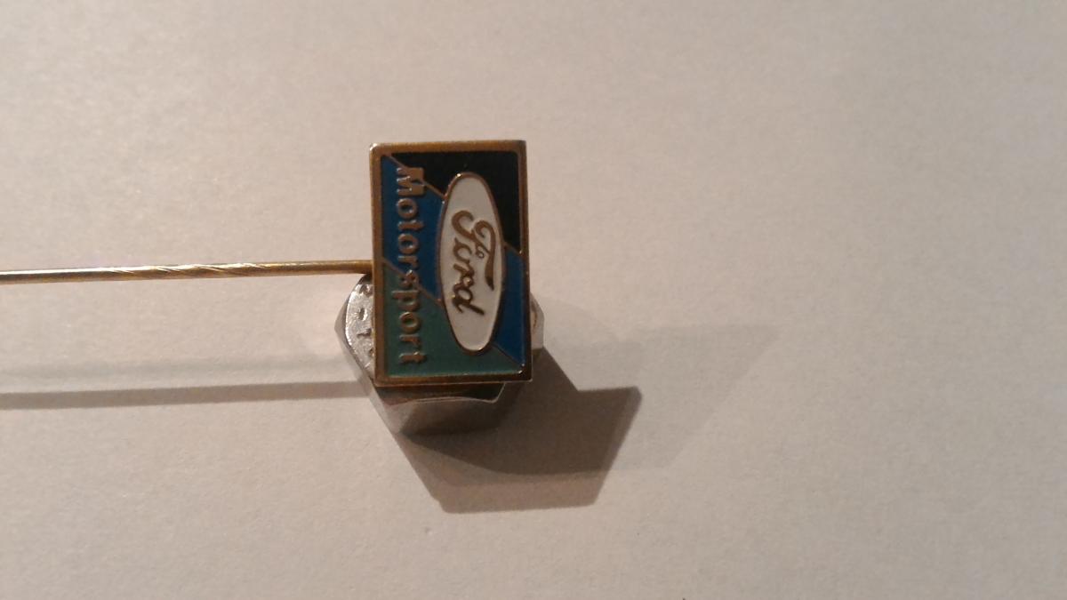

Had something I thought I'd add to this topic. I have been accumulating some pins to decorate my next "Tee-Box-Showcase" viewtopic.php?f=2&t=62229 & I thought I'd post some pictures of them here just as an idea for replacement shields. They would probably only work on larger knives or you would need smaller pins. Anyways, here are a few pictures for whatever it's worth.
I threw in 2 pictures with a small case trapper & an Imperial so you can get a better idea of the size of the pins. Like I said, it would probably only work for larger knives. It's just an idea.
Oh, and they are laying on a nut because they still have the pins on the back of them. The Ford Thunderbird pin would probably work the best from the height & the Peterbilt pin looks the best but it's about 1.5 X the size of the case shield. The Jeep is also about 1.5 X the size of the Imperial shield. The pictures aren't very good, sorry but you get the idea.

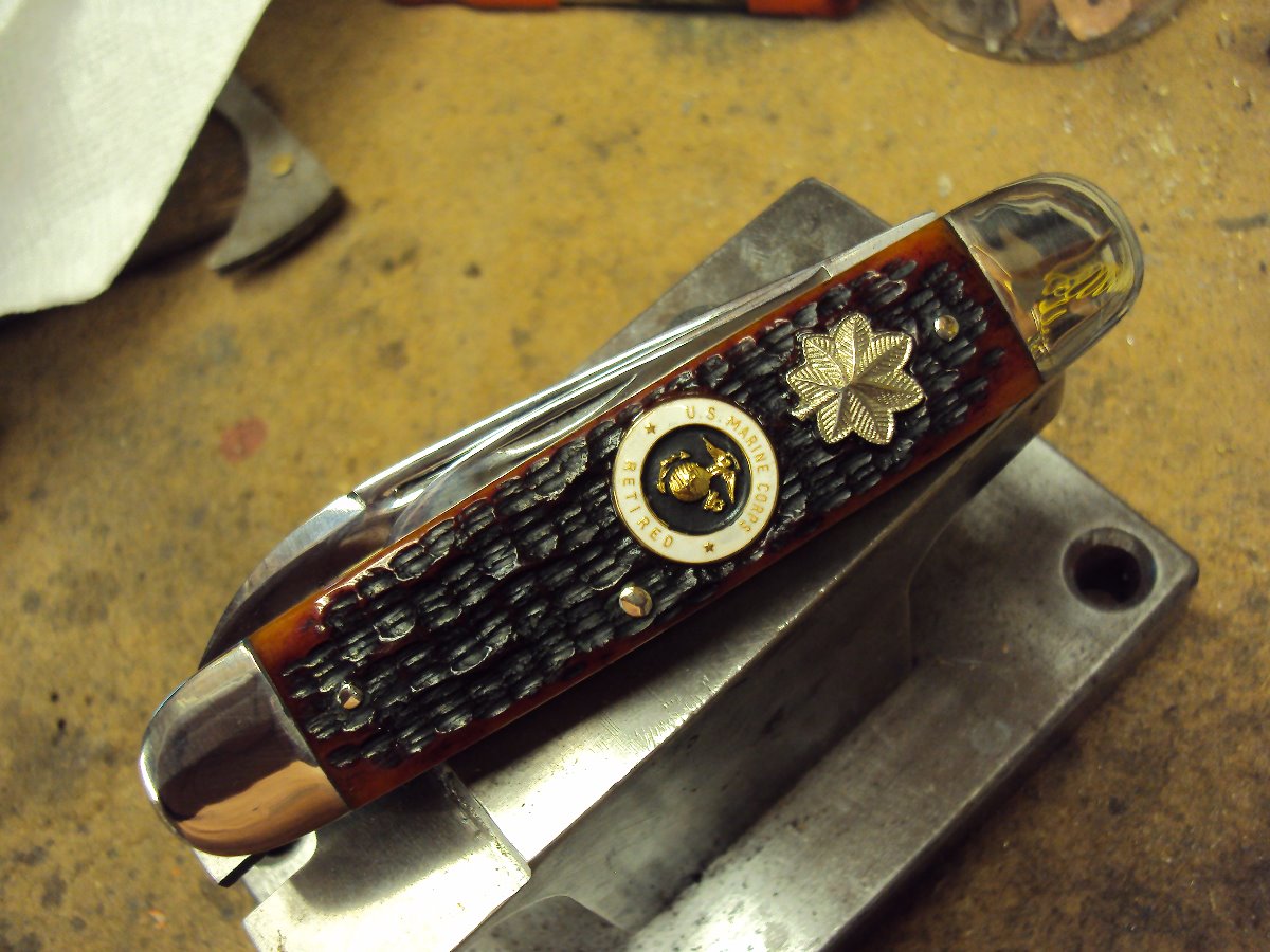

- jerryd6818
- Posts: 39458
Re: Low Tech Shield Replacement

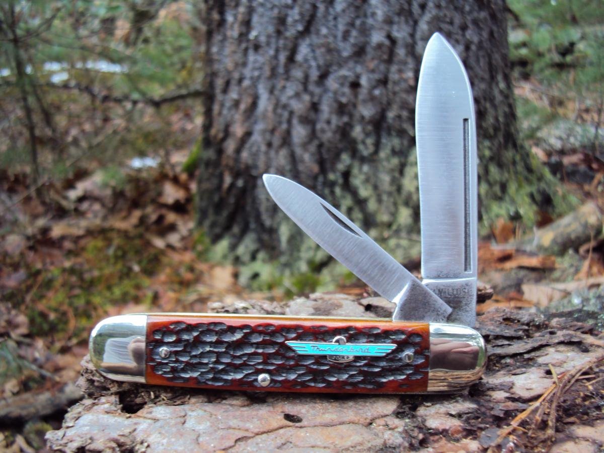

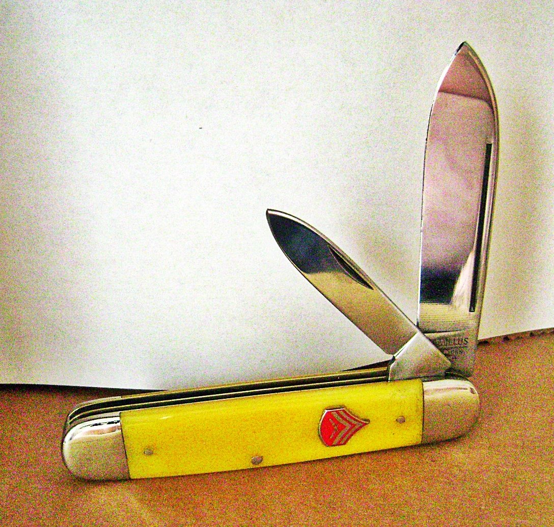

Had that done to a Camillus 23 (big knife) for Tommy.
None of these are the epoxy thing. All are just pins or tie tacks. Come to think of it, all of these are Glenn's creations.
And Glenn did that on a knife he did for a relative.
Glenn also did a tie tack shield for me.
Cool, so it does work well!
That's the same type of Ford Thunderbird pin that I have.
Thanks for posting Jerry!
Now I know the idea was a good one. At least for larger handles.
Tom
Tom
- jerryd6818
- Posts: 39458
I probably shouldn't have posted those Tom, because Glenn mounted those shields in the traditional manner but he did a stellar job of it.
