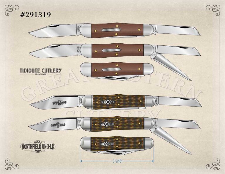

KJ, you're right that the classic whittler has the split-back, two spring configuration, but I suspect that the "whittler" name on this #29 comes from the facts that the two secondary blades both pivot on the opposite end of the main blade, and the main clip folds in between the two opposite secondaries. Very similar to a cattle knife, but the cattle knives I've seen have the main and sheepsfoot both pivot from the same end, like the #98 Cattle Knife example. That's just my guess. I'd bet that GEC would use historical nomenclature.kootenay joe wrote:This is another example of commercial marketing incorrectly using a knife term/word. A whittler is a 2 spring, 3 blade knife in which the master blade bears on both springs. The GEC #29 is a 3 spring, 3 blade knife. It lacks the important feature of the master blade bearing on 2 springs.

The production pics show the backsprings in a black color. I've not seen this before. Are the finished backsprings still black? Or was that perhaps the carbon heat treat scale that had not yet been polished off? Anybody have any info on this?

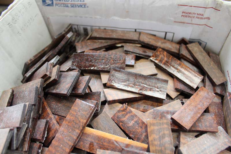

GEC posted bloodwood scales for the Northfield #29 Humpback knife , on the GEC Web-sight. I spotted the snakewood blanks earlier to day. I got my pre-order on the #29 Snakewood knife.

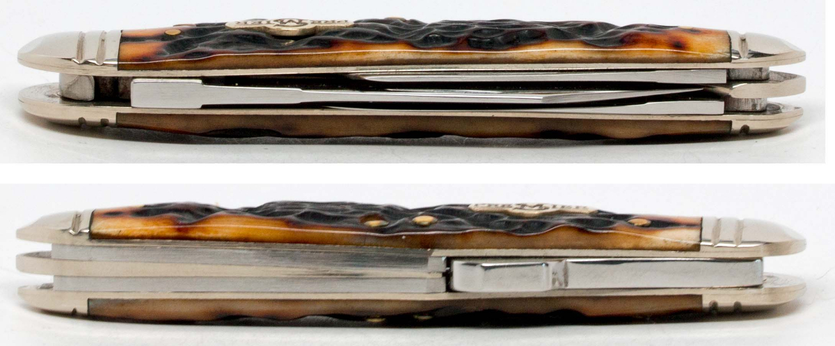

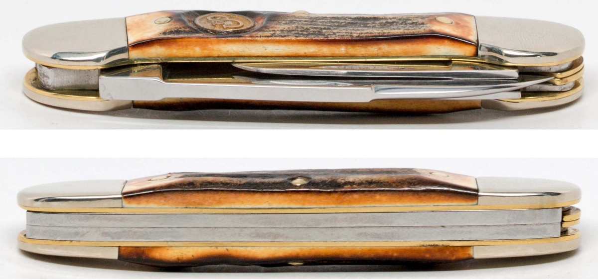

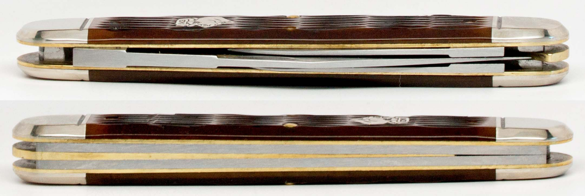

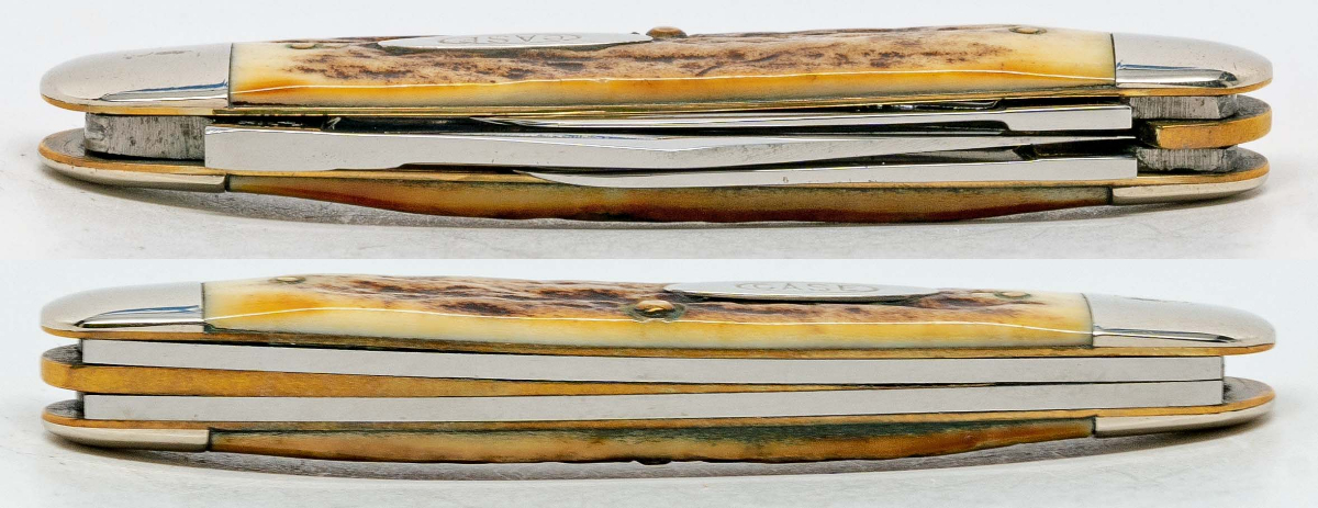

Below are some top & bottom pictures of knives with 2 springs and 3 blades in a whittler configuration. 3 of the examples have a tapered frame and the springs separated by a wedge shaped liner. Interestingly one of them is a GEC 98 Texas whittler so GEC can make a knife like this if they want to.
The 4th example is a Canal Street Cannitler which is a mash up example like the "Stockyard Whittler". It has a whittler blade configuration, a non-tapered frame, and canoe bolsters. I happen to like the Cannitler and carry one frequently.
These examples are all pretty well made in that they don't show blade rub from opening and closing. My opinion is that the old Case Whittler is the most attractive of the bunch attached below and probably exhibits the most craftsmanship. I signed up for a Stockyard Whittler and am looking forward to trying it out. I will be disappointed if the Stockyard Whittler exhibits blade rubbing, especially with 3 springs.

Those pics are very interesting. The Canal Street whittler shows that a wedge shaped center liner is not needed. Are the secondaries thinner stock than on the Case ? If not then why is a wedge divider used ? Instead just use the little 'spacer bits' at the secondary end like in the Canal Street knife.
Is there something i am not understanding about whittler construction ?

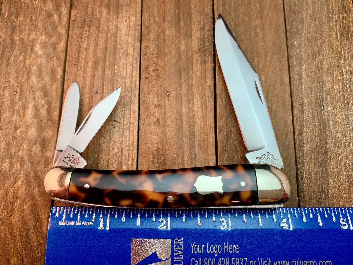

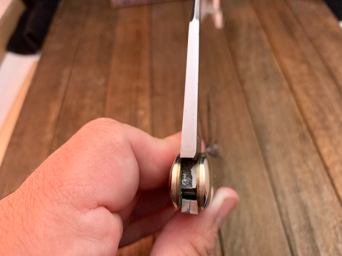

Here is a Bulldog that I bought and sold recently. I had never seen a Whittler with such a thick main blade. I’m sure it was made this thick to rest against both back-springs. But that also required that they make the main blade a saber grind since tapering that thick of a piece of steel down to a fine edge would not be easy or particularly esthetic. There was no wedge and the springs were just straight springs. When it was open there was still a gap on both sides of the main blade. Also this main blade was a real nail breaker trying to open. I couldn’t get it open without using a knife pick, which is why I sold it and didn’t keep it.
After reading this discussion of Whittlers and having seen the flaws in this design, I can see why manufacturers have tinkered with these Whittlers to make them more user friendly while dealing with the mechanic nature of them.

Mark the thickness of master blade on the Bulldog is not unusual. The idea for a whittler is you have one strong thick blade and two thin secondaries for finer work. The springs in your knife are somewhat stronger than they should be as can happen with any brand. Don't assume if you see a whittler with a stout master blade that it will be hard to open. Most are fairly easy to open.

Mark, I don't blame you for getting rid of that nasty thing! Tortoise shell acrylic... Yuck!Sharpnshinyknives wrote:Here is a Bulldog that I bought and sold recently.

I like whittlers, or maybe it's that I like stockmans and whittlers are a classier way to get one long blade and two secondaries. A manufacturer's high end whittlers will be split backs with the wedge. The inside edges of the springs are filed so even though the springs meet at an angle the edges in contact are parallel. Consequently the master tang does not to be as wide. In addition to cost this design's draw back is that the secondaries project out of the handle angled off to the sides more than other whittlers except for lockbacks. Secondaries open parallel to their spring.kootenay joe wrote:Those pics are very interesting. The Canal Street whittler shows that a wedge shaped center liner is not needed. Are the secondaries thinner stock than on the Case ? If not then why is a wedge divider used ? Instead just use the little 'spacer bits' at the secondary end like in the Canal Street knife.
kj
The best of the ones with no wedge have both springs tapered for their full length. The only whittlers I've handled that were made this way were Queens. Unlike split backs I have yet to handle one that did not have great snap.
Whittlers with no wedge and springs with out taper some times have fillers that are part of the liners in one or both ends. The fillers eliminate the need for wide blade stock. Others like the Bulldog that sharpnshinyknives did not keep just have very thick tangs. To avoid nail breaker snap the springs can be thinner front to back. sharpnshinyknives' Bulldog is the first one I've noticed that has such a thick blade near the tang. Usually the blades are ground down so they have normal thickness immediately in front of the tang. The secondaries of this group open parallel to the handle.
Three spring whittlers offer the option of filling all the blade wells with long blades. The secondaries of my three spring GEC 54 and Queen Sowbelly Whittlers are only slightly shorter than the master. They could have been named three blade moose. The short secondaries in Case and Buck's three spring Whittlers leave a lot of empty blade well that looks inefficient and collects lint in a pocket. However, they keep cost down and their blades open parallel to the handle. Also they are not as wide as you might envision because since the blades powered by springs that lay side by side are on opposite ends they do not need liners between the springs.
Apparently the new GEC 29 Stockyard Whittler will have a lot in common with Buck and case three spring whittlers. The whittler that comes to mind as being the closest to the new GEC was Queen's three spring Rail Splitter Whittler. Both have broad master clip and sheep's foot blades. What sets the the new GEC apart is its punch.
