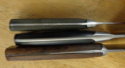

One thing that is kind of sad is that no new knives that I have have tapered tangs. Back in the old days some good quality knives had a tapered tang to improve balance or reduce weight. I have never seen a new knife with that feature. Here is a photo of what I am talking about. Top: Henckels, middle: Wusthof: bottom: unstamped old knife.

My belief was that tapered tang was a sign of hand-forging, which large manufacturers do not do anymore.
