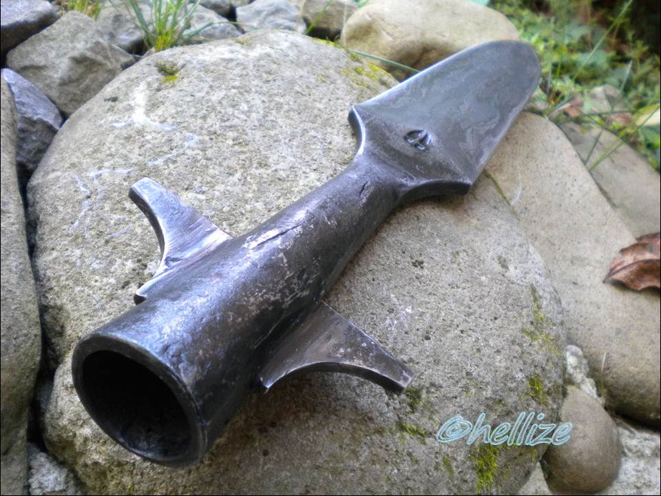

Now all that's needed is a good spear, specifically designed for the sole purpose of pig-sticking. The head must be such to penetrate deep and deal massive amounts of damage with a single throw or jab. It must be wide and strong, and should have two wings near the end of the socket. These wings are designed to prevent the spear from penetrating too deep into the boar. This keeps the boar from running up the spear and attacking the hunter, and also makes it easier to remove the spear and strike again.
The haft is characterized as being thicker and stronger than most spears. This handle is also much shorter than a standard scavenger spear, which makes it easy to handle in tight brush.

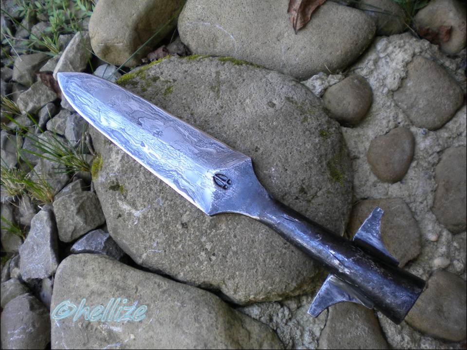

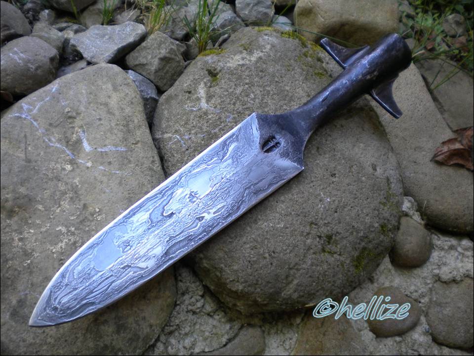

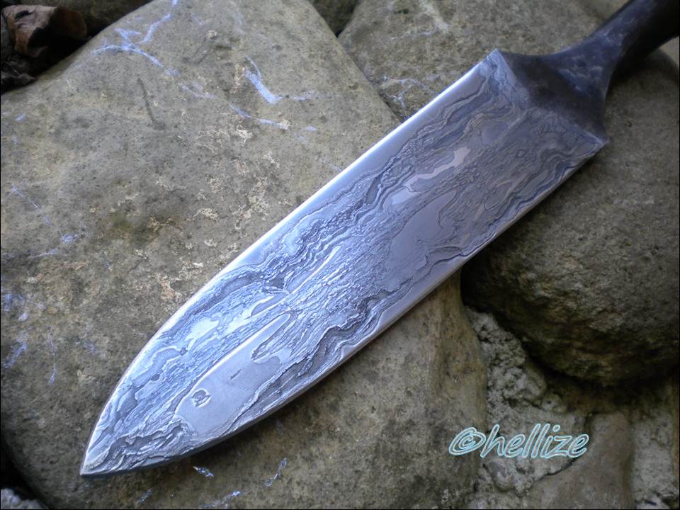

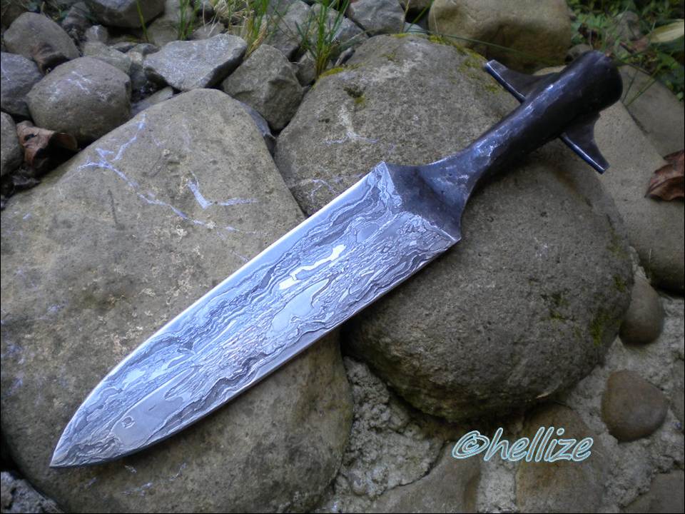

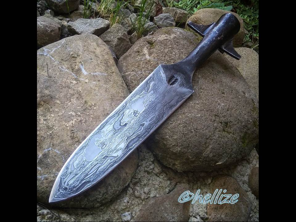

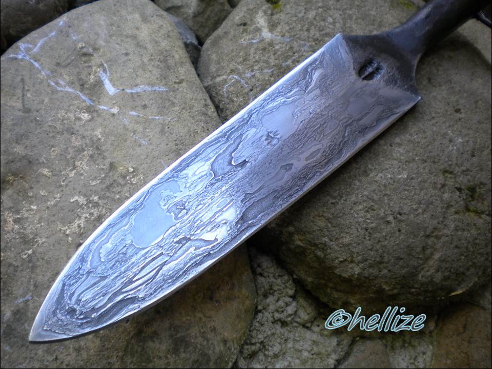

The spear head is 42 cm long, with a 24 cm long, 6.5 cm wide and 8 mm thick blade.
I forged it using motorcycle chain with a 5160 steel core. it is a san mai.

I hate radioactive puffball outbursts...but I do like that spear!!!

Was that one forged by that famous bladesmith from Chernobyl? And does it glow after sticking the pig?
As always very cool Csizmar.

Very impressive work.

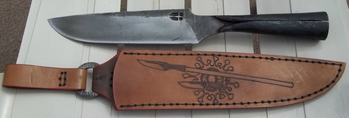

AH......I got the best of both worlds from hellize....
A Spear & Knife & Custom tooled sheath to hold it !!!
Stag

Hope you are having fun with it!stagman wrote:AH......I got the best of both worlds from hellize....
Stag

A prized possession for sure Stagman.stagman wrote:AH......I got the best of both worlds from hellize....
