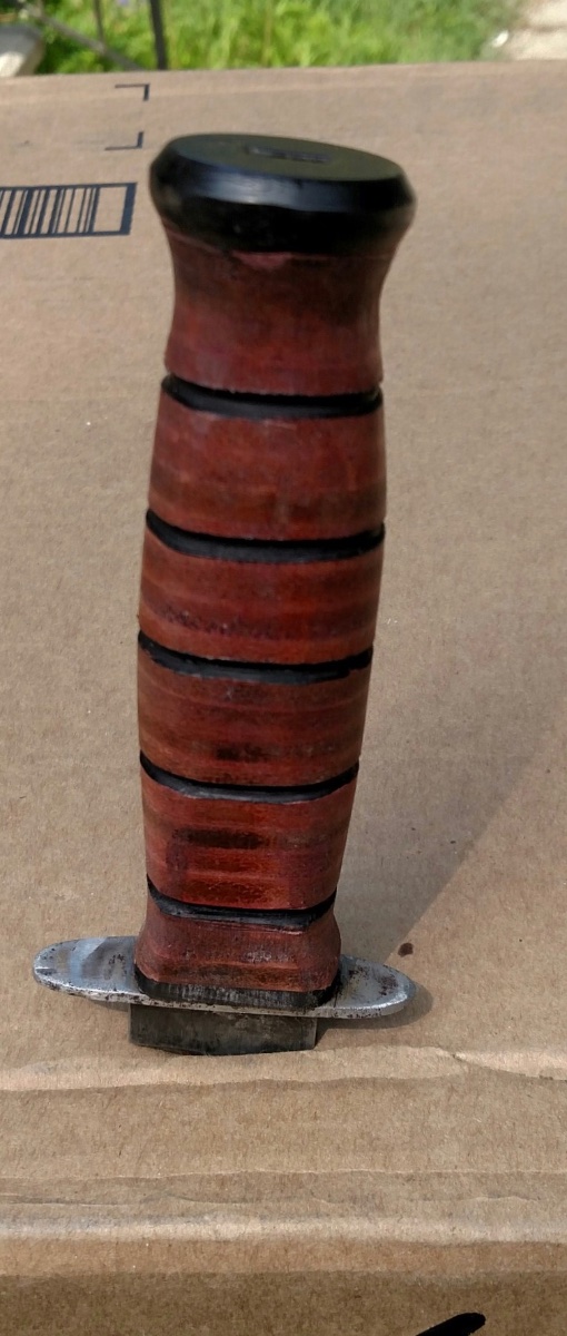

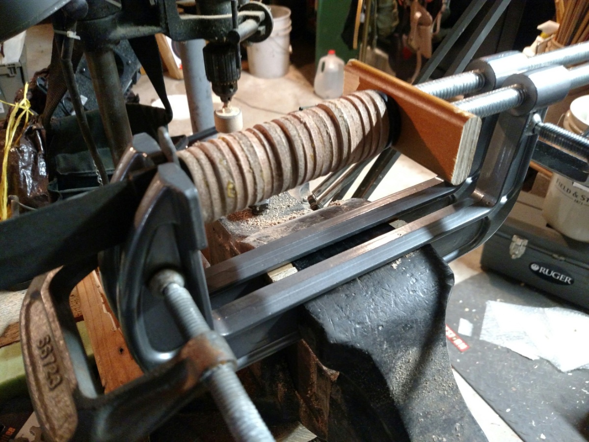

KaBar sells a kit to replace handles. I used them on a WW2 RCC USN KNIFE.

Re: Replace Leather Handle M3 Trench Knife
MAN... that is a NICE restoration job!!!
WOW......
(Better than new!)
WOW......
(Better than new!)
- 1967redrider
- Posts: 21506
- Location: Alexandria, VA
Excellent work!
- muskrat man
- Posts: 5684
- Location: Ohio
love that clamp setup, proper compression of the washers is one of the trickiest parts of doing these

Eveled...great job. I checked the Kabar site and loved how they characterized the project as requiring quite a bit of "magic". I then went out and saw several YouTube videos and saw what they meant.
eveled
- Posts: 2582
- Joined: Sun Oct 29, 2017 9:37 pm

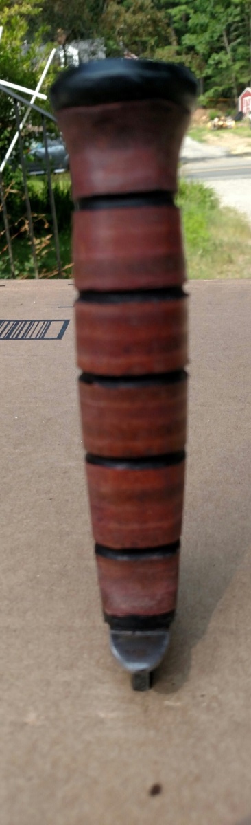

Thanks for the kind words guys. It’s really not that hard. I used a hand held carpenters belt sander and sanding drums in a drill press. No way you could do it by hand. It’s tough stuff. I finished it with cordovan shoe polish.
Clamping it was a challenge. Here is a thread with more details.
viewtopic.php?f=78&t=57781&p=658469#p658469
It really did feel good to bring it back from the dead.

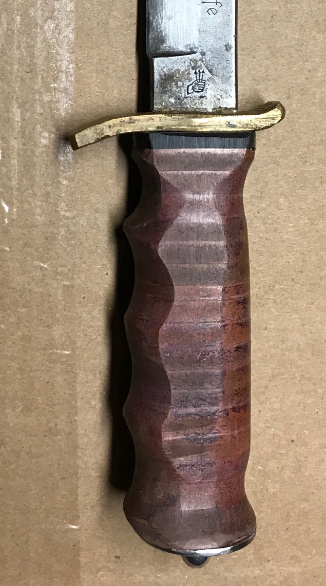

Here is another I did from the same kit on a different style knife. Just to see what I could do. I mostly wanted to see how finger grooves would work in the leather.

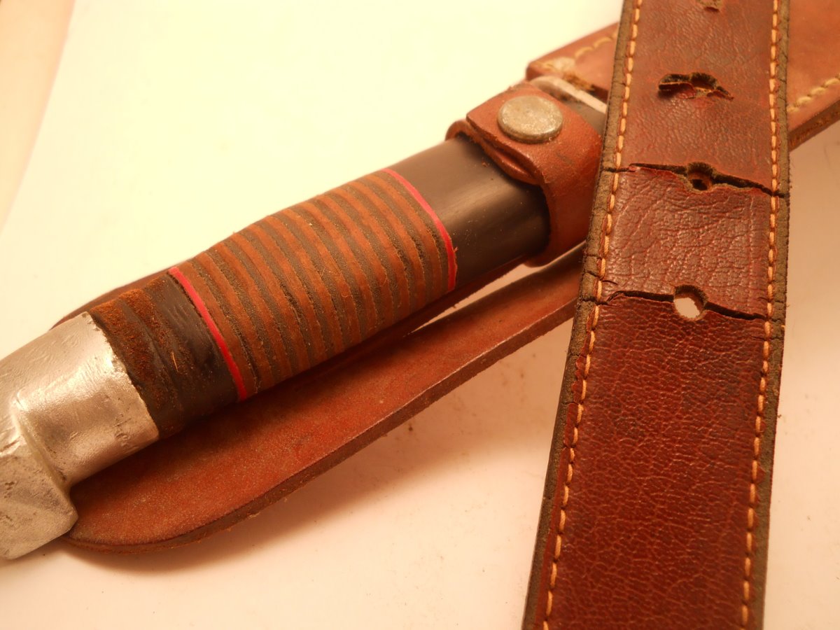

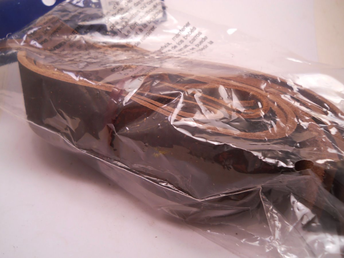

You've got more options here. Having been called a tight wad before I did the math and the leather washers for sale on ebay will cost you about $10 an inch counting the shipping. On a knife with a 4" - 5" handle that is considerable. I watched the talented people on Forged in Fire make stack leather handles one day and saw they were using leather strips. Off I went to the Thrift Store and bought a genuine leather belt for $1. I was able to get enough pcs for the handle from that belt. Then when I was at Hobby Lobby I discovered they sell leather over runs. I bought the package shown for $4 and feel there is enough material in it to do an average size knife with some left over. Depending on what you're working on that might be a better way to go. The red spacers you see on my handle is actually an old make it yourself gasket material that was in the garage and I needed to get rid of. Use your imagination.
