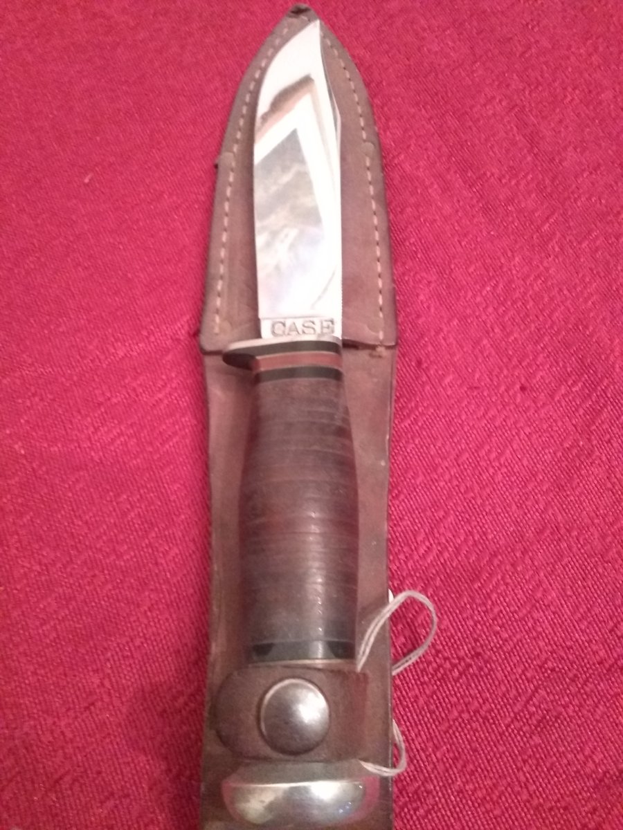

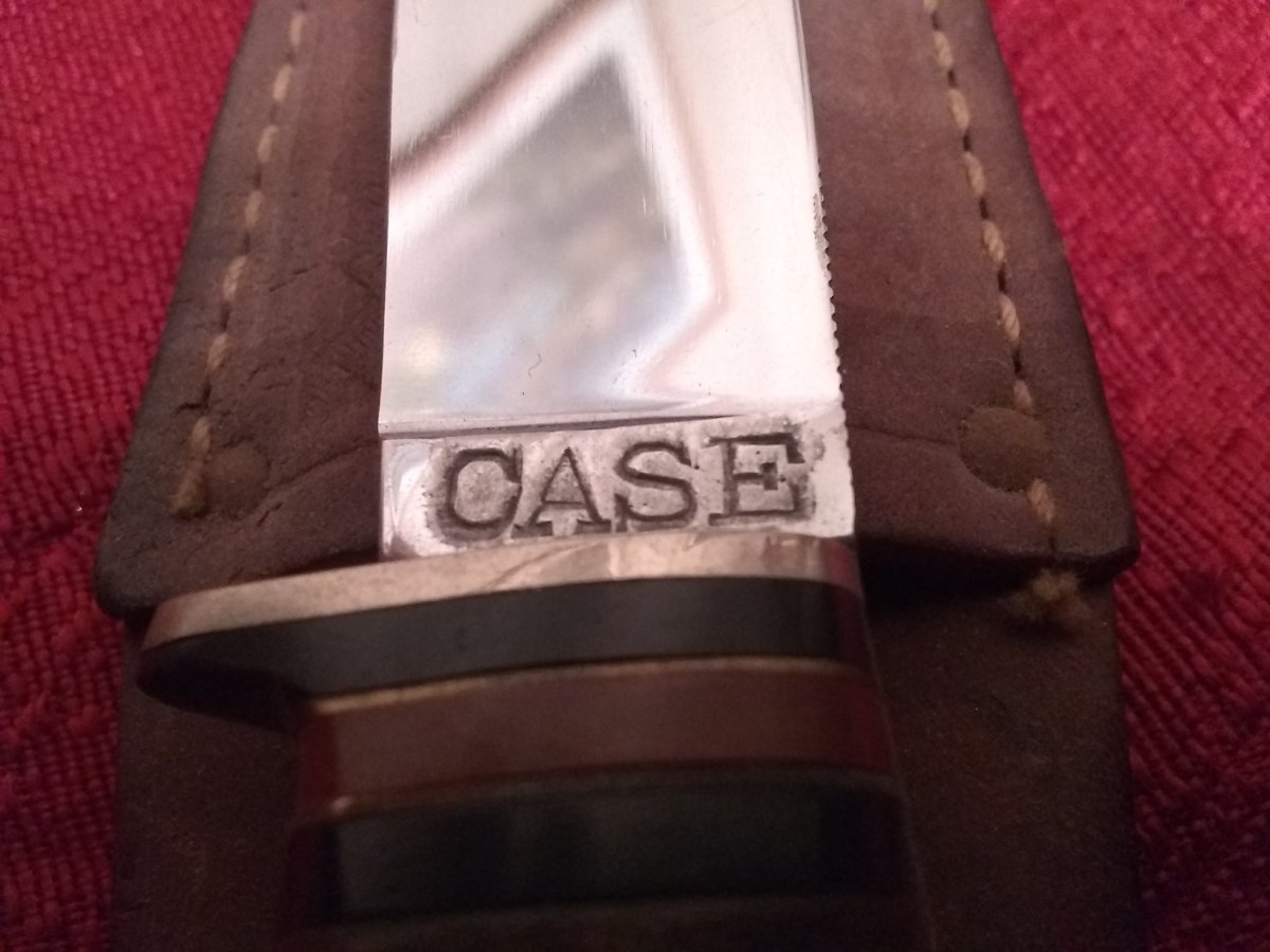

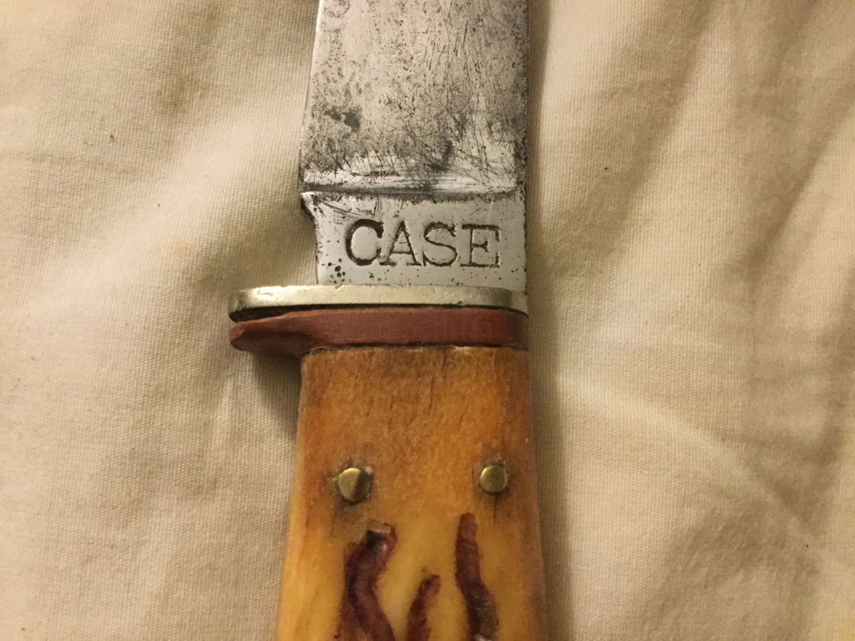

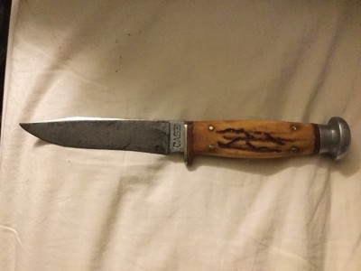

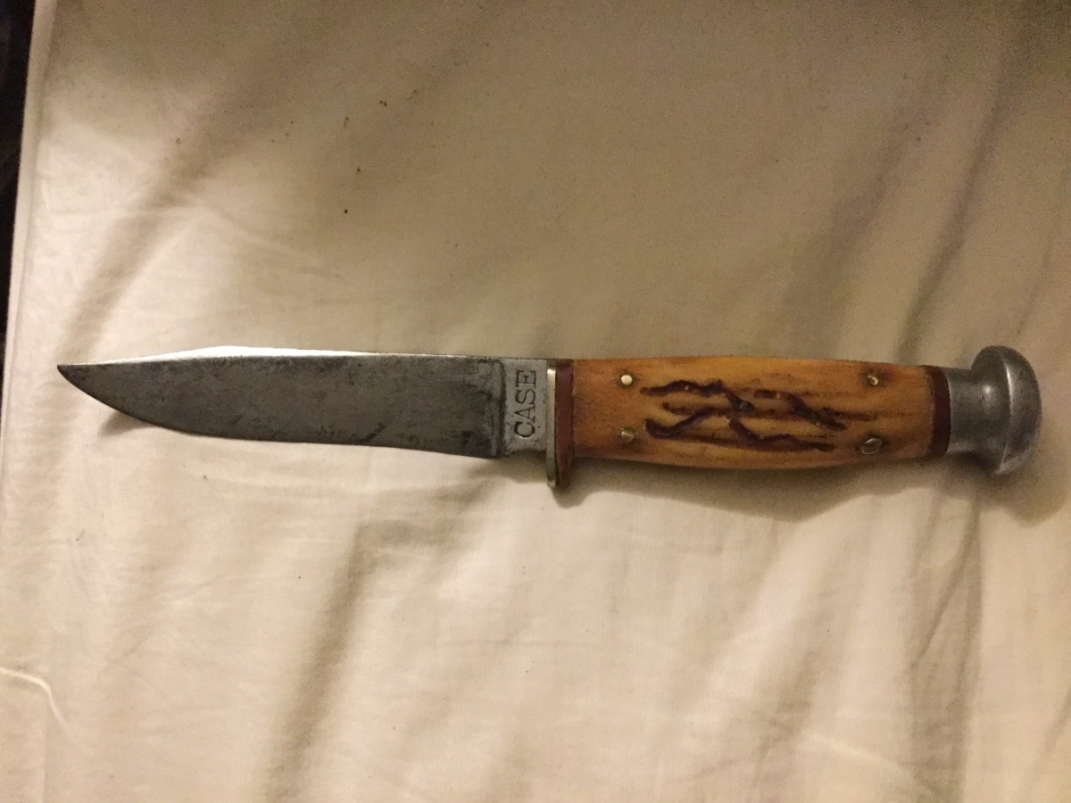

Just bought this, I collect Marbles and Western, not so much Case. Thought it was a 1940-64 stamp. Looks like it could be fake. What do you think?

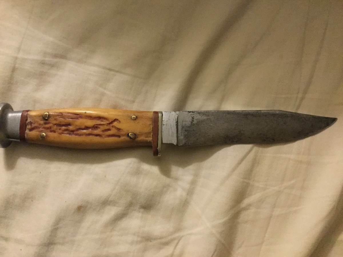

Looks to have been rehandled and the jigging on the Stag looks a little funny.

kennedy knives wrote: Fri Dec 20, 2019 12:10 am Looks to have been rehandled and the jigging on the Stag looks a little funny.
Stamp looks good to me the knife looks good I just think maybe rehandled

kennedy knives wrote: Fri Dec 20, 2019 2:04 am I just think maybe rehandled
I agree with Gary. The edges of the handle are not cut very straight. Large gaps. Click on the image to get a closer look.

Ok, thanks for your expertise. Need to find a vintage sheath.

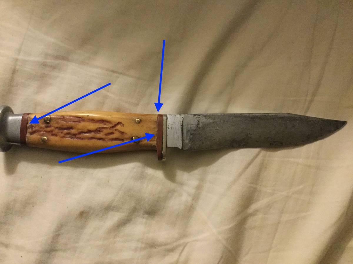

Thanks for the detailed picture Mike !

The single large red spacers used on each end of the handles of this knife were common on celluloid but not on stag. I would guess the handles were originally celluloid. Everything is right about it with the exception of the handles.
