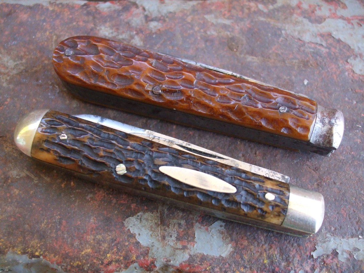

what I'm wondering is how was something like these produced with handtools?

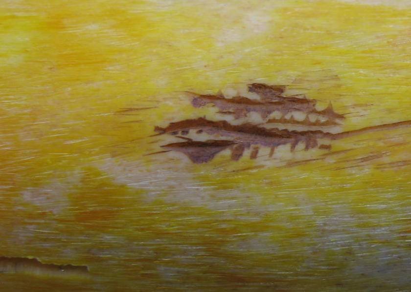

Checkering files are used on metal. Checkering is done on wood and soft materials with checkering tools specifically designed for that purpose. All checkering tools are designed to cut straight lines, not random gouges.
Here's a picture of a piece of bone that I spent 2 minutes on with hand engraving chisels.

Here is the link to the tutorial on manually jigging the bone scales with a Dremel tool.
https://www.youtube.com/watch?v=GrMhWGWe_28
The problem for me is finding that lozenge profile cutter tool.
I have played with using a shaped cheese head screw that I had cut some teeth into. It was OK but too small in diameter.
The disc portion was not a larger diameter ( guessing I need around 3/4" to 1") that would allow me to hold the Dremel parallel with the bench top.
This will allow some finger clearance twixt bench and dremel tool as well as keeping the shape of the groove perpendicular and symetrical relative to the base of the scales.
I can see myself turning such a tool from silver steel in my lathe and heat treating it as I have yet to find a suitable tool to use in my Dremel.
This technique of course is only really suitable to give a random type freehand pattern.
I hope this might help someone.
Ozwelder
