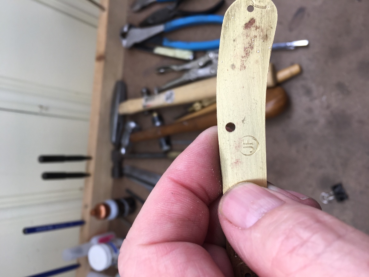

I purchased a Schrade Walden Uncle Henry trapper off of the bay. The price was fair and the blades were in decent shape. The auction photos didn’t show that the knife had milled liners so that was a definite plus,
Factory Milled Liners

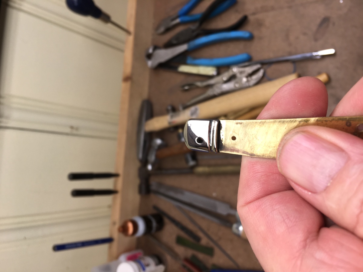

I did some preliminary cleanup of the bolsters and added a rat tail groove. It needs a little finishing but it’s good for now,
Rat Tail Bolster
Rat Tail Bolster

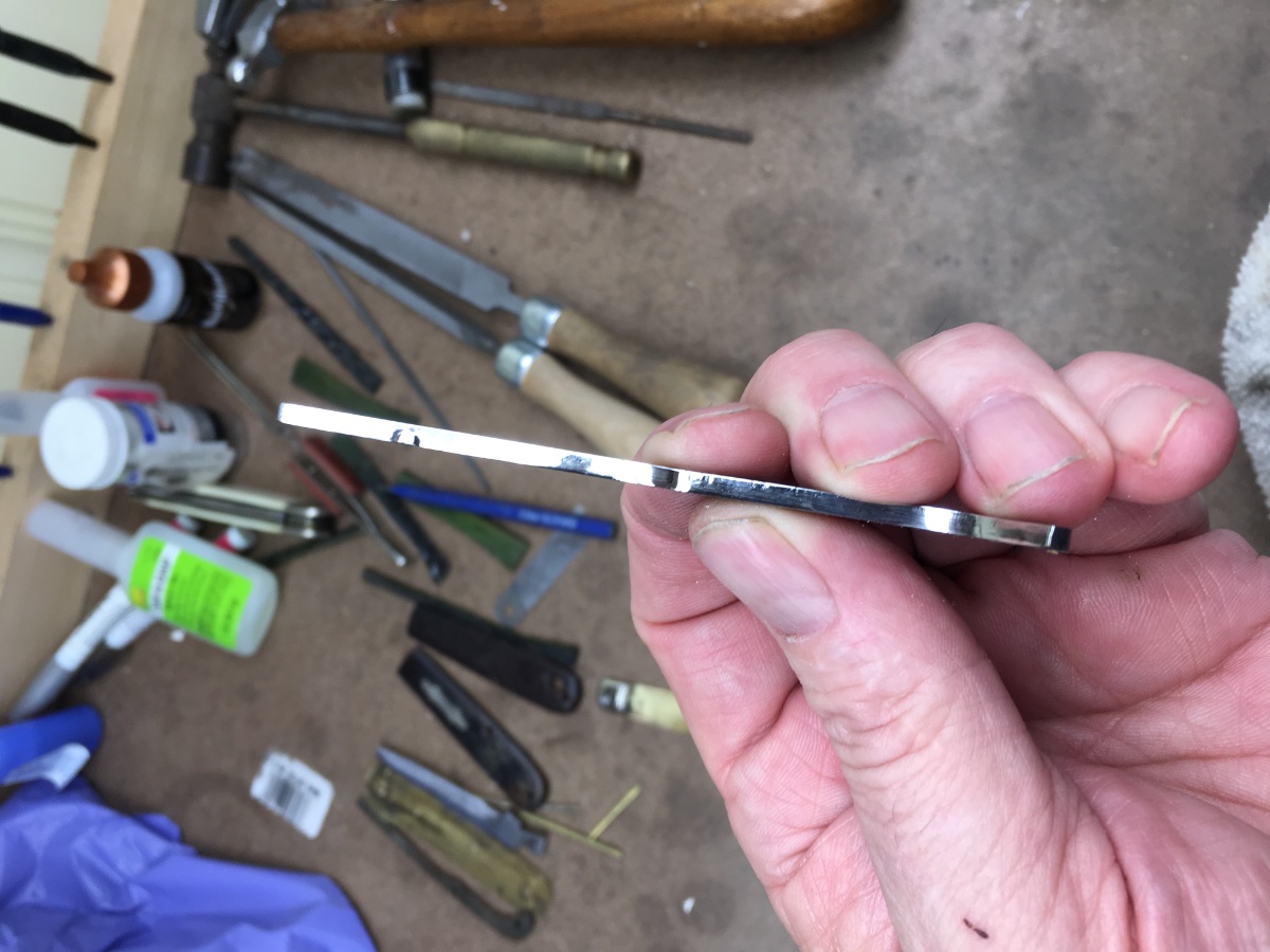

A little cleanup of the liner and added a stamp to identify it,
Liner Stamp
Liner Stamp

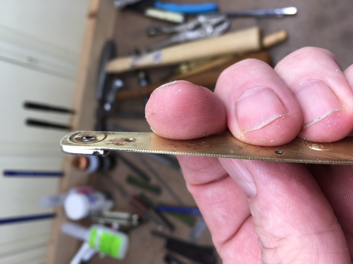

And I like to clean up the inner surface of the springs so they look nice when you look in the knife blade well. FYI, you may see a raised spot on the spring that looks like a spot weld (you can see it in the spring photo). Don’t remove it, it’s there to keep the blade at the required height when closed. It’s not present on all manufacturer springs but I do see it from time to time. The goal (for me anyway), is just to give the spring surface a clean finished look,
Cleaned Spring
Cleaned Spring
