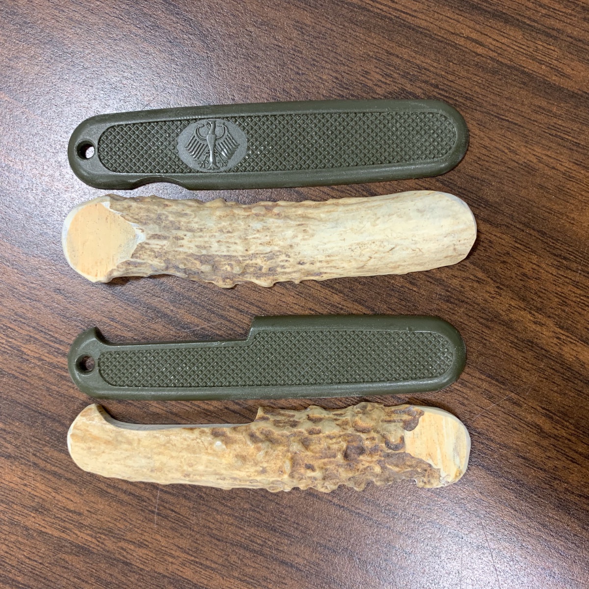

My project is to replace the nylon scales on a 1970's-80's German Army Knife (GAK) made by Victorinox with a pair I'm making myself from whitetail deer antler. The antler was given to me by a friend, and he shot the deer in 1985 so the antlers are already 35 years old. I've cut the scales out and will soon drill and mount them to the donor GAK.
My observations so far: This material is easily worked but very smelly. It's deceptively difficult to find a usable piece of antler from a whitetail deer since the antlers are so curvy. So far I've used only a band saw and a belt sander. I expect to use only a drill press, anvil, and ball peen hammer to finish the project.
Here are my questions:
Would you treat the antler scales with anything before mounting them on the knife? I have zero experience with this and am just wondering if they need to be coated with anything to protect or stabilize them. My material seems quite hard and as I mentioned it's already 35 years old.
Would you use little dabs of epoxy to fill in small irregularities where the edge of the antler scale doesn't quite meet the edge of the knife's liner? If so, what product would you recommend? How about matching the color of the epoxy to the antler?
Sorry, I tried to load images of my project so far but got an error message about my hosted image code not working. I usually just copy the BBS code from Imgur and it works fine. What am I doing wrong? I checked the FAQ's here and it seems like this should work.
Edit: Success! I think I figured out how to attach pictures. Here are the antler scales (so far):
And here is the donor GAK:
Thanks for any tips or advice you may have to offer!

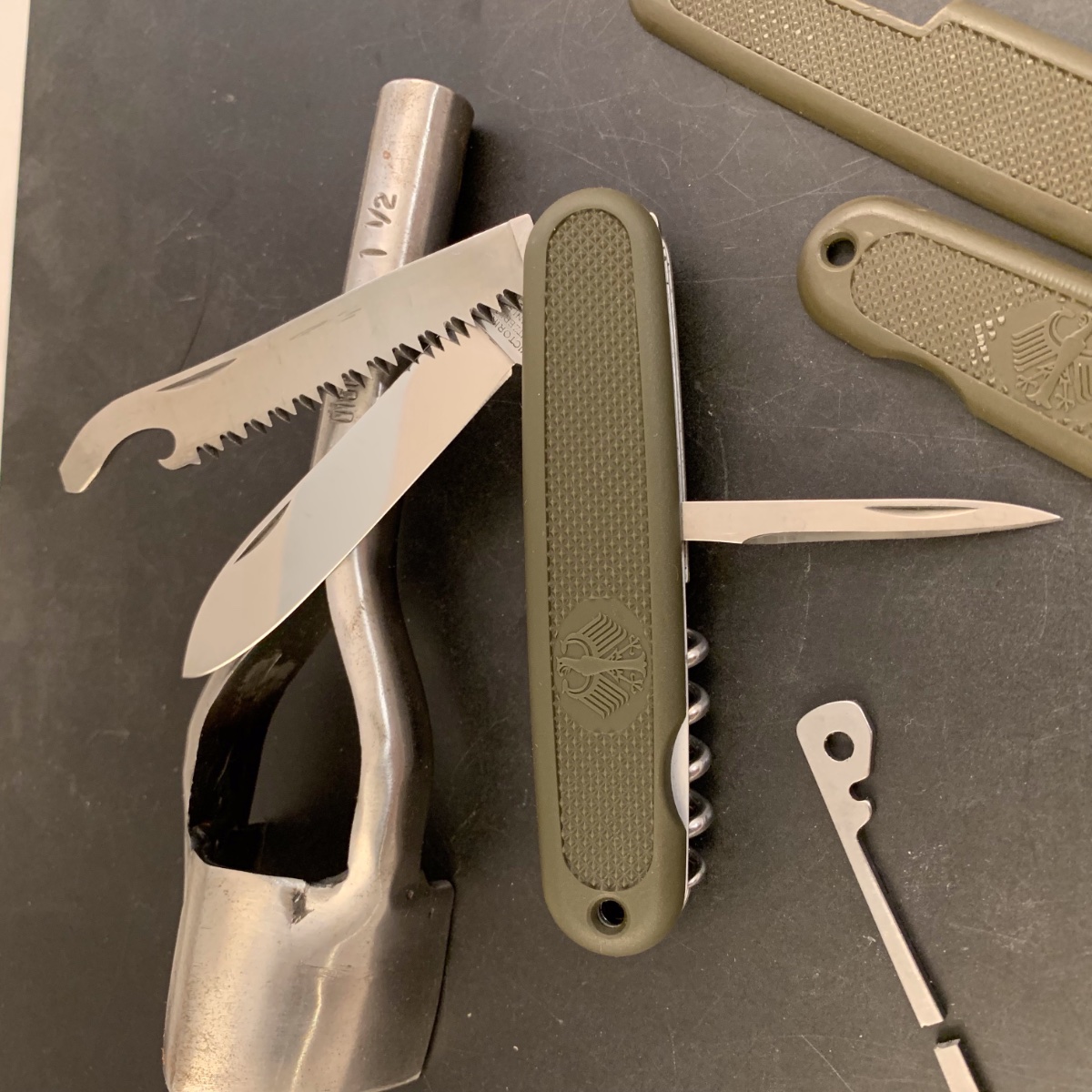

If there are no bolsters then just mock up your knife and you should be able to tell if there will be excessive thickness.
(Usually the bolsters will show you how thick new covers should be.
Since the deer antler is not stabilized, the canals (hollow tubes) in the bone will suck up oil and change the look unless you seal the surface.
(ask me how I know that,,,,,LOL)
Thin and dried out bone is easy to crack when you are peening the pins. This is ANOTHER issue I am still working on. I crack those jokers TOO many times.
NOW, I am still learning so I just wanted to throw out a few things that plagues me. I have used deer antler a good bit, and I still struggle with making it look like I want it to.
Just give it a try on a dead knife or 2 first and see how you do. It's not as easy as Dale and others here can make it look.....LOL.

Stag is not bone.
Stag has been used, unstabilized, for hundreds of years as knife handles. It really needs no protection.
Your stag handles should be cut large enough that there are no irregularities where it meets the liners. Any epoxy used should not be visible.

NOPE.... he can't cut the DEER antler any larger than it already is.....Bill DeShivs wrote: ↑Thu Feb 13, 2020 6:03 pm Stag is not bone.
You stag handles should be cut large enough that there are no irregularities where it meets the liners. Any epoxy used should not be visible.
Fitting deer to a knife is really hard because it is a small set of antlers and they take so many twists and turns. Finding a good flat spot in a deer antler is a hard thing to do.
Myron, I see what you are saying about adding epoxy. It WOULD look better if you hide the liners so I think that is what Bill was trying to say. IF you are afforded the luxury of a larger piece of antler then make it larger so you can file it down to the size of the liner. That way you will get a better fit.

Just epoxy alone is not a good way to attach covers to a knife liner. You really need to pin them on also.
That means you will have to take the knife apart and attach the covers before you put it back together OR... You can use a cutlers "stiddy" and pin them while the knife is together....

I'd suggest watching this to see the construction of those knives before you knock yours apart. Make sure you can re-assemble it. Skeleton construction that incorporates plastic handles is a bit different from regular slipjoint construction. Myron does yours look similar with the handles off?
https://www.youtube.com/watch?v=WXNTM2A8nCY

Yes, I have taken apart and put back together numerous SAKs, so I know how they go together. My plan was to drill the stag scales from the outside and replace the swivels with new pin stock, then peen flush with the outside of the stag scales. Victorinox made a very small number of this 108 mm knife with stag scales in the 1970's and they are hard to find today, and valuable when you do find them.
I'll do a bunch of test-fitting before I commit to make sure it's not an ugly mis-match and/or too much liner is showing. My donor GAK was only 26 bucks and the antlers were a gift, so I don't have much wrapped up into it.

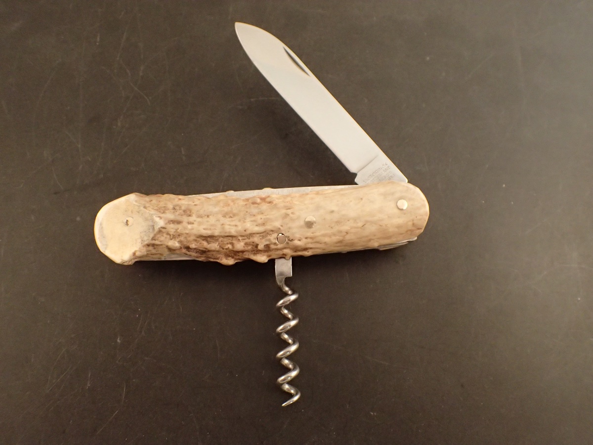

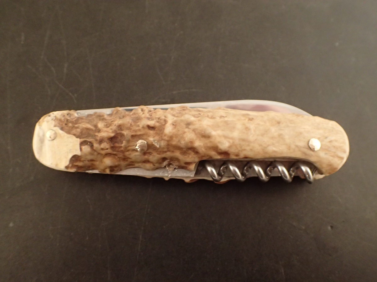

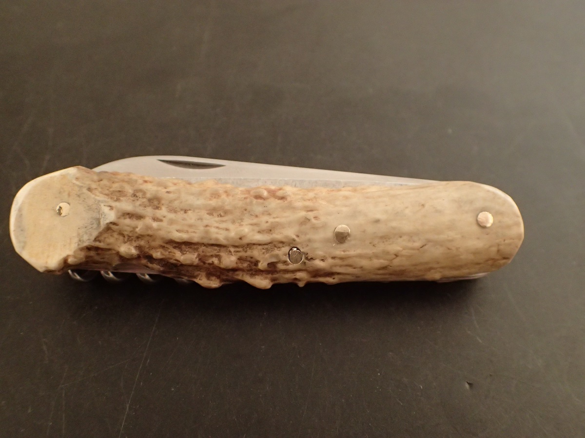

All done, and it turned out ok. I'm pleased with it anyway.
This material is simultaneously fun and frustrating to work with. It's fun because it's so easy to drill, cut, shape, etc, but it's frustrating because it presents no regular surfaces. You can see I had a hard time shaping the heads on my brass pins on the outside. But I was really just wanting a wine opener to live in the kitchen drawer, and not looking to win any art prizes.
Thanks again for the tips and advice, everyone.

Great job, with a difficult-to-work-with material!!! Go enjoy some wine!!!

That looks a lot better than I expected!
I don't mean that to disparage you or your skills, but usually antler looks best on a knife with bolsters. But you made that look good!

Thank you, Reverand and Doc B. I might try it again some day, but I'd want to use a different material, say maybe bone.
You know, I never thought about seeing antler with bolsters, but you're absolutely right. I guess because I'm an old SAK guy it never occurred to me.
It was a fun way to spend the day, and it's in the kitchen drawer now waiting for a wine-n-cheese event.

Glad to see the finished project Myron, it really turned out good. You will enjoy using it more because of the time and work you have in it. Thanks for sharing.
