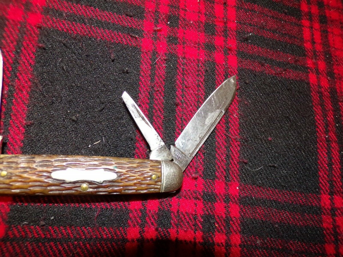

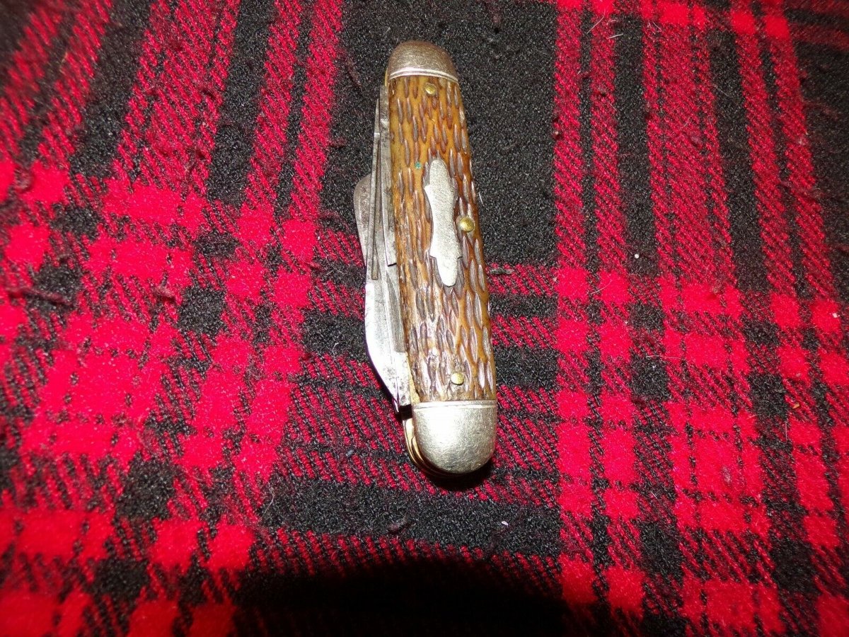

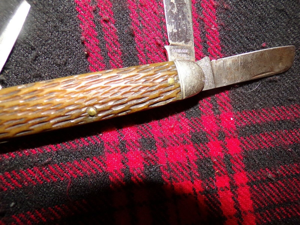

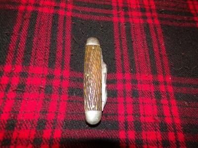

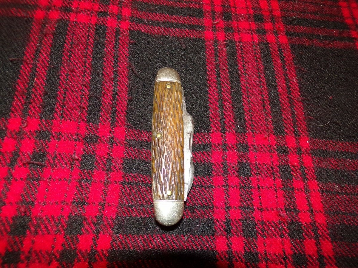

I happen to have had an unpleasant first hand experience with this knife and this seller. Bad knife, bad seller.

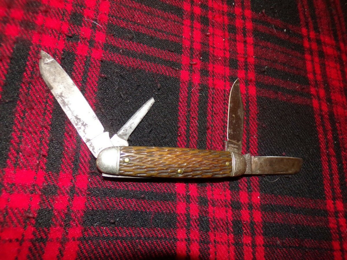

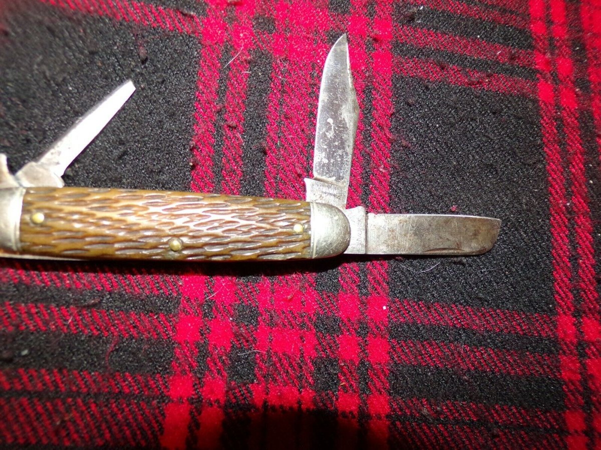

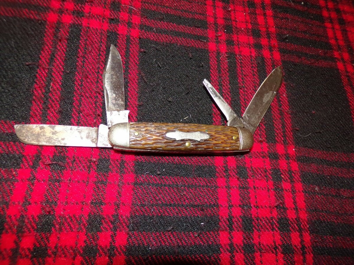

I am not apologizing for 'walking away.' I did not have time to go into detail but I wanted to raise a flag to perhaps forestall someone from posting a hasty bid before looking more closely. The frame and covers are Schrade CutCo, pre-1947, in the heavily utilized 3 5/8 inches closed equal end pattern. There is one Schrade CutCo blade in this knife, a stubby clip blade which is un-used but rusty. However I have never seen this blade type in a Schrade CutCo cattle knife. There is a worn Schrade Walden blade which appeared to be a large spear when newer. There is also a moderately worn Schrade Walden sheepfoot blade. The fourth blade is unmarked. Initial look seems to be a punch blade. It is not. It has been ground down to a sliver from some unknown blade and just barely tucks into the knife. A punch blade would not have even have been able to close. I do not think that even one of the blades in this knife originally was found in that frame. Nothing like this appears in any of the catalogs, and in the Schrade Walden years there were no 3 5/8" 'senior' cattle knives, although they marketed the 'junior' cattle knife, the 856. I had this knife in my hands, much to my embarrassment and studied it at length, coming to the aforesaid conclusions in the process. Your mileage may differ.

When you bought this knife did you know that one blade was marked Schrade Cut Co. and two blades Schrade-Walden ?
Have you ever seen a legitimate Schrade knife that had both SCC & S-W blades in it ?

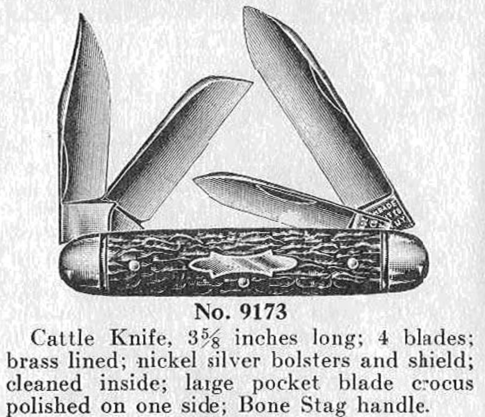

I think the knife could be correct for Schrade pattern # 9173. My 1926 catalog reprint shows the knife, 4 blade 3 5/8" cattle knife. The spear blade is way used and the blade next to the spear is an equally well used up pen blade. Unusual to see the short clip blade in such good condition with the other blades used and well used but stranger things have happened.

Wayne, what about one blade marked Schrade Cut Co. and 2 others marked Schrade-Walden ? Understandable, but i have not seen a knife with both markings.

btrwtr wrote: Mon Mar 02, 2020 1:17 am I think the knife could be correct for Schrade pattern # 9173. My 1926 catalog reprint shows the knife, 4 blade 3 5/8" cattle knife. The spear blade is way used and the blade next to the spear is an equally well used up pen blade. Unusual to see the short clip blade in such good condition with the other blades used and well used but stranger things have happened.
Good eye! Looks like a boogered-up example that has been re-bladed in odd ways by possibly the latter-day company, Schrade Walden. Why the condition of the three bad blades do not jive with the one good blade is puzzling. Anyway, it is not much of a knife at this point.

The pattern looks correct except the spear should not have a long pull. The unstamped pen blade is strange as is the blend of cut co and walden stamped blades. It's not unlikely to think some newer blades have been put in this frame.

Can't say that I recall a Schrade Cut/Schrade Walden transition knife stamping but I wouldn't rule it out. I wouldn't rule out the long pull master spear either but the knife does pose some questions that might not be answered. I'd love to get my hands on a righteous example of that pattern.

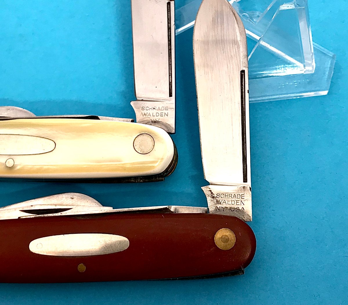

Wayne I would not rule out a long pull blade when the catalog shows a nail nick either, as sometimes the actual knives and catalog images are not exact, but the fact that is has a usa walden stamp is strange. They didn't stamp usa on the blades until the 50's.

Quote: "They didn't stamp usa on the blades until the 50's."
Thank you Paul. This is good to know.

Many sources give a either mid 1940's, 1946 or even 1948 for a date when USA was added to the Walden stamps. Not sure what is correct or where the mid 1950's information comes from but it does contradict much of what is in print. ::shrug::

It probably was the early 50s and it was more of a gradual changeover, pattern by pattern. The change of ownership to Imperial was official 4/1/46 and the first tang stamp they used was the 3 line SCHRADE / WALDEN / NY. The catalog images from the late 40s show this stamp and even into the early 50s you can still find this stamp in the catalog along with the USA stamp – but that might just mean they were using old renderings for the catalogs – they did that. A good example is this Schrade 917. The pattern was made from 1950-1953 and you can see in the pic that both stamps are found on it so we know this pattern changed during that window. When the USA was added, another thing was added – pattern numbers on the back of the tang. The ‘modern’ pattern numbers show up in 1950. Before that they were sticking with Cut Co numbers. The SCHRADE / WALDEN / NY tang stamped knives never have a pattern number on them which means the USA addition had to be after the 1950 pattern number change. I believe they started making the change around 1951 or 1952 and I’m guessing it took a couple of years to work all the old stamps out of the catalog.
On the OP knife - that is a weird little clip on there. I've never seen that on another pattern and if I didn't see it in the catalog I would have thought someone tipped it and reground to that length.

I have my info from posts by lt632ret. According to him the USA began to be added to the walden stamp around 1953 or 54. LT has a lot of information from people that were at schrade so I trust his info.
