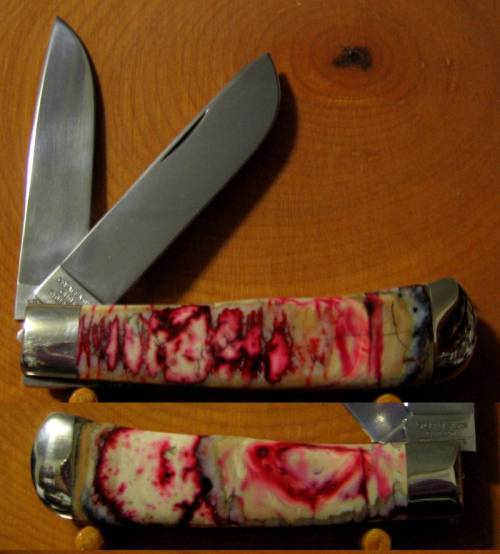

Techmans first try at Mammoth Tooth
Please be kind I did not do a great job. The tooth is pretty good looking though. I think I will carry this one because I got a desire to try it again. Off to buy some more handle material.

Looks like some of tooth from Charles Turnage. He has some nice looking stuff at the present, I always watch him and crazyfoxrb on ebay. crazyfoxrb (Ron) doesn't sell very often, usually some extra he had from selling to some top notch guys and outfits, including William Henry. Here is a piece that I bought last October.
http://cgi.ebay.com/ws/eBayISAPI.dll?Vi ... 0163789793
Looks good to me Techman, Careful - it does get in your blood real quick!

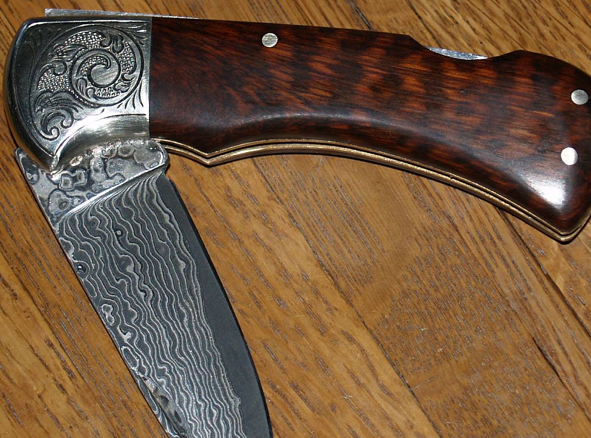

- orvet
- Posts: 19901
Nice work.
I like Snakewood.
aboard!
I like Snakewood.

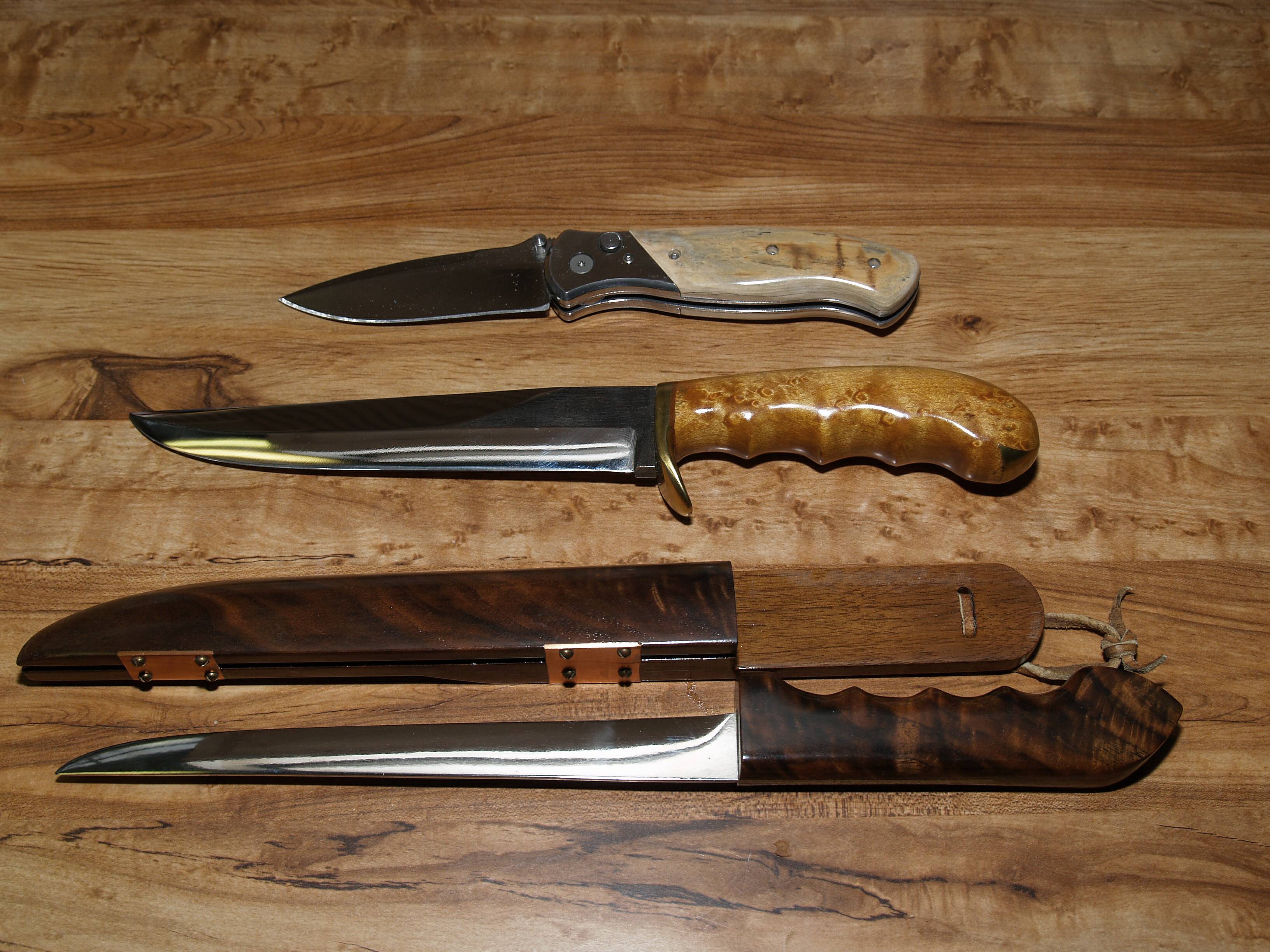

pmike5869
- Posts: 219
- Joined: Mon Dec 17, 2007 2:44 pm
- Location: Indianapolis, In
What a nice welcome!
Thx for the kind compliments and the warm welcome. Took the advice to "log in" and left more pics. This is a great site. Just started to collect sunfish and found this site a tremendous help.
