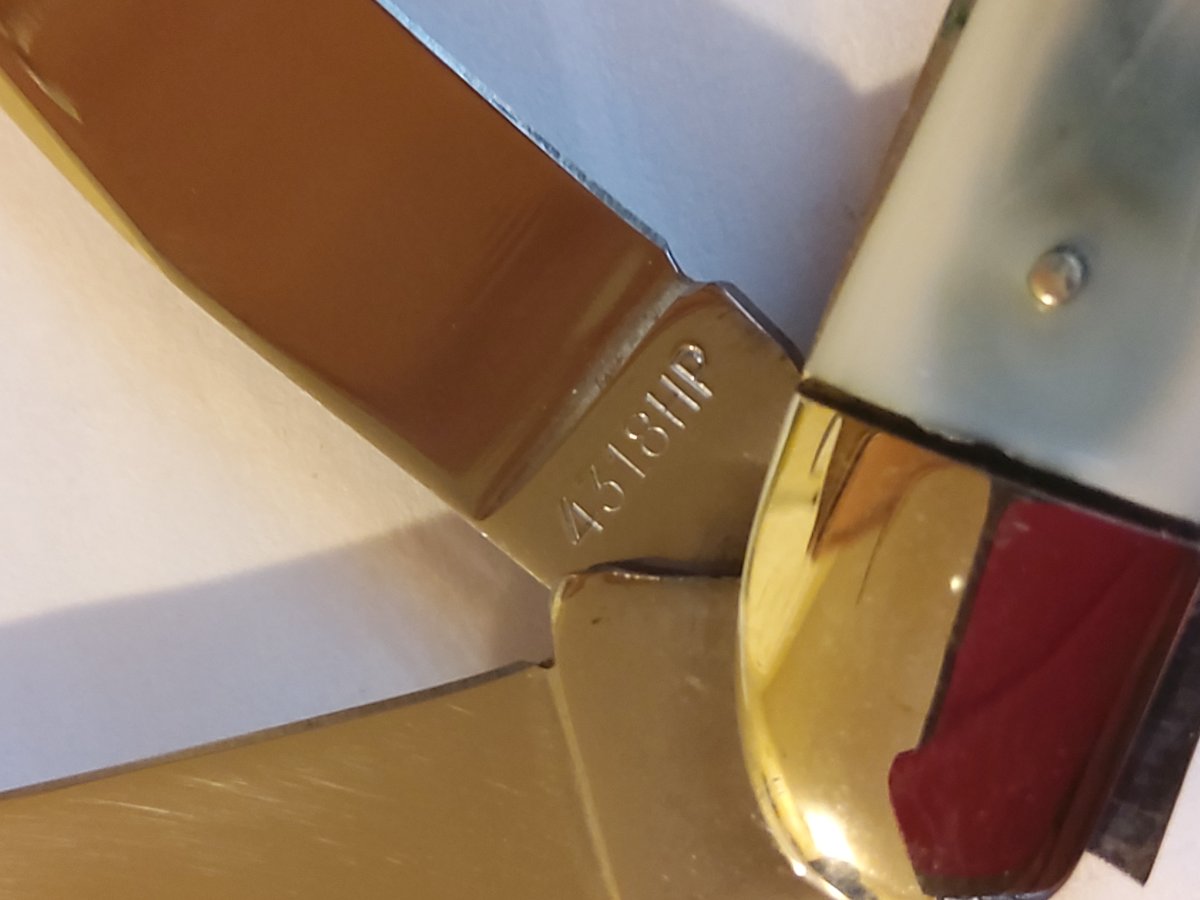

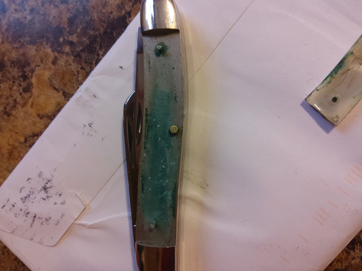

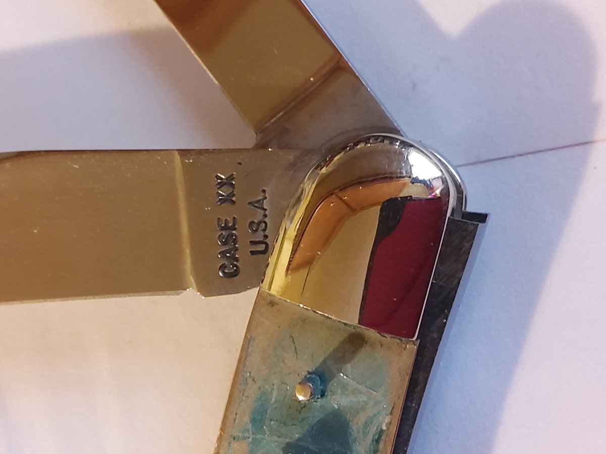

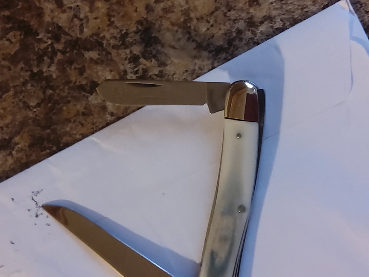

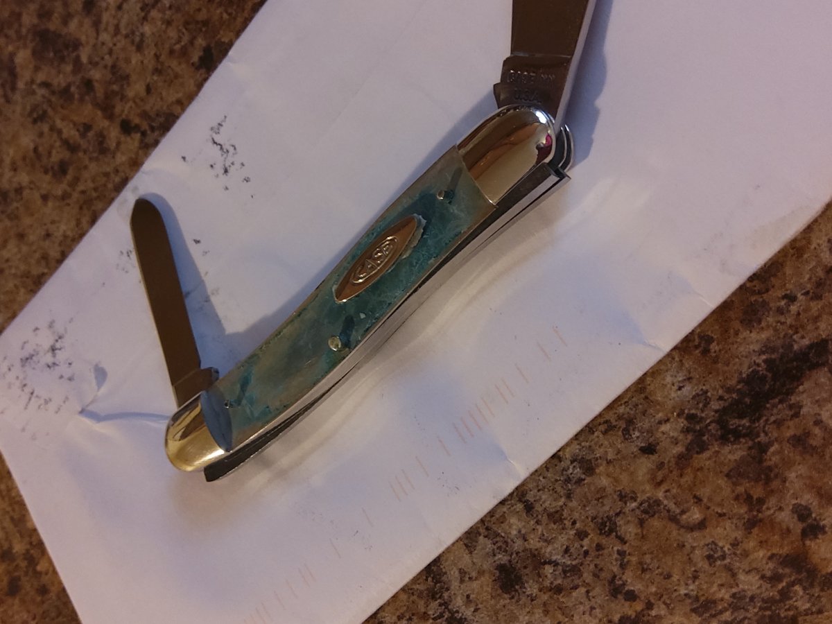

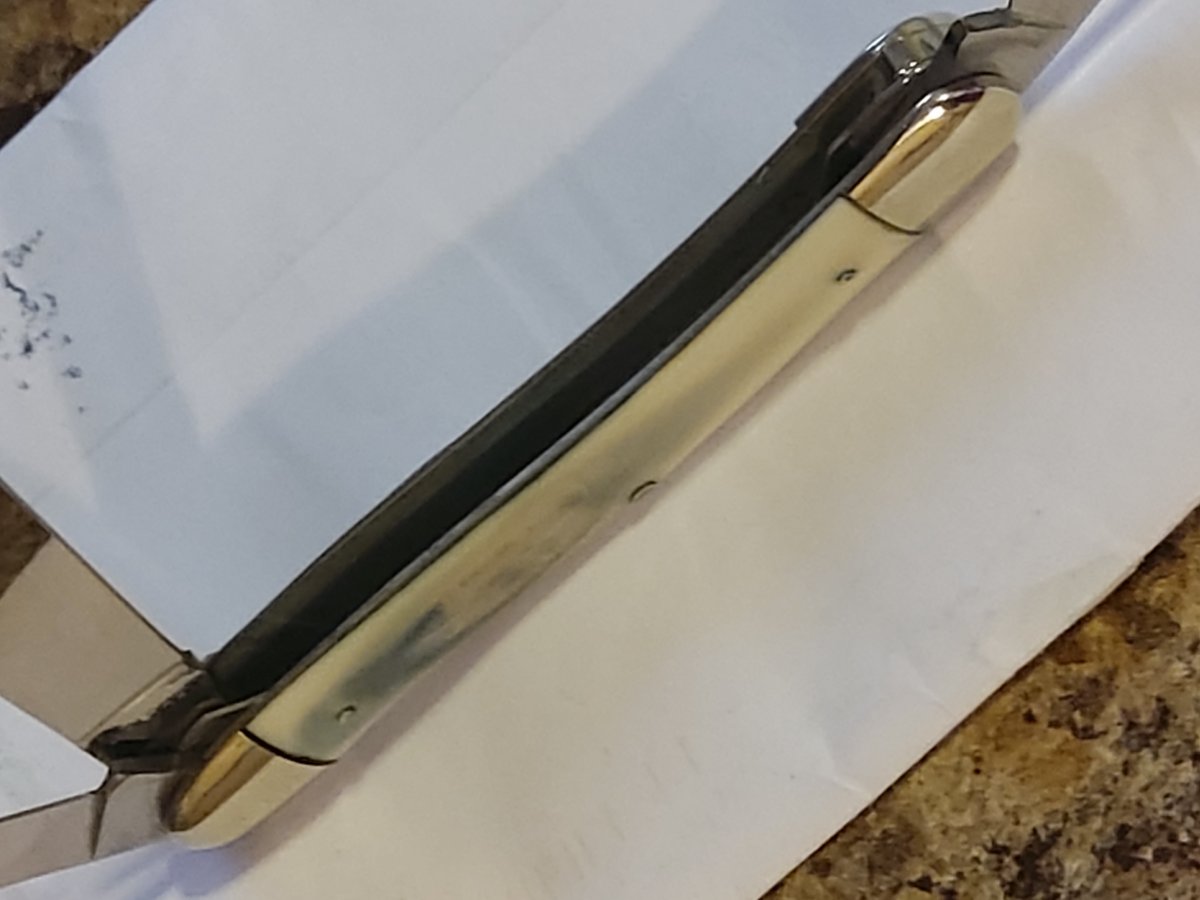

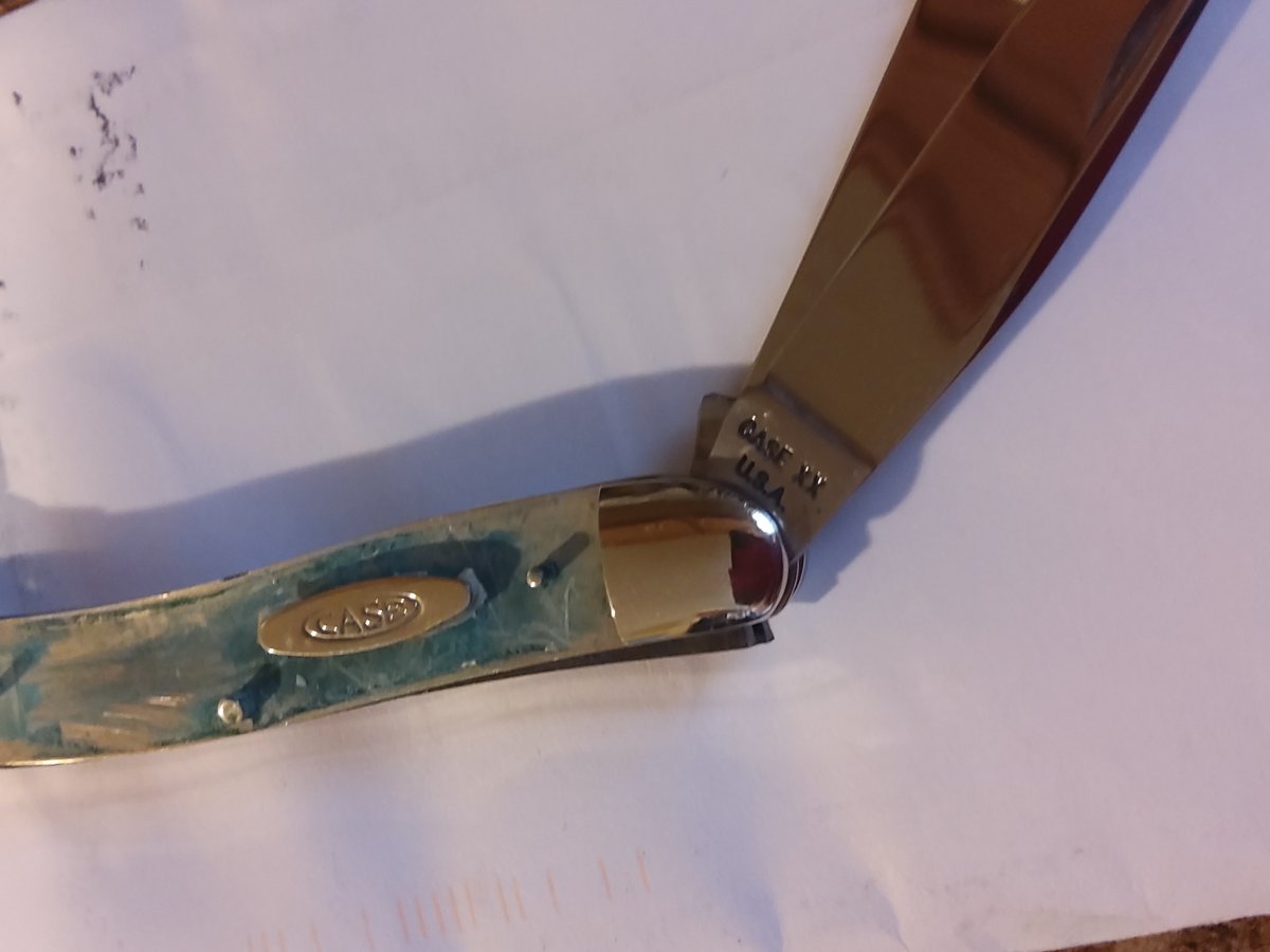

Hey, I bought this beauty about a year ago. Had minor discoloration on both sides of its white comp Handles. Going through my knives today, looking for a couple to add to my seller items, I noticed this one had gotten worse. Cracks. Shrinkage. And lots of discoloration. It also had a chemical like smell. Idk. But anyway, I took it to the garbage can and proceeded with tearing off the handles before the blades, or other knives fell victim to this possible 'gassing'. Which I didn't know would happen with white comp. Or is this gassing? Does anyone know, or have any info on what could have happened? Its a 65-69 4318hp. Very nice. Mint, all but the handles. So I'd like to repair it, asap. Does anyone have a set of white comp Handles for sell or trade, or as a gift? Or does anyone know someone who is in knife repair, and who is trustworthy? Any and all help is appreciated.

No scratches. Rust. Never sharpened or used. Nothing wrong but these darn handles. Idk what happened... I just hope I can get it fixed.
[attachment=0]20200416_162012.jpg[/attachment]

What you show looks somewhat like celluloid decomposition, but I don't think its that bad. The earlier "white composition" used by Case prior to delrin is known to shrink badly, but I don't think it is as dangerous as celluloid outgassing. It looks like a very nice knife and if you are planning to keep it, you can rehandle it with anything you choose. There are many, many interesting possibilities. if you want to stick with white, and synthetic, white linen micarta might be nice. I have seen a modern, synthetic ivory product for sale , but I haven't used it.
