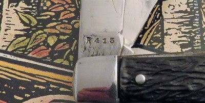

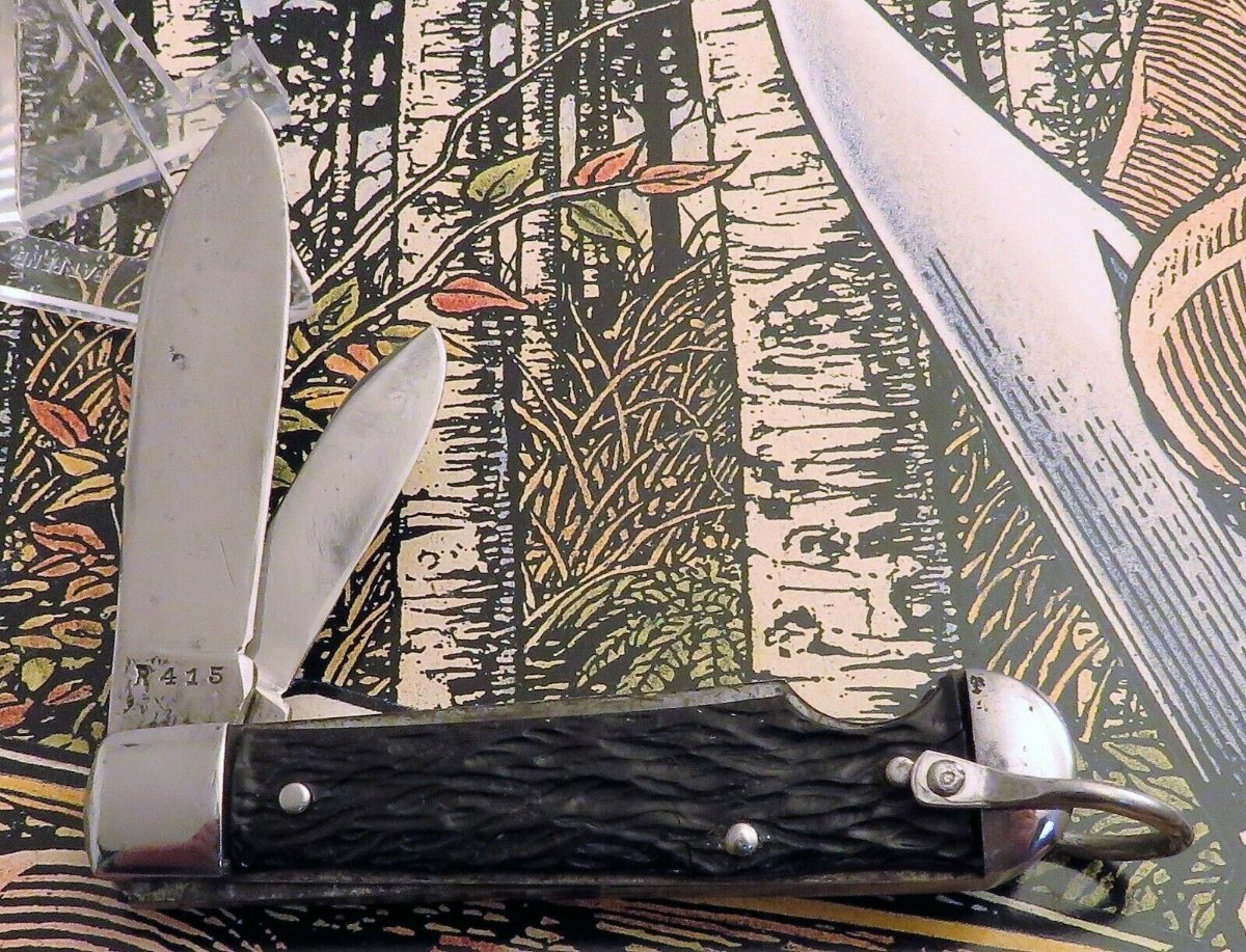

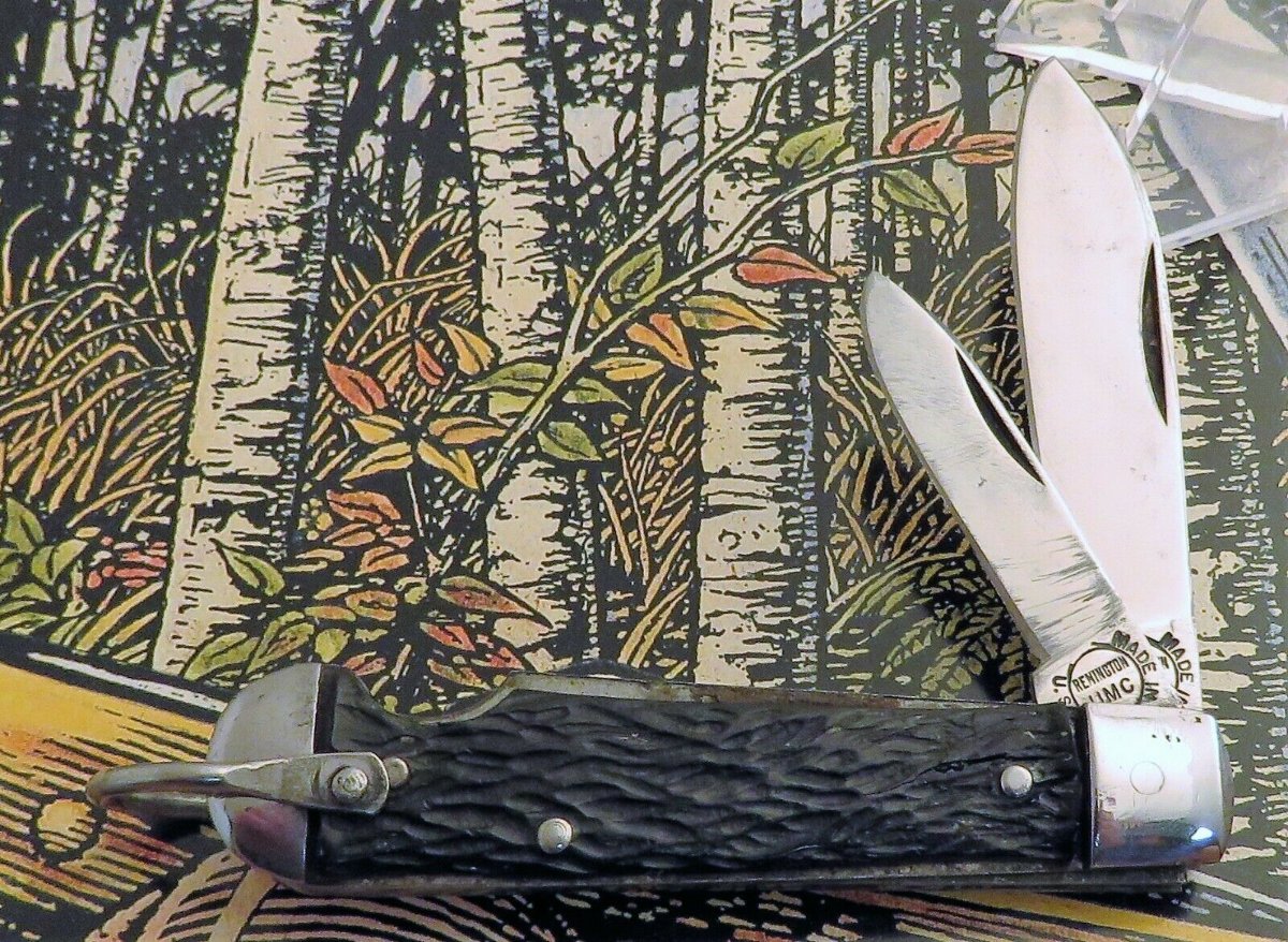

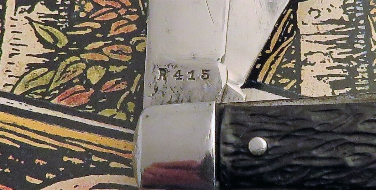

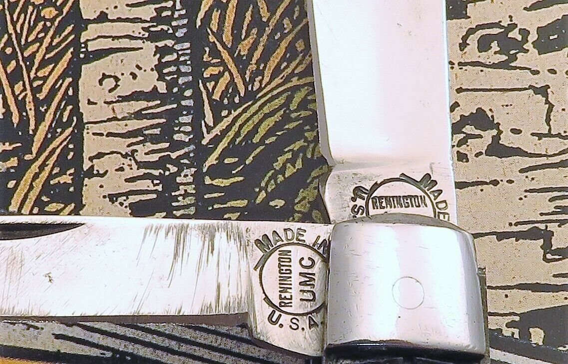

Anyone have any thoughts on this Remington R415?
Here's the link to the listing - https://www.ebay.com/itm/Remington-UMC- ... Swq2hemeSt
Here are the pics:

I think they should know better than to list junk like this.

I agree, not much about that that looks Remington to me.

Not vintage pattern numbers stamp, not a Remington bail, to small of a easy open cut out, could be correct handles, as they used those type of handles, tang stamps look modern. Not much going for it that is right.
And a R415 should have pyremite handles with no bail.

I believe it is an Imperial brand knife with fake and poorly marked Remington blades. Nothing really Remington about it.

The Stewart and Ritchie book lists a R415 as having a bomb shield. That handle material kind of resembles the black composite I've seen on some straight line Remingtons, though I've never seen it peeling away that badly. The blades look new, despite corrosion on the tangs. The tang "stamps" look as though they were etched using a resist where the circle was drawn twice for some reason and the M in "made" is really wonky. The numbers are in a font I don't believe I've seen in any Remington number stamp, and I've never seen them that out of line/poorly spaced.

The frame really looks like an Imperial, the pins and bolsters look like they match up perfectly. The number stamp looks like the original was ground off and then cold stamped individually. ::barf::
