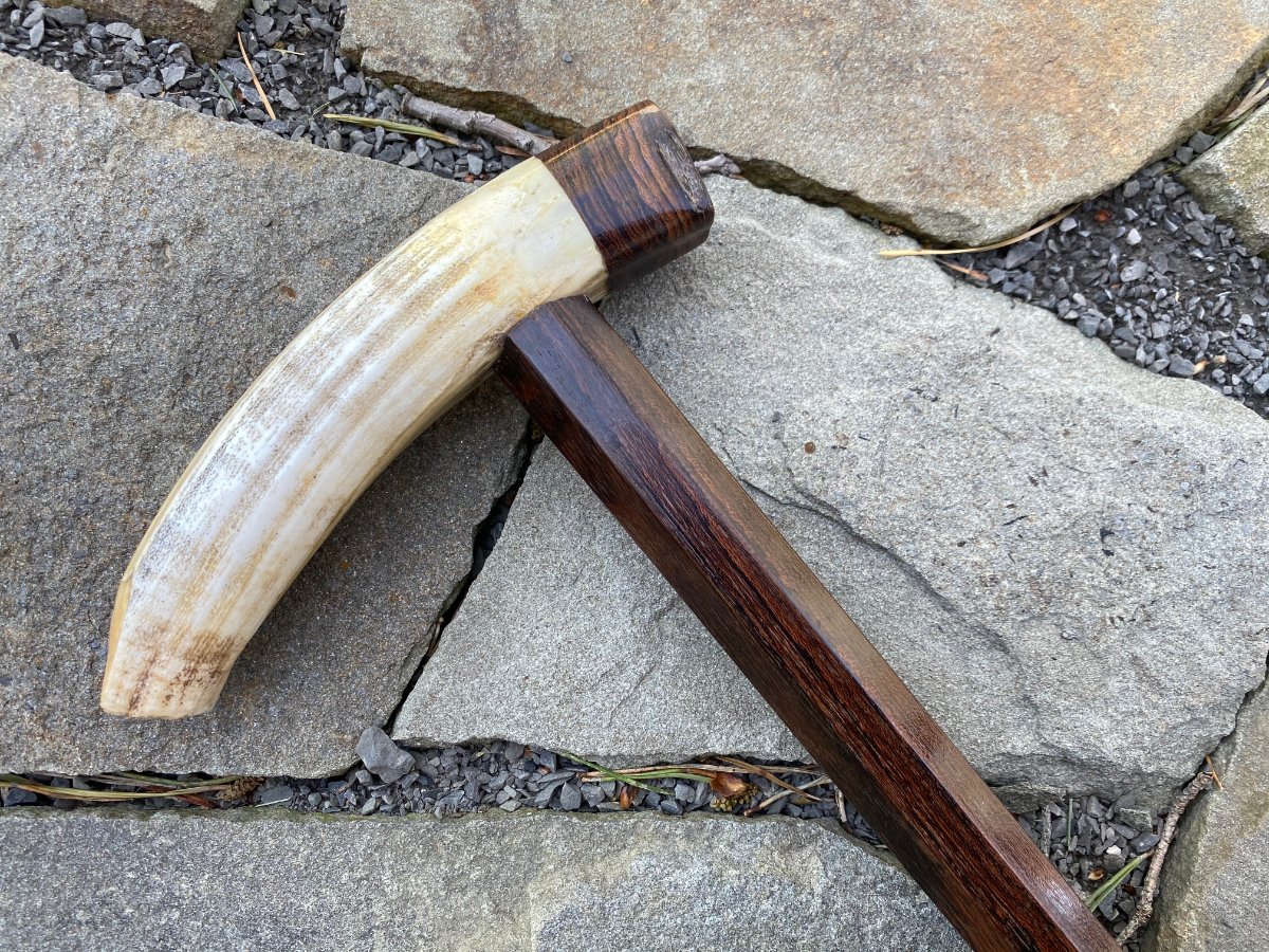

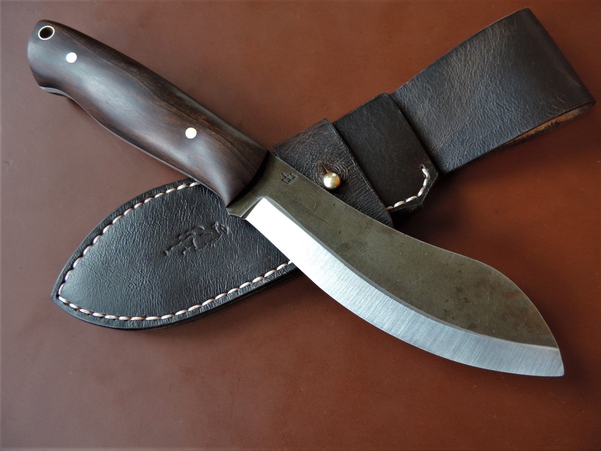

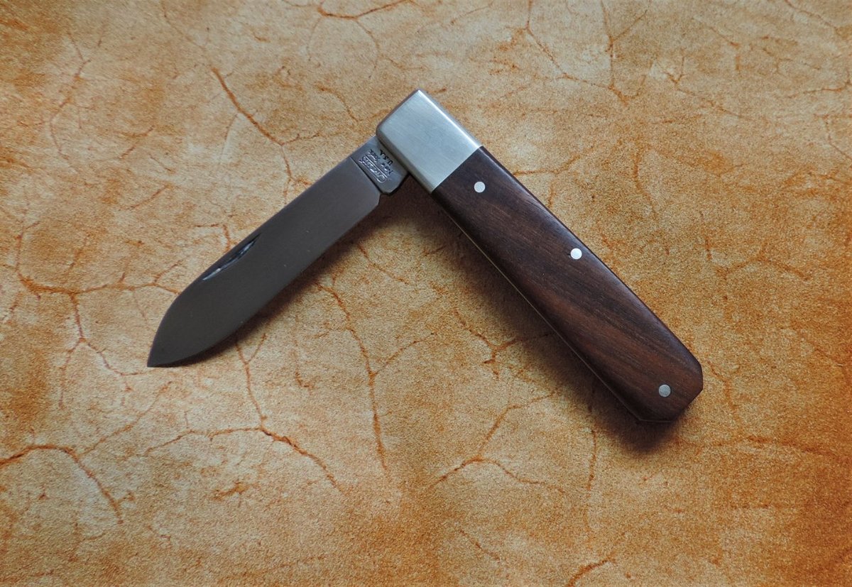

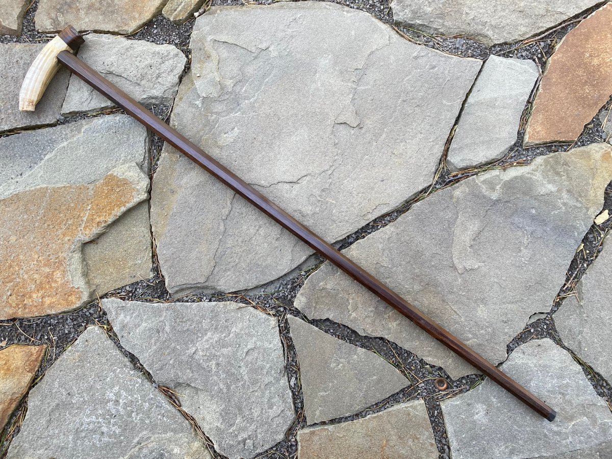

Just some Pics
Australian Gidgee to 600 grit and fondled (just the natural 'oils' from my hands) Sheoak (top) and Walnut Birchwood Casey Tru Oil
Desert Iron Wood Tru Oil With Tru Oil I get the best results using just a tiny tiny drop and working it in with my thumb or heal of my hand to the point where in generates friction heat... let it dry thoroughly and repeat up to 8 - 10 coats over several days
I generally use a sanding sealer when I get down the the finer grits and then use the tru oil
Derek

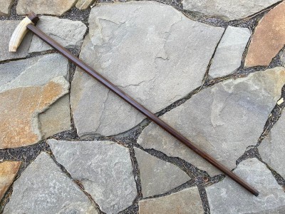

I have used bacote for knife handles and it finishes and buffs out nicely. In my experience not as oily as cocobolo, not as hard or prone to cracking as ironwood. Sealing the wood helps to preserve the color contrast and handling will ultimately darken the wood if not sealed. Texas Knifemaker's Supply used to carry a spray on and buff off sealer that I have used in the past but they no longer carry it. I have used ultra thin super glue as a wood sealer with good results by hand finishing with 0000 steel wool.
https://www.texasknife.com/vcom/product ... 8cd194621f
Here is a cane that I made with bacote wood and a hippo tusk handle.
Wayne
Wayne
