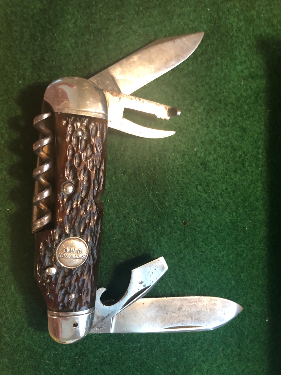

Remington Scout R3843 Bail Repair
Good Afternoon!
I have a Remington R3843 which is in fine condition, save a bail which is completely detached from the knife. If this were a simple straight pinning job, I could handle it, but theses bails are attached with 2 small pins, and I have no experience doing this. So my question is - Is there anyone here who would be willing to help me out with doing a professional job, either for monetary compensation or trade?
Thanks - Bill
Thanks - Bill

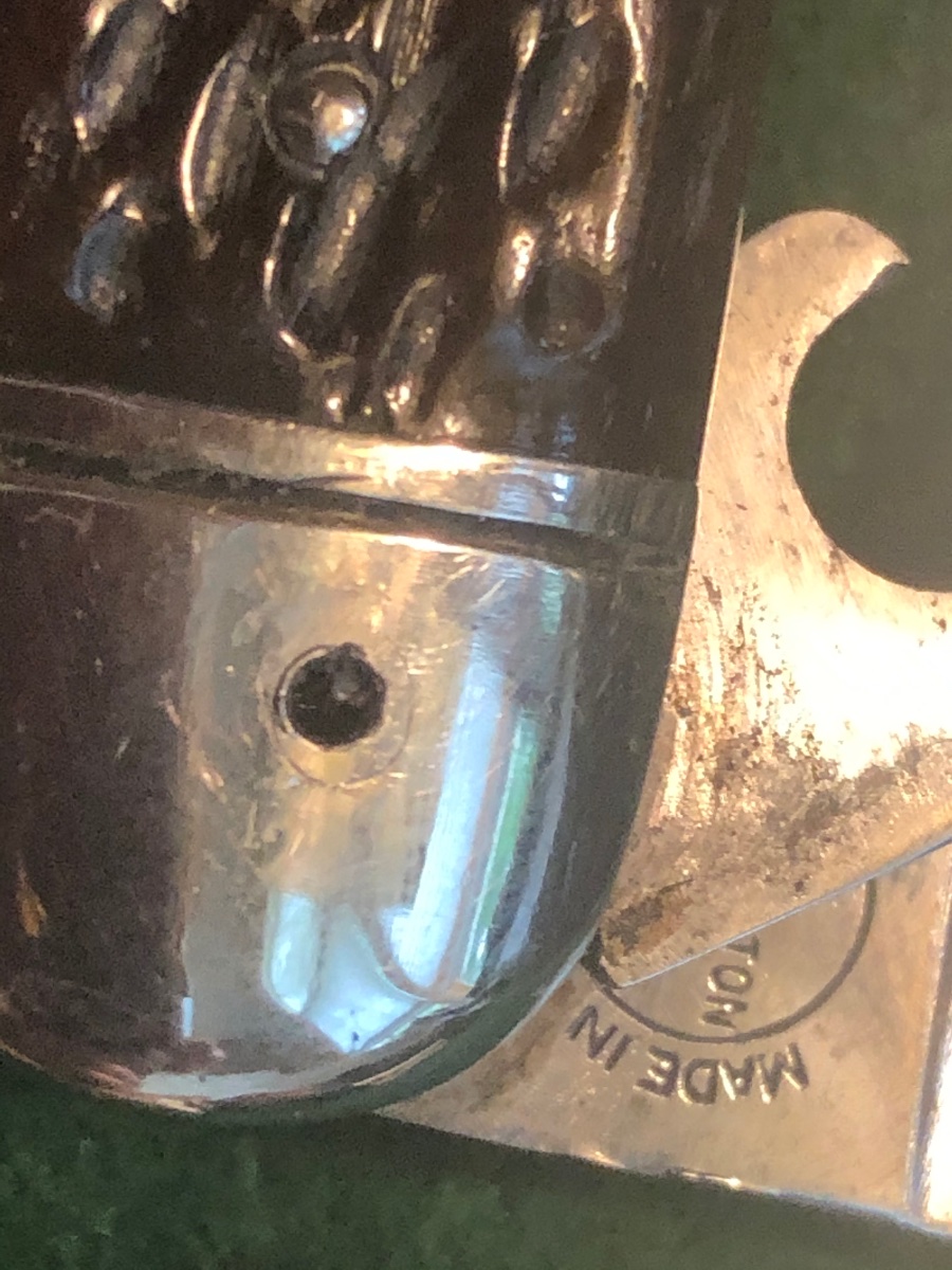

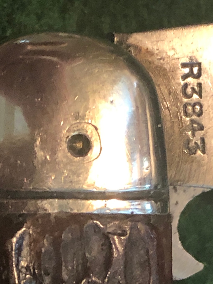

Re: Remington Scout R3843 Bail Repair
IMO the knife has had a previous repair and the pivot pin replaced . I see a peened over silver pin , it should be a brass Hollow tube pin And the bail pin goes threw that .
Now the replacement silver pin will need to be removed and replaced with the correct parts in order to have a bail . Not a simple fix now .
That looks to be a very nice R3843, so not an inexpensive knife. So please be careful and gentle with it! Hate to see such a nice specimen damaged.
This is the common set up on these. I'm sure Kaleb has done hundreds. Drill the old pin out. Then there is a hollow brass tube you can buy at Hobby Lobby that goes in. If you ream the hole with a 3/32" pin reamer the hollow tube goes right in. Then the 1/16" pin stock goes through the hollow tube and you peen a head on each side. You'll have to find you a bail. Isn't this right Kaleb?
Men make plans and God laughs
- muskrat man
- Posts: 5684
- Location: Ohio
Yes, most higher end scout knives from the pre WWII era (not exclusively) were assembled like this. I prefer this construction also, makes bail replacement easy and independent from the pivot pin.just bob wrote: ↑Tue Jun 16, 2020 7:41 pm This is the common set up on these. I'm sure Kaleb has done hundreds. Drill the old pin out. Then there is a hollow brass tube you can buy at Hobby Lobby that goes in. If you ream the hole with a 3/32" pin reamer the hollow tube goes right in. Then the 1/16" pin stock goes through the hollow tube and you peen a head on each side. You'll have to find you a bail. Isn't this right Kaleb?
