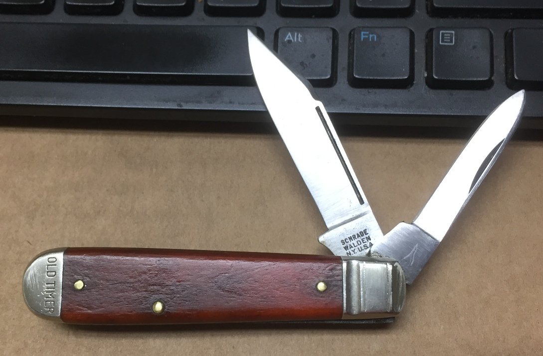

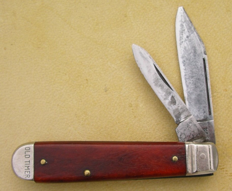

I've had these 2 for a while. I got the 2OT from Roland last year (I think) and it was my first 2OT so I was a little skeered to mess with it.
When I got it, it was in really nice shape for a knife you just can find. Even though the main blade was tipped..... I was proud to have it.
Somehow, I must have got a good dose of intestinal fortitude. SO, it was time to put a tip on this guy.
Here he is before....
I took my time, I made sure I didn't take off too much.... and here he is with a good shine-up on both blades.....

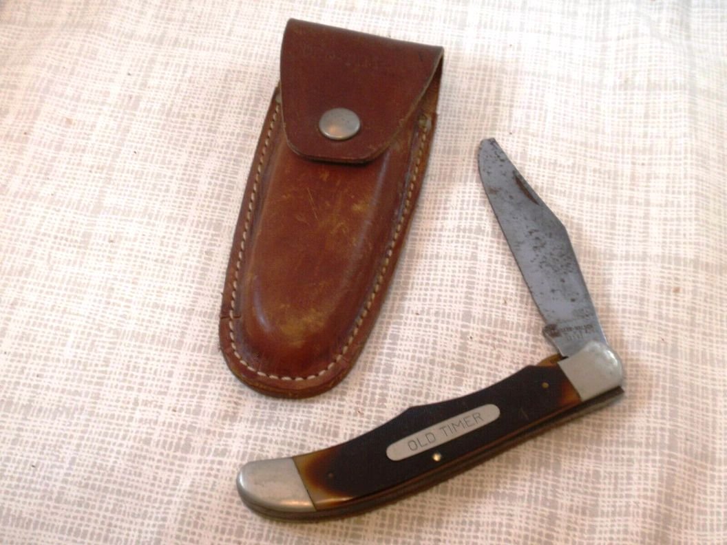

Then, after that one, I remembered this Schrade-Walden 125OT that had been sitting in my project box and it was also in need of a new tip.

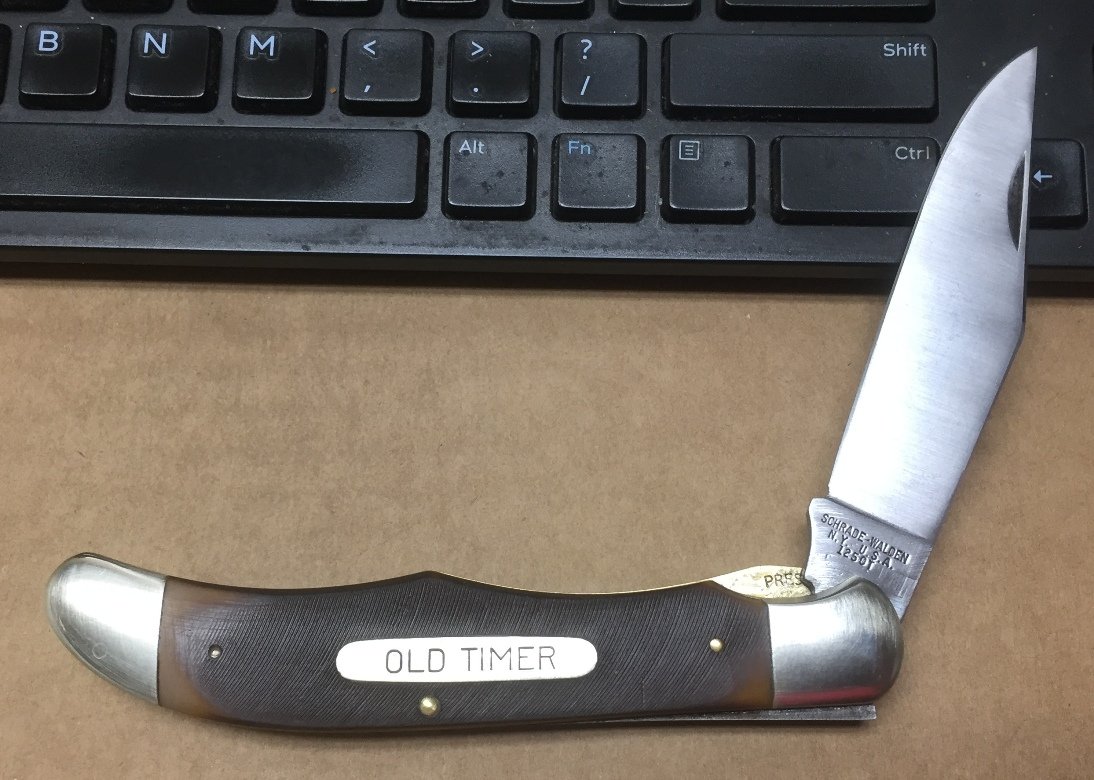

Who ever originally bought this knife must have broke off the tip EARLY and put it in a drawer. Other than the surface rust, there was NO blade wear. Here he is with his new tip.
I was happy with the way they turned out. The 125OT was the one I wondered if I could put a tip on it and still have a decent looking knife. The nail nick was so close to the top, I was worried I wouldn't be able to get a decent tip on it without getting INTO the nick.
Well, I did and the tip is even inside the blade well where it belongs!

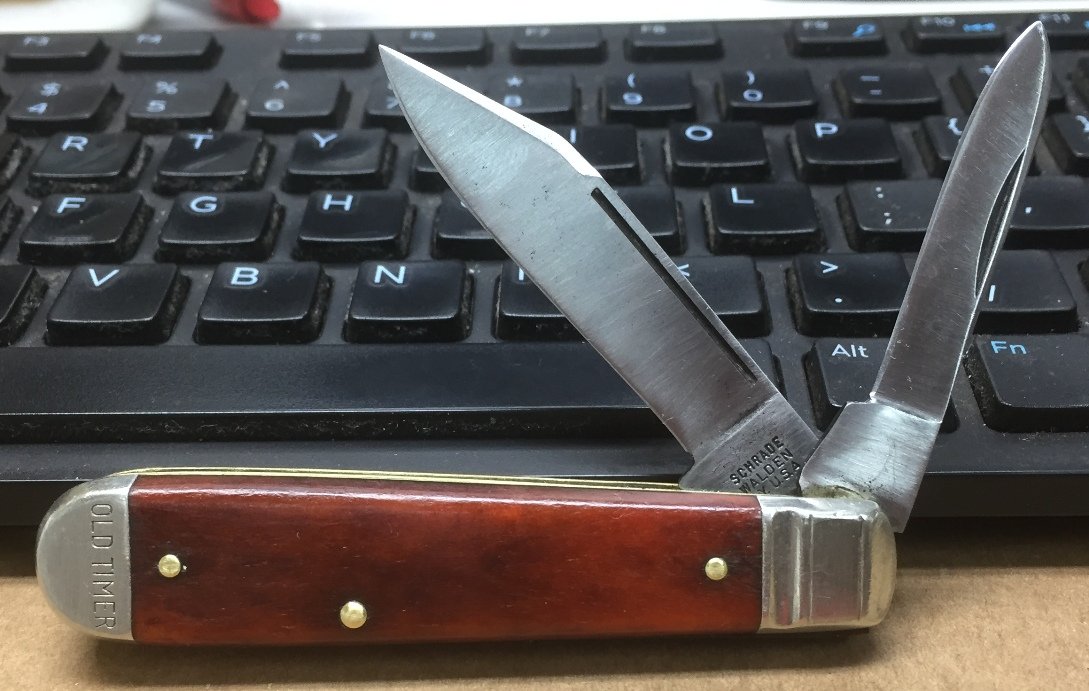

Here is a better pic of the 2OT.....
Maybe one day I will learn how to take pictures.....
::dang::
Thanks AGAIN Roland for selling me this nice example of a 2OT for my collection.
