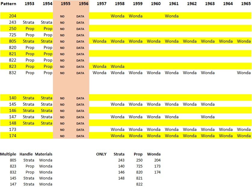

The engineered wood phase at Schrade ran from 1953-1965, a period that was chock full of experimental materials. The plastics were brought in to phase out bone but I have never understood why hardwood started to get replaced by plywood. Maybe there was a shortage or price spike? Maybe it was to create something that stood up to heat or moisture better (I have no idea if it did)? Going by the catalogs 1953 is the year they introduced Stratawood and Propwood. There is no catalog data available for 1955 and 1956. In the 1957 catalog Strata and Prop are both gone, never to be seen again. They were replaced by Wondawood which appeared every year until 1965. As I was putting this together I searched for clues to help figure out which material is what but there's so little to grasp and these guys were nothing if not vague with catalog entries.
First up is a chart put together strictly from catalog data. It shows all of the patterns with one of the three materials and for each year how it was listed. Some patterns were only Prop or Strata or Wonda and some were listed with more than one type of wood depending on the year it was made. Out of 17 patterns, 12 were only listed with one material and 5 were mixed. I highly doubt the catalogs are telling us the whole story.

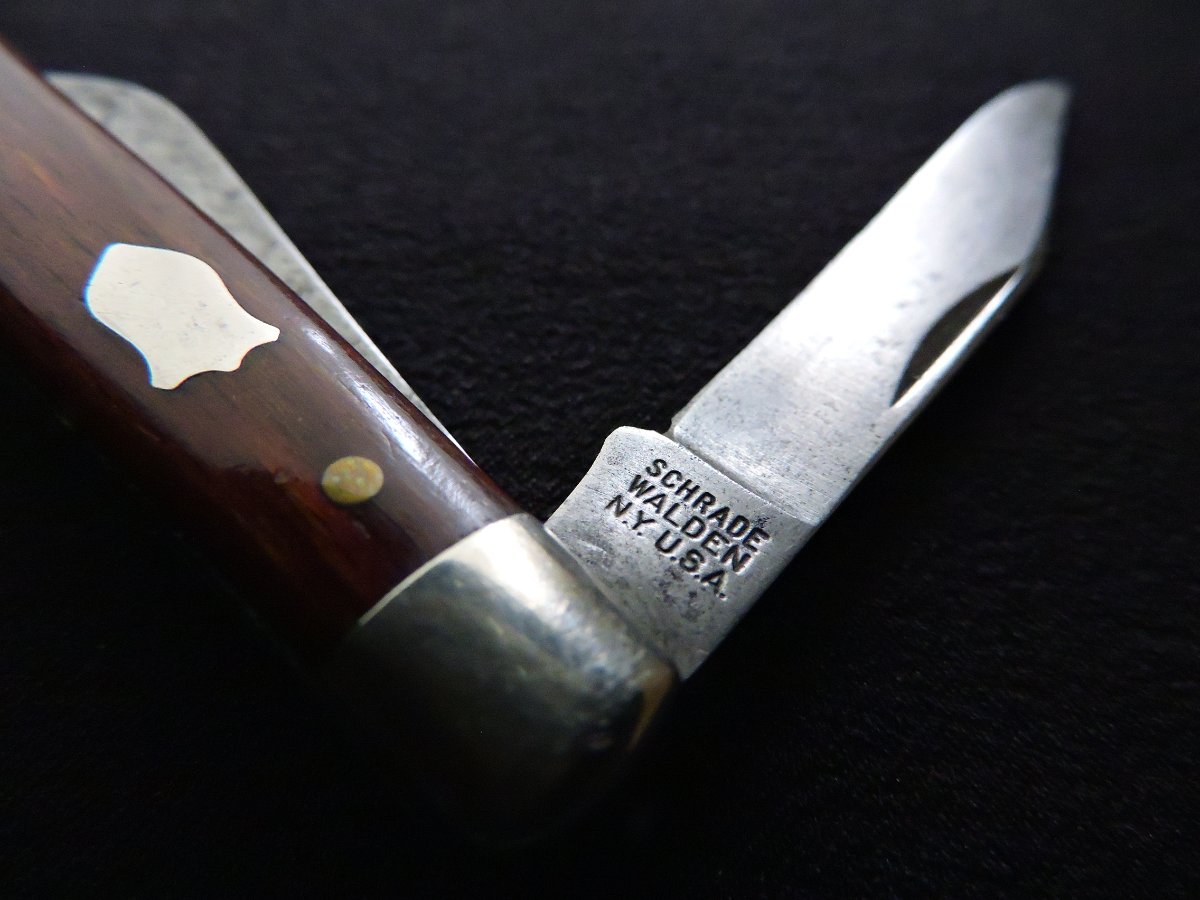

In this pic we see a couple examples of Stratawood only (according to the catalogs) patterns. The 140 and 148.

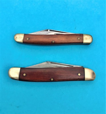

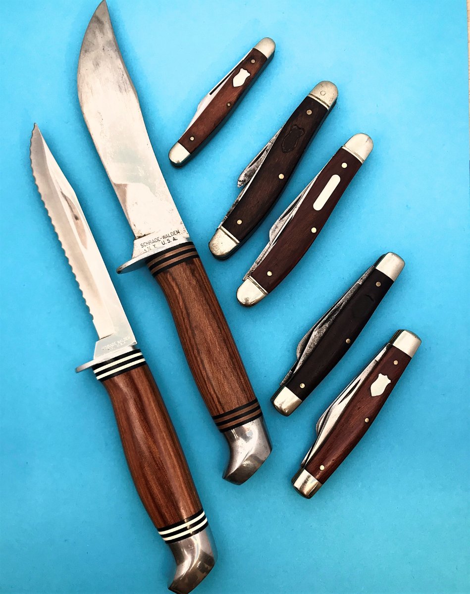

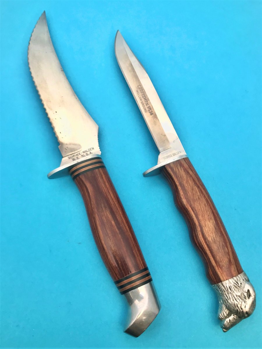

In the next pic are a few examples of Propwood only (according to the catalogs) patterns. The 250, 820, pair of 822s and 823.

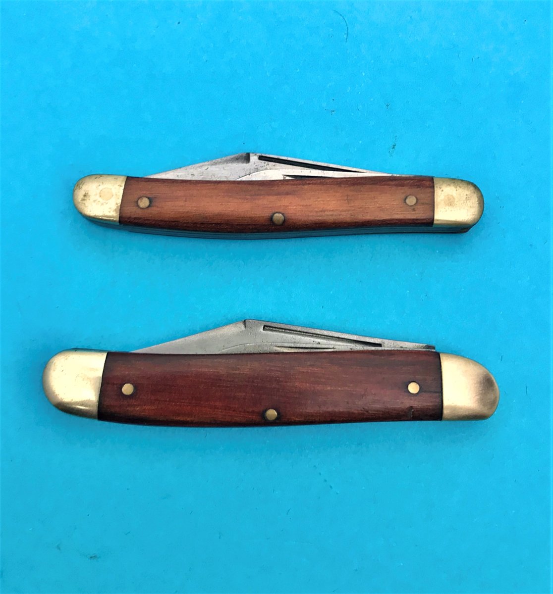

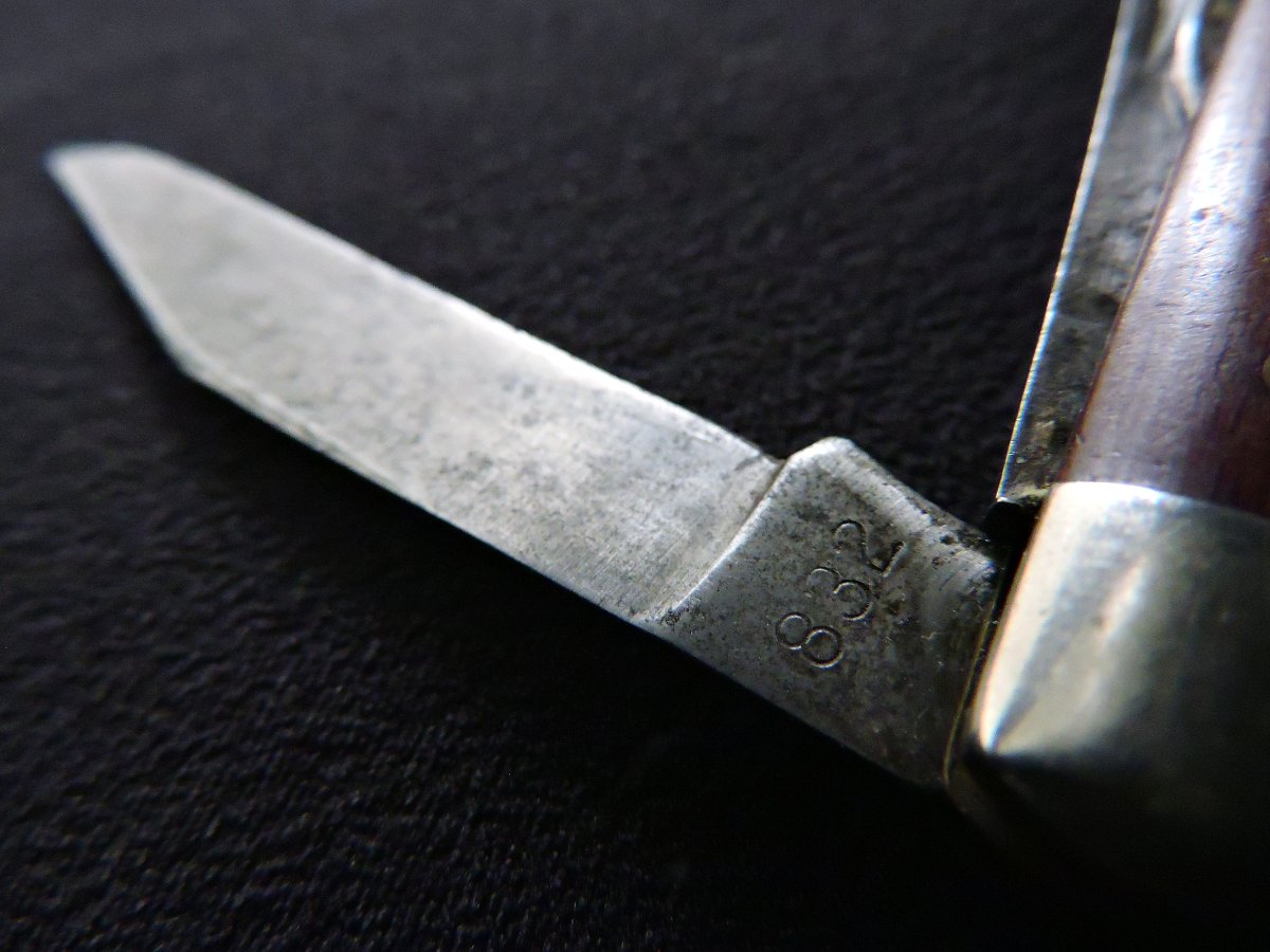

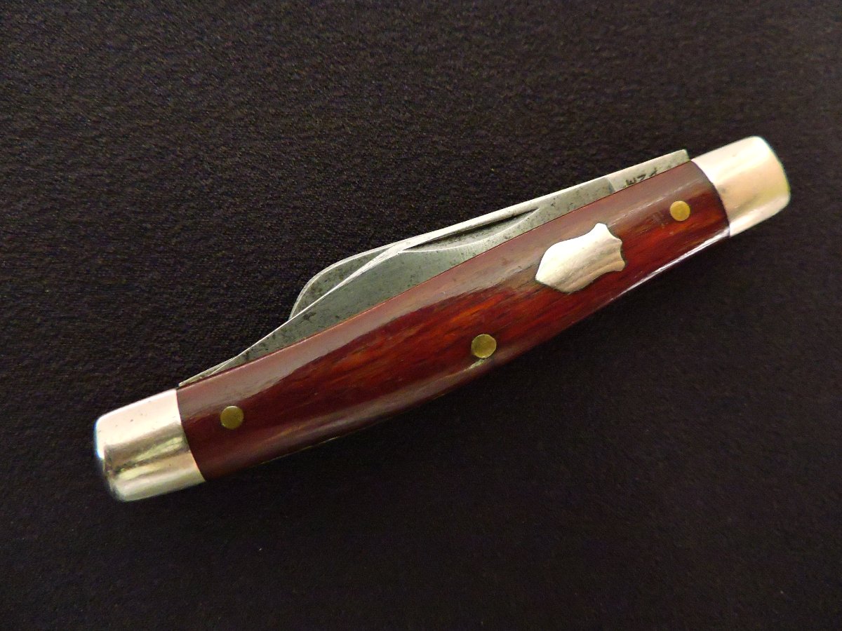

Here is a group of knives that were listed with multiple woods. The 145, 147 and 805 could be Strata or Wonda. The 823 and 832 could be Prop or Wonda. Those last two patterns show 2 examples of each in the pic. Each pair has a medium color knife and a dark knife. Maybe this is an example where we see the same knife from different years with different handles. Or maybe not..

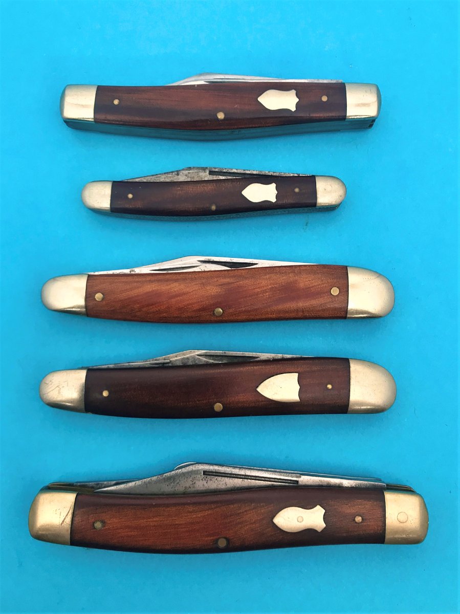

The last pic here is a couple of my favorite Ulster patterns, a 50 and a 40. I have no way of knowing which material they are but I’ve always thought of them as Propwood. I’m not aware of any Ulster catalogs listing knives covered in Prop/Strata/Wonda.

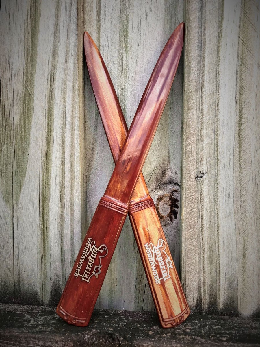

Thanks for the comments here guys. I learned a few things when I was putting the info together which is always a plus in my book. I'll add this picture here too. These are Imperial Wondawood Letter Openers but funny enough, they made these out of plastic.
