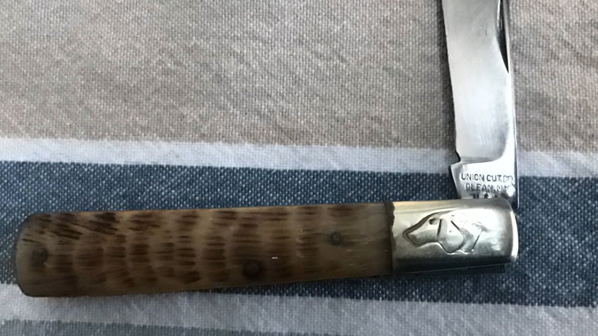

Wondering if anyone has ever seen a Dog Head like this. 4 7/8" closed, nice jigged bone, tang stamped "Union Cut Co. Olean, NY, U.S.A.".
It,s hard to see in the pics but the Dog's Head has the KA-BAR stamped in it.
I've owned it for 35+ years and it was old-looking when I got it. Never seen another with the Dog's Head engraved in the bolster. One common opinion I've gotten is that it could be a "lunchbox" made by an employee. Appreciate any comments.J.O'.

I'll start by saying,
to AAPK!
Don't have any knowledge of your knife but I'll say I like it! What kind of a blade is on it? If you don't mind, Ridgegrass, post another picture of the whole knife, please sir.
The blade grinding at the tang almost reminds me of the Case knives with the "new grind" that was used a couple of years back in the 80's.

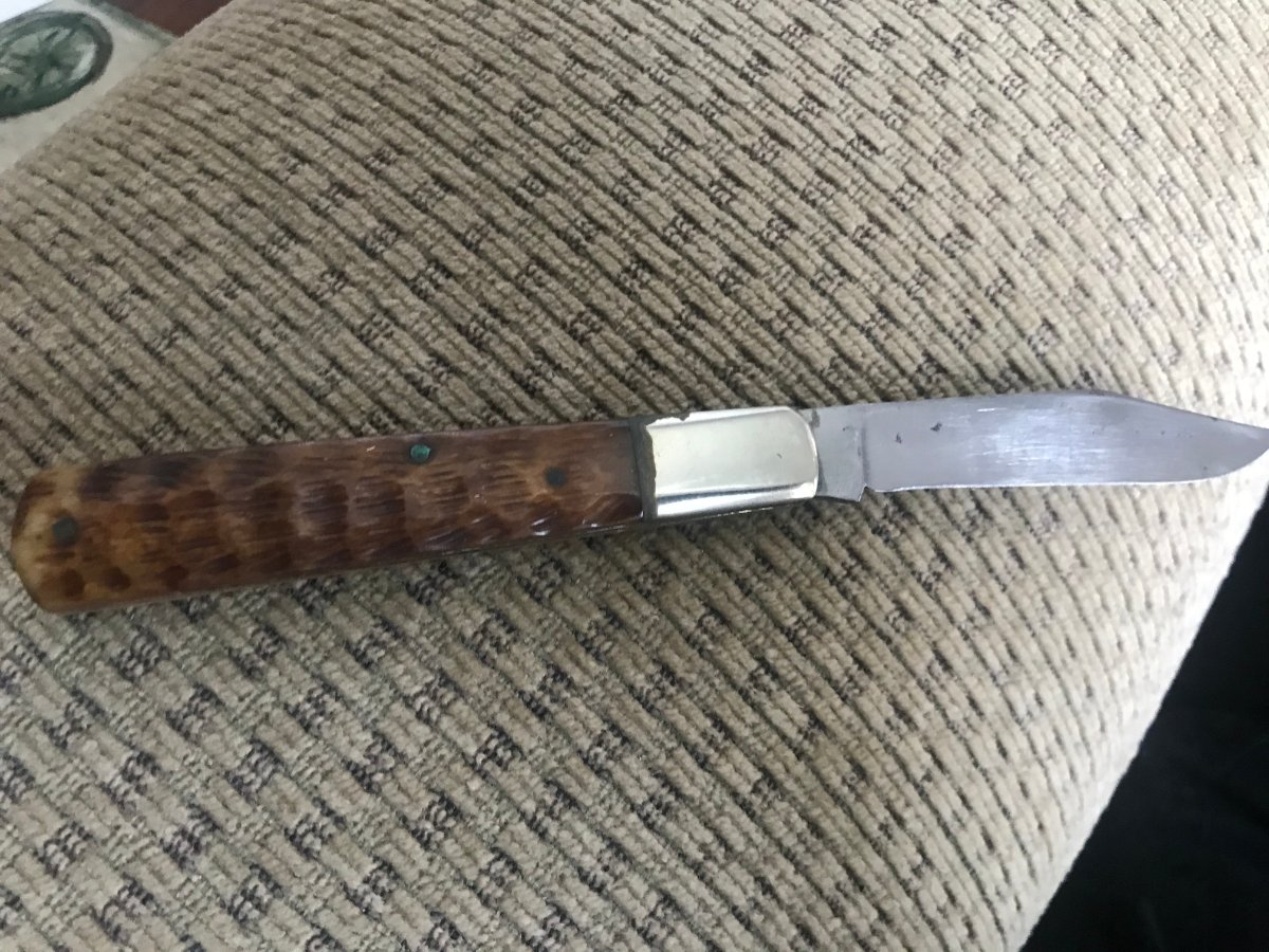

Here's a full pic. The first one is deceiving: the grind is straight, not like the Case style. Thanks for the compliment! J.O'.

I just looked at one reference book that shows about 150 older Ka-Bar patterns and yours was not among them.
You caught the Ka-Bar name on the dog's head bolster stamp very well in one of the last pictures.

I’m not a KABAR expert by any means but that jigging is unlike any I’ve ever seen. I’m thinking it’s a possibly a homemade job.
- Posts: 2935
- Joined: Fri Feb 28, 2014 5:25 pm
- Location: Lower Hudson River valley, N.Y.
Re: Dog's Head Oddity
I heartily agree with Ken. Union never used jigging like that and also the blade doesn't have any nice top grinds or "swedges" as a Union Cut knife would have. Somebody made this up and it wasn't done at the factory. I'd have to call it counterfeit.

That handle goes with the blade perfectly

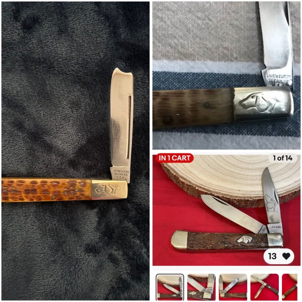

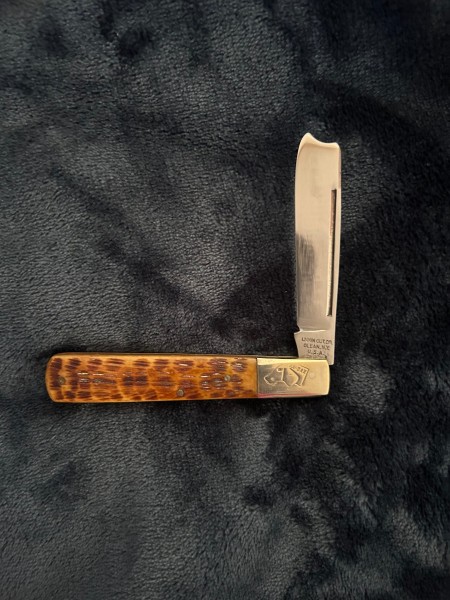

I’ve searched everywhere and this is the first one I’ve seen similar to this one. Would appreciate any additional information that may have surfaced since it’s been a while since this was posted.

They both look suspiciously new.

Ridgegrass and gunsil I was just scanning through eBay checking out the dog pound and ran across this dogs head. The jigging on it is somewhat similar to the ones that myself and ridgegrass had. I must say that something about the dog tang stamp doesn’t look quite right to me but I really don’t know why. Would love to hear either or both of your opinions on it as they are asking close to $500 for it. In the photo I’m attaching it is in the bottom right corner, the other two are mine and ridgegrass’s. Thanks in advance and HAPPY NEW YEAR!

These are all phony pieces of garbage, not even close to any genuine KABAR knives, either vintage or modern.Crappieho wrote: ↑Fri Dec 27, 2024 8:50 pm Ridgegrass and gunsil I was just scanning through eBay checking out the dog pound and ran across this dogs head. The jigging on it is somewhat similar to the ones that myself and ridgegrass had. I must say that something about the dog tang stamp doesn’t look quite right to me but I really don’t know why. Would love to hear either or both of your opinions on it as they are asking close to $500 for it. In the photo I’m attaching it is in the bottom right corner, the other two are mine and ridgegrass’s. Thanks in advance and HAPPY NEW YEAR!B8CDB8BF-6346-444E-915E-EA6FC645CE41.jpeg
In regards to the antique pre-1940 KA-BAR dog heads, none were made in small patterns (barlows, jacks, stockmen, 4-1/8" trappers, etc.). All vintage dog head patterns were the large folding hunters, swell centers, "banana" style hunters, and the "Bullet" style jumbo trapper. There were a limited number of patterns and handle materials used for the originals (I don't have a complete list, maybe someone else does).
Yes, some modern dog heads were made in the smaller patterns in the 80's and 90's by Queen and Camillus for the KABAR collectors club and for SMKW, so it is important to know the difference between these and the "real" dog heads.

Knifeaholic and Mumblypeg I appreciate both of your responses. I have resigned myself to accepting that my bolster stamp isn’t real. And I wasn’t going to buy the one on eBay. The problem I have is exactly what knifeaholic references, tha I need to be able to know the difference between genuine and fake. I just don’t know how to “know” that. I do get gut feelings but that’s all I’m going on. Wish somebody could tell just a couple of things to look for that would make me “know” for sure. Unfortunately it may just take time and experience and possibly getting burned a couple more times lol. But please know that I really do appreciate everybody that responds to my inquiries. Y’all have all been so kind, even when correcting me. Couldn’t ask for more patient teachers!
