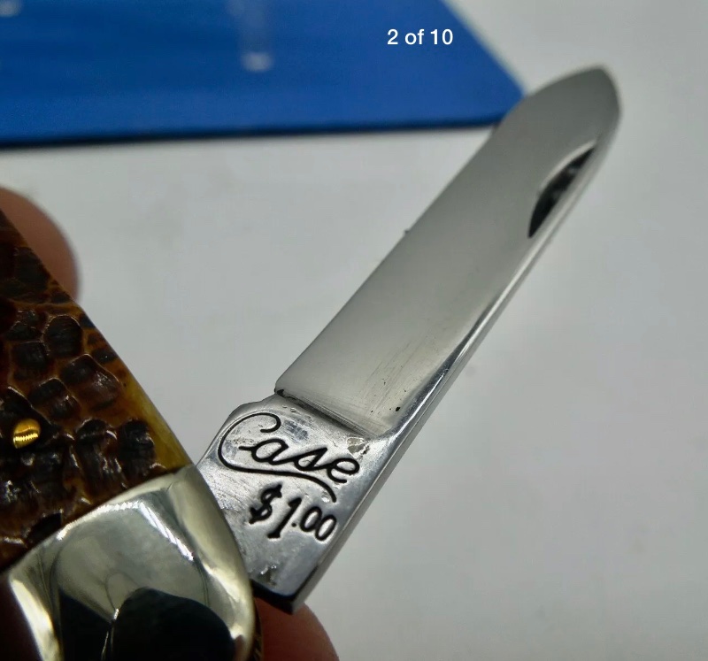

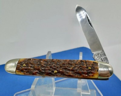

Anyone see this one
www.ebay.com/itm/VINTAGE-RARE-CASE-TEST ... Sw6Jpfbg-l
The seller also has the 75 cent, 50 cent and the 25 cent. Wonder if he also has the very rare 15 cent variety?

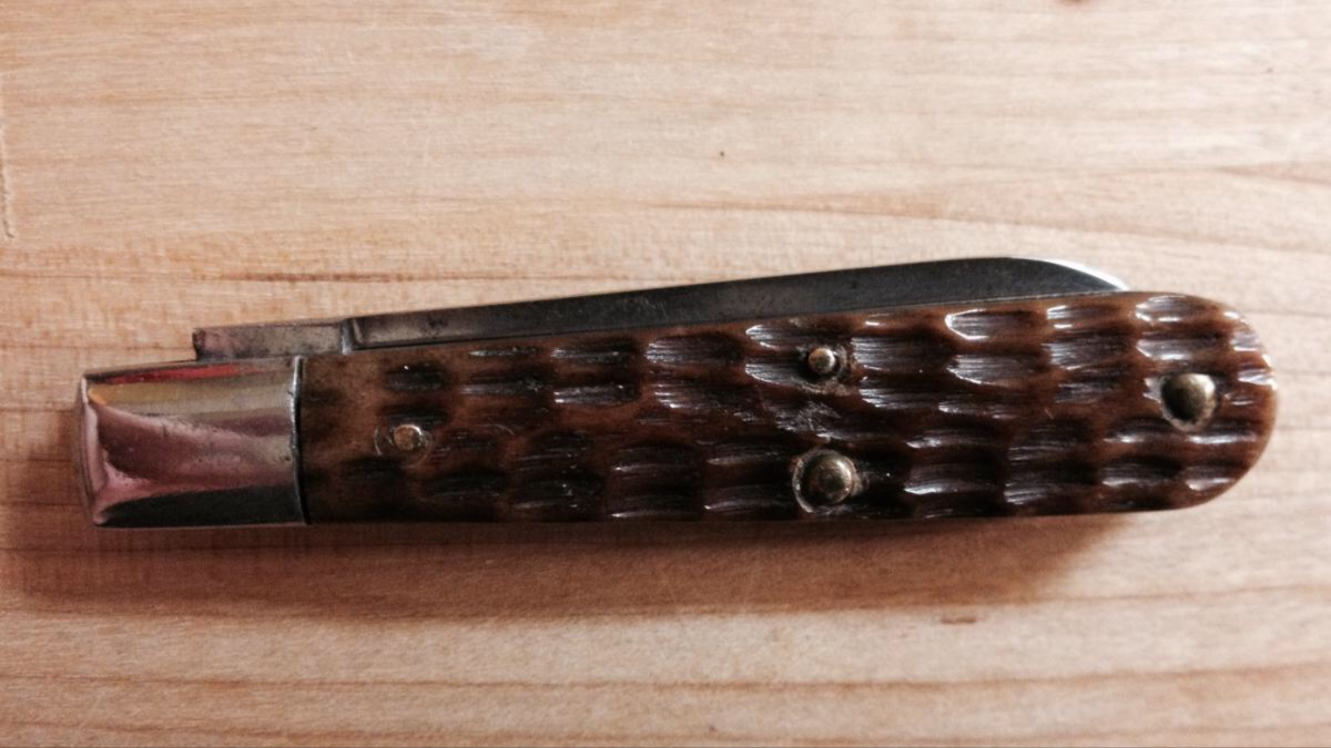

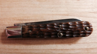

I was just getting ready to post this. At least the seller says he doesn't know if it's vintage or modern. Looks well made ,nice bone, possibly German made,is it made by the same company making those Herrick Hardware knives? I would think if someone saw 4 mint knives of the same pattern with rare tang stamps that would date it from 1930's (at least 2 of them) that it would raise a red flag as to them being vintage. I am curious to see the final bids.
Posts: 18937
Re: CASE $1 knife
I appreciate that piece of honesty. "UNKNOWN VINTAGE CASE TESTED ONE DOLLAR 1 BLADE FOLDING Knife". Pretty sure there has been much discussion on this site regarding these "Case" knives.
Mumbleypeg
Posts: 14724
Location: Republic of Texas
Re: CASE $1 knife
Post by Mumbleypeg »
Case never made $1 knife until Parker had one made around 1990. I’m not sure if that is one of them or not. Someone here, maybe knifeaholic, probably knows.

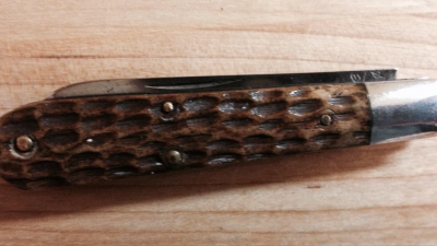

When I blow up the picture of the back spring on my phone, I think I see some 'chatter' marks from a belt sander.
I am no Case expert, but I suspect that the knife has been apart at least, and at most may be a cobbled counterfeit.

Reverand wrote: Thu Oct 01, 2020 1:05 am When I blow up the picture of the back spring on my phone, I think I see some 'chatter' marks from a belt sander.
My apologies if I am wrong in any if this.
[/quote
They were definitely not made by Case or for Case.

Total fake Case knife and bidding is up to $127.50 with ~ 36 hours to go. Why don't potential bidders do a little online research ?

I have never seen the Case word scripted like that before.

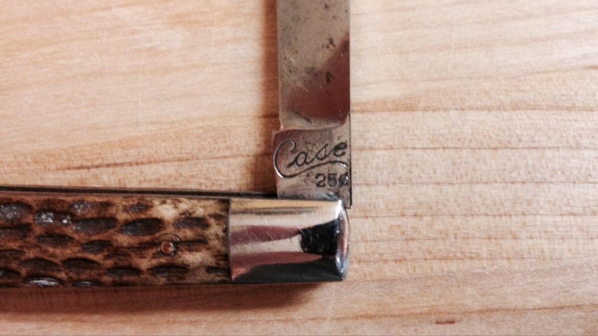

It is stamped that way on the real 25 cent knife.

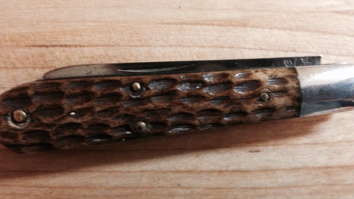

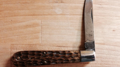

Does anyone have any of the real thing (Case) in your collection that you would share pics of??? Thanks!

What a real one looks like
jwwood wrote: Thu Oct 01, 2020 4:50 pm Does anyone have any of the real thing (Case) in your collection that you would share pics of??? Thanks!

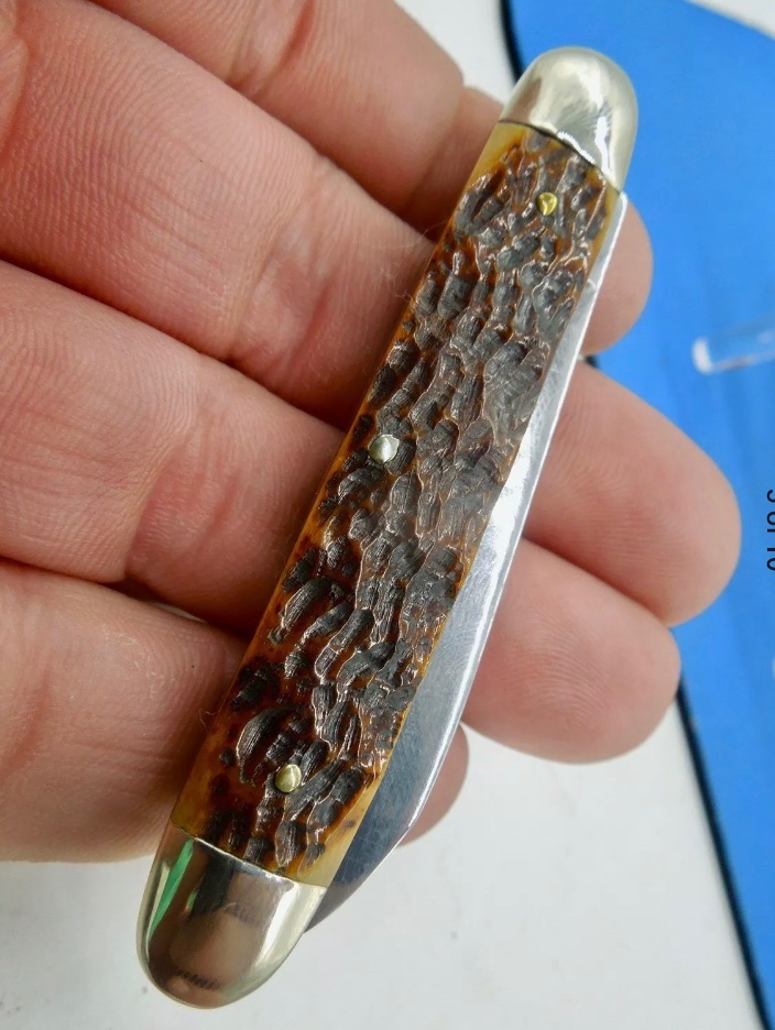

Thanks for posting that Mike. It should be noted that the real ones are a barehead jack. To best of my knowledge the one and only original legitimate version is a 25¢ version, barehead jack. The others - 50¢, 75¢, and $1, were not made by Case until Parker created them around 1990. Most of the fakes I have seen, like the example referenced in the OP, have two bolsters, that is, they’re capped.
Someone earlier in this thread asked about a 15¢ version. I believe that’s a unicorn - never existed. If someone has evidence to the contrary I’d be glad to see it.
