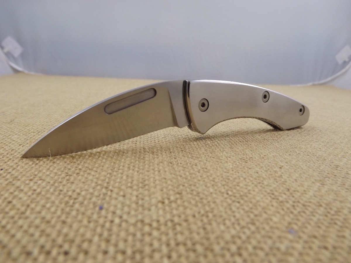

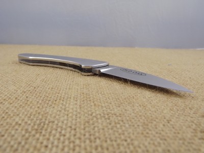

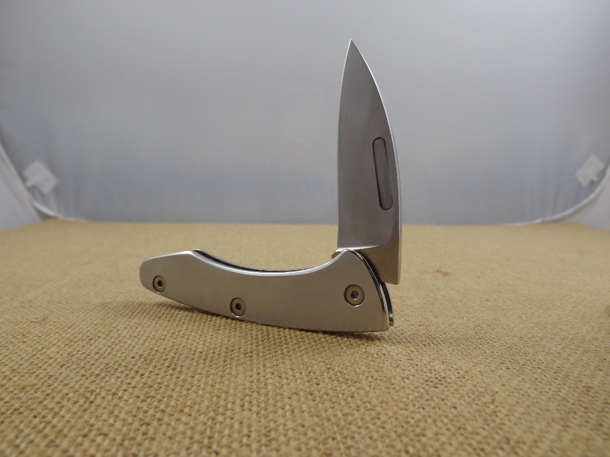

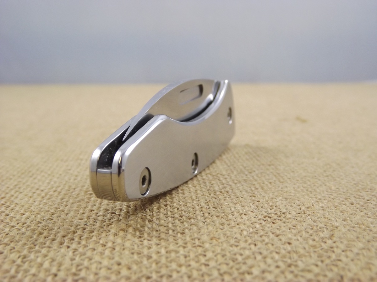

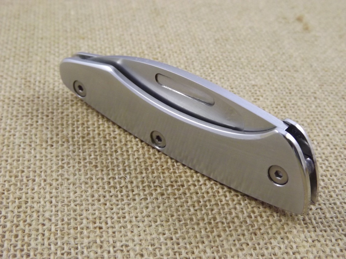

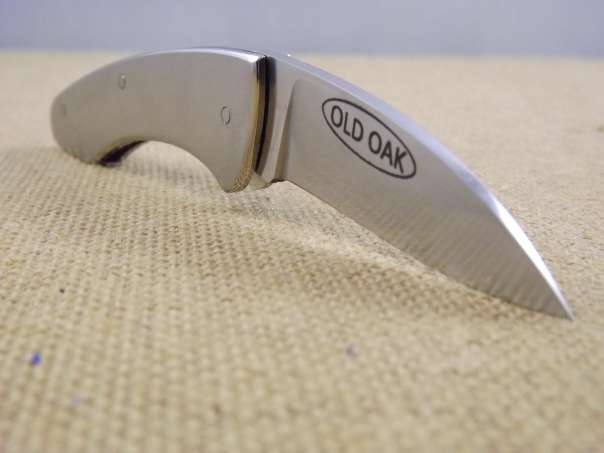

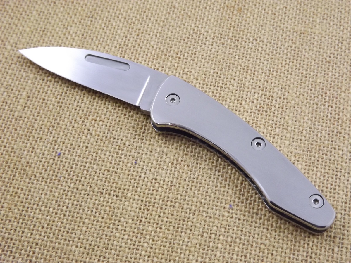

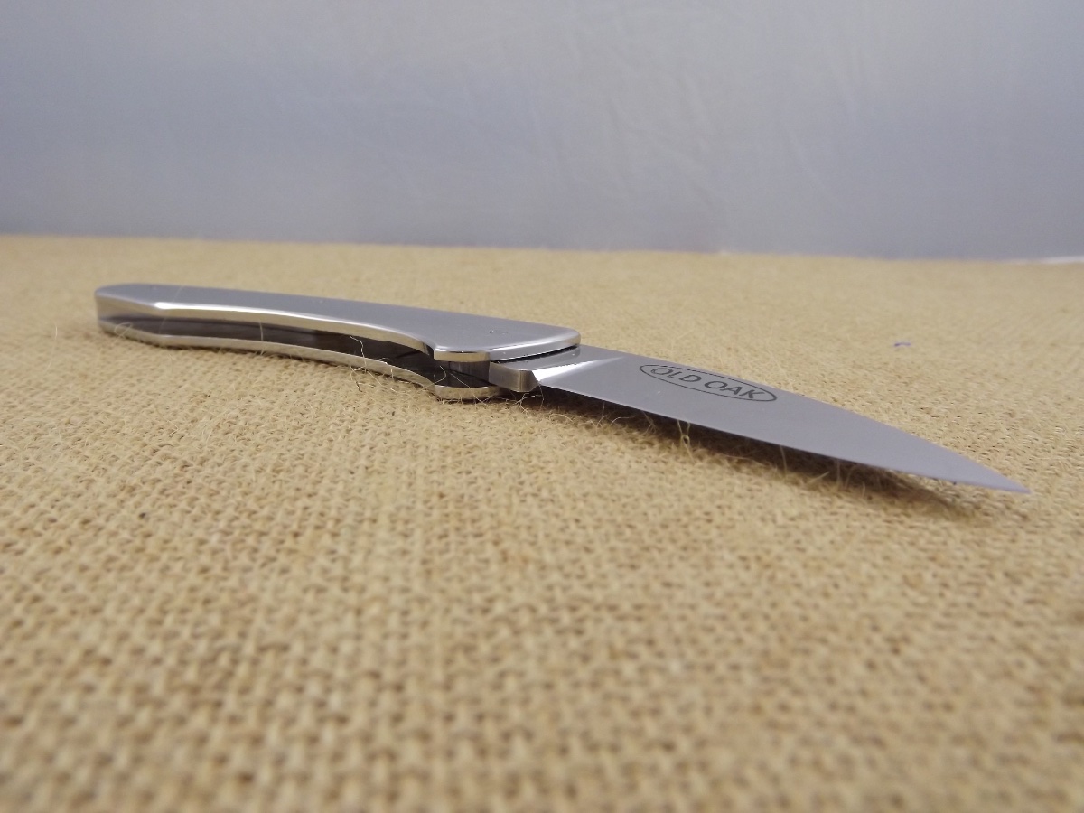

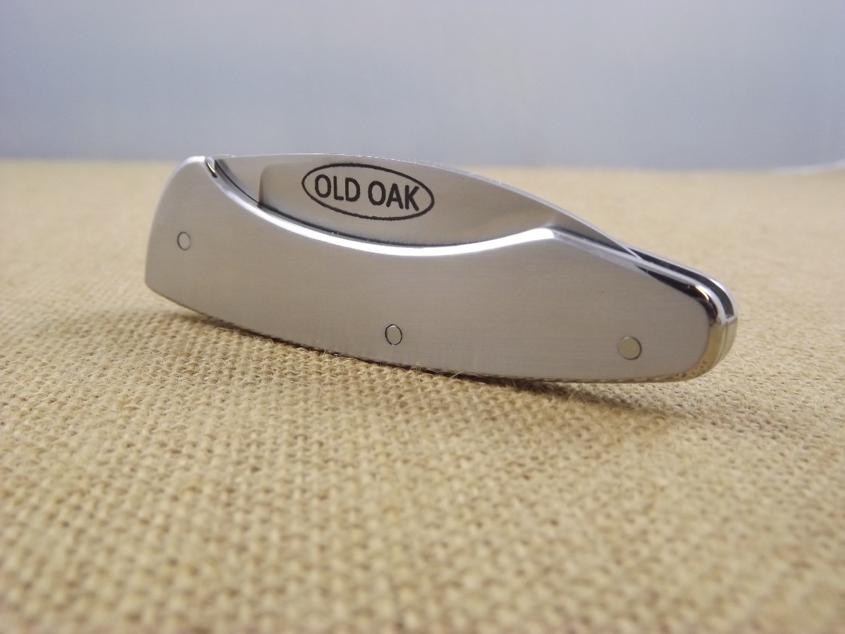

Macaw folder with stainless scales.
The blade is RWL34 steel heat treated and tempered to rc62 hardness. It is 3.2mm thick at the spine, with a flat grind with a 25deg secondary bevel and approx 68mm overall. The blade runs on a 6mm oilite bush. The backspring is also RWL34, heat treated and tempered to rc51.
Handle scales are 2.5mm 304 stainless, mill relieved at the pivot, with a brushed finish on the face and a polished edge, with jewelled interior. The countersunk hex screws are stainless.
Overall length open approx 158mm and closed 95mm.
The blade has a half-stop position and the spring is medium strength with a positive click into each position.
