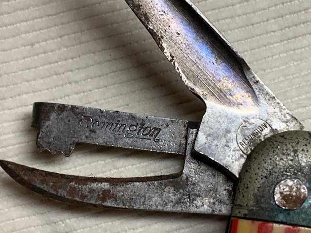

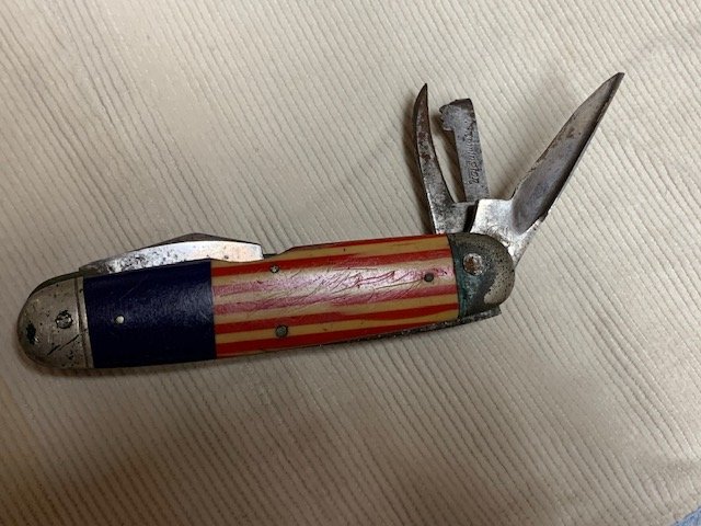

Thanks for the replies. The knife had already been apart, sorta. The main blade has been removed, so no tang. The hinge pins (thru the bolsters) were replaced with wire, peened on one end, crimped on the other. The only pin left is the center pin. That is the one I need to remove without damaging the scales. The handles are still attached to the liners- although one is loose on one end. The new pics I hope show better what is left. Thanks

You can use a Dremel with the thin cutting tool to cut right through that pin. A jewelers hacksaw will work as well. There is enough gap in there to get the blade started.
